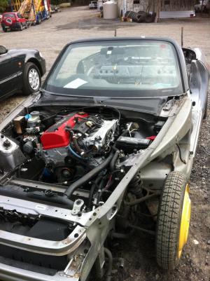

almost hav the engine out of the s2000. is alot harder then it looks. ive spent like 7 hours trying already and finnaly hav it to the point where its floating in the breeze. but can't pull it out the top cause it hits on the reo bar and can't drop it out the bottom with completly removing the sub frame. but since i don't want to grind anything off so i can still sell the shell ill hav to drop the subframe down and bolt it back up so it can roll agen
