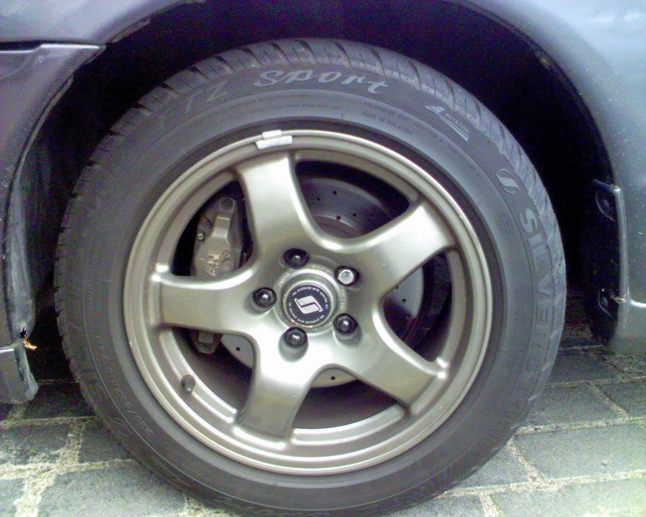

Yea all bolt up essentially. I'm already running R33 GTSt fronts which are similar calipers (the only difference being the 32 GTR calipers take a 2mm wider rotor). The rears are standard S13 currently so going from a single piston 280mm rotor to a twin piston 297mm rotor with drum handbrake. All up in the rear I'll have a net gain of weight (heavier rotor, lighter caliper, extra handbrake mechanism). Front might be a slight reduction over whats currently on there but still heavier than standard.
The goal is to have these brakes cope with the car for the foreseeable future. There's some R32 GTRs racing on standard calipers with good pads so I can't see me having any problems with a 500kg+ head start. The front calipers and rotors cost me $0 and the rear calipers cost me $0 I thought maybe I could throw some cash at jazzing them up a bit. Total cost for the brakes including the alloy pistons and reseal kit, new rear rotors, handbrake setup and new rear brake lines is around $1000 so far.
Ah thanks for that info on sizes. I've got r31 struts and brakes under the front of the 1600 and Datsport do a bracket kit(cheap) for the gts-t/gtr brakes. I'm thinking I could squeeze the gtr calipers inside a 15" rim which is good as that's what it's going to be engineered for.

It'll be a crazy tight fit on a 296mm rotor, they came under 16s from factory. The S14/15/Z32 cast iron and R32 alloy caliper takes a 280mm rotor and does fit under 15s so might be a better/easier option? Essentially the same setup, same piston size (40.4mm x 4), same pad (DB1170) just setup for a smaller rotor. Get the alloy version though, the cast iron ones add about 1.5kg per caliper!
This is a standard GTR rim + caliper (and even the nasty old cross drilled rotor).
Just to add to the last post, going for the bigger rotors wont necessarily decrease your stopping distance. The only real advantage is increased heat handling capability. That said, if you want a caliper to trial fit I could post you down a loaner when I pull my R33 GTSt calipers off Stu?
mitch-12: If I have to replace it or do a new loom I'm still not sure what I'll do. Motec crossed my mind though, had enough of dealing with half arsed ECUs, time to deal with the masters? I am bloody pissed off that Haltech don't appear to want to support a product that they only stopped producing a couple of years ago. A friend sent an E11 (IIRC) down to be diagnosed, it came back with some extra weight reduction and a note saying to buy a new platinum series. Needless to say, that cars now running a different brand of ECU.
Thanks for the offer i have a r33 gts-t setup in the shed, was just thinking if the gtr setup a mate has for sale might be worth it. This post was very welcome as dad is sick of spending money and just wants it done. Bearing in mind its only 980(ish)kgs the r31 stuff i have in it with qfm`s fitted should be good enough.
