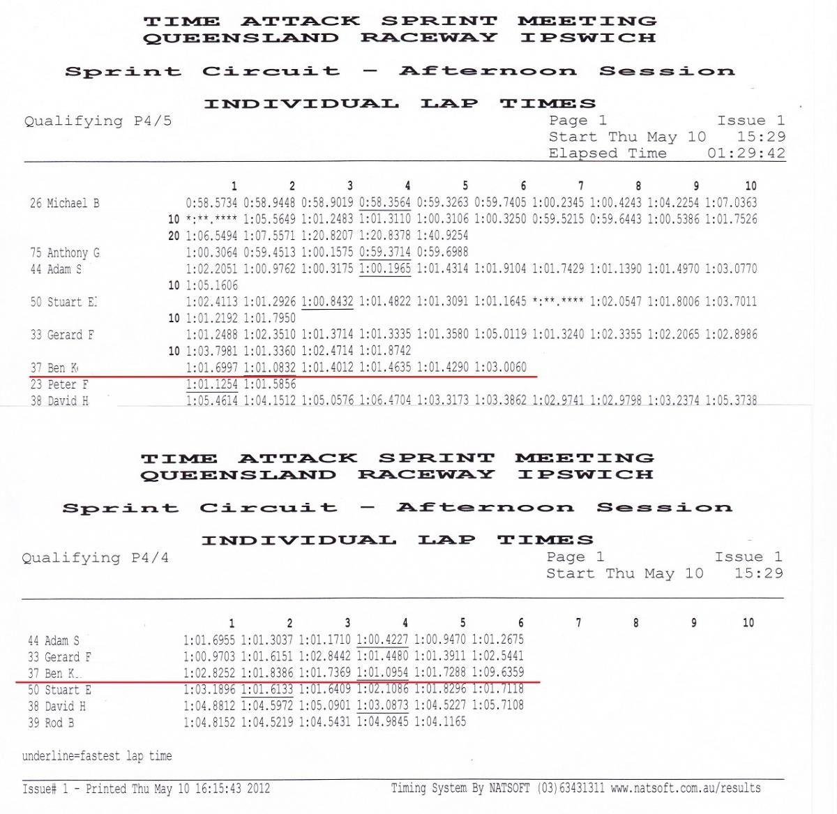

Lap times once I figured out how to drive the car again:

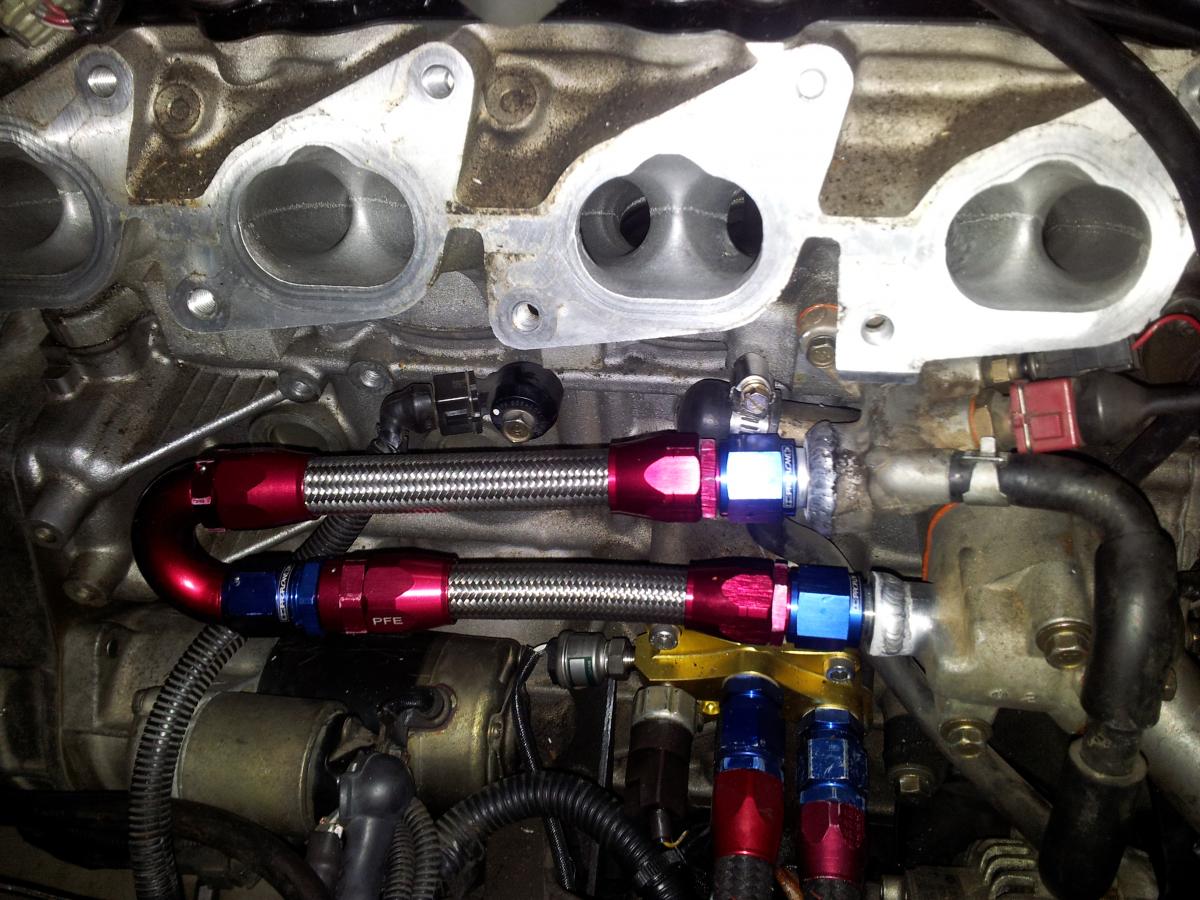

Replaced the thermostat bypass with braided lines because the hardlines have been corroding and leaking. Turbo coolant lines are now the S14/15 style setup so no more retarded around-the-back lines. Gets some hardcore thermosyphon through the turbo when you shut the engine off.
Recirc lines. Not pretty but it's all covered by the manifold. They look excessively long and drooping but that's just because of the angle of the fittings. They don't droop at all and the length is necessary for the lines to comfortably bend in to the right positions. Bottom lines weren't done by me and they only look like shit because they've been reused from a previous iteration of the oil system. The rubber stopper is unfortunate but when I have the engine out next I'll have that line welded up (difficult to get out when the engines in).

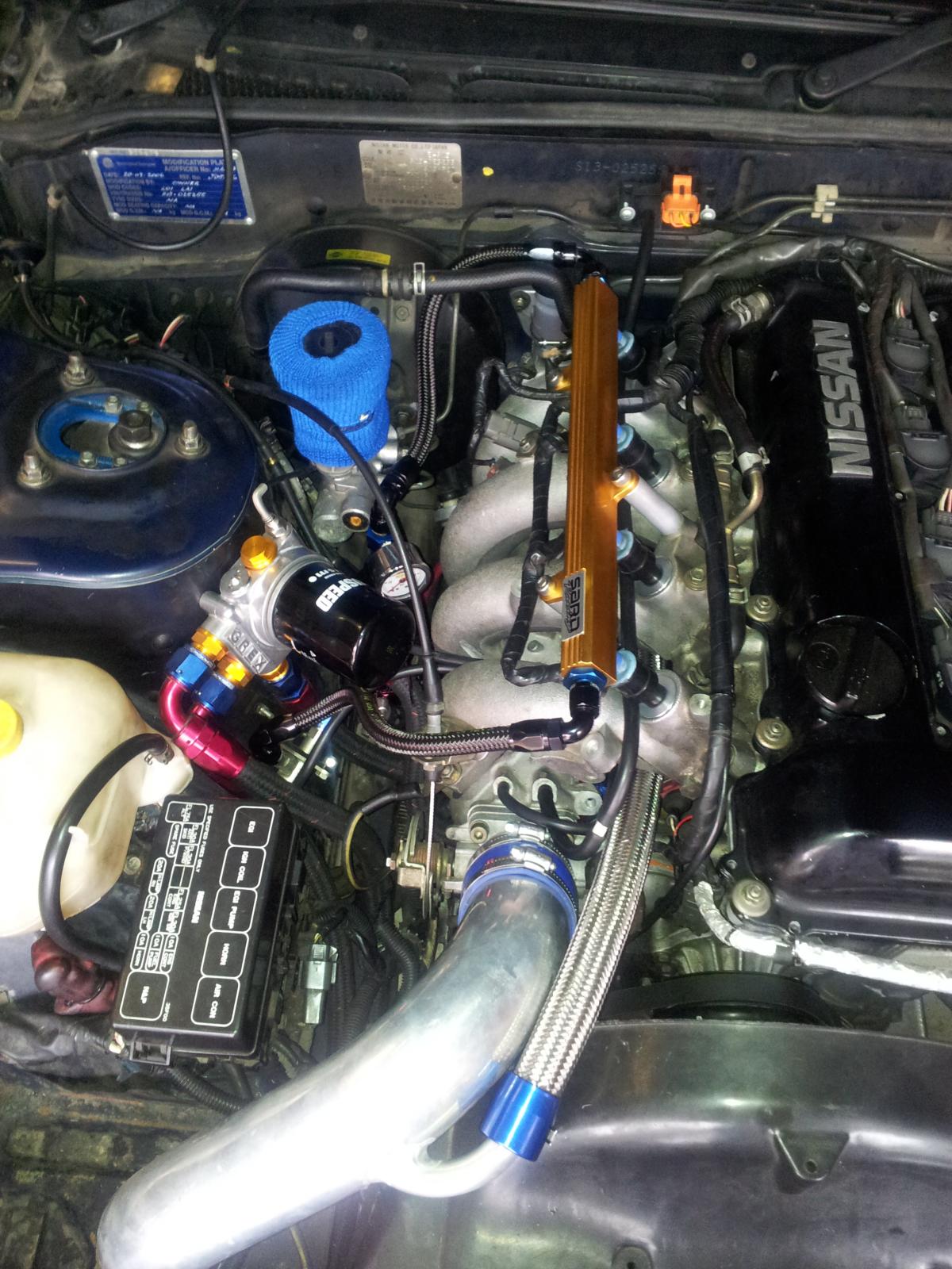

Updated my fuel delivery too as the rubber lines had started to perish. Now have braided off the hardline into an Aeroquip fuel filter into a tee with a fuel pressure gauge into black Nomex braided lines to and from the SARD fuel rail. I'll see if I can wheel the car out and get a photo of the fuel system.
Had some spare -16 stainless braid hose that I didn't end up using so replaced the IAV line with that with a spare clamp dress fitting while I had the manifold apart.
Probably the last hoses in the engine bay that I could change over to braided is the catch can lines. Everything else that can be changed over, is.
