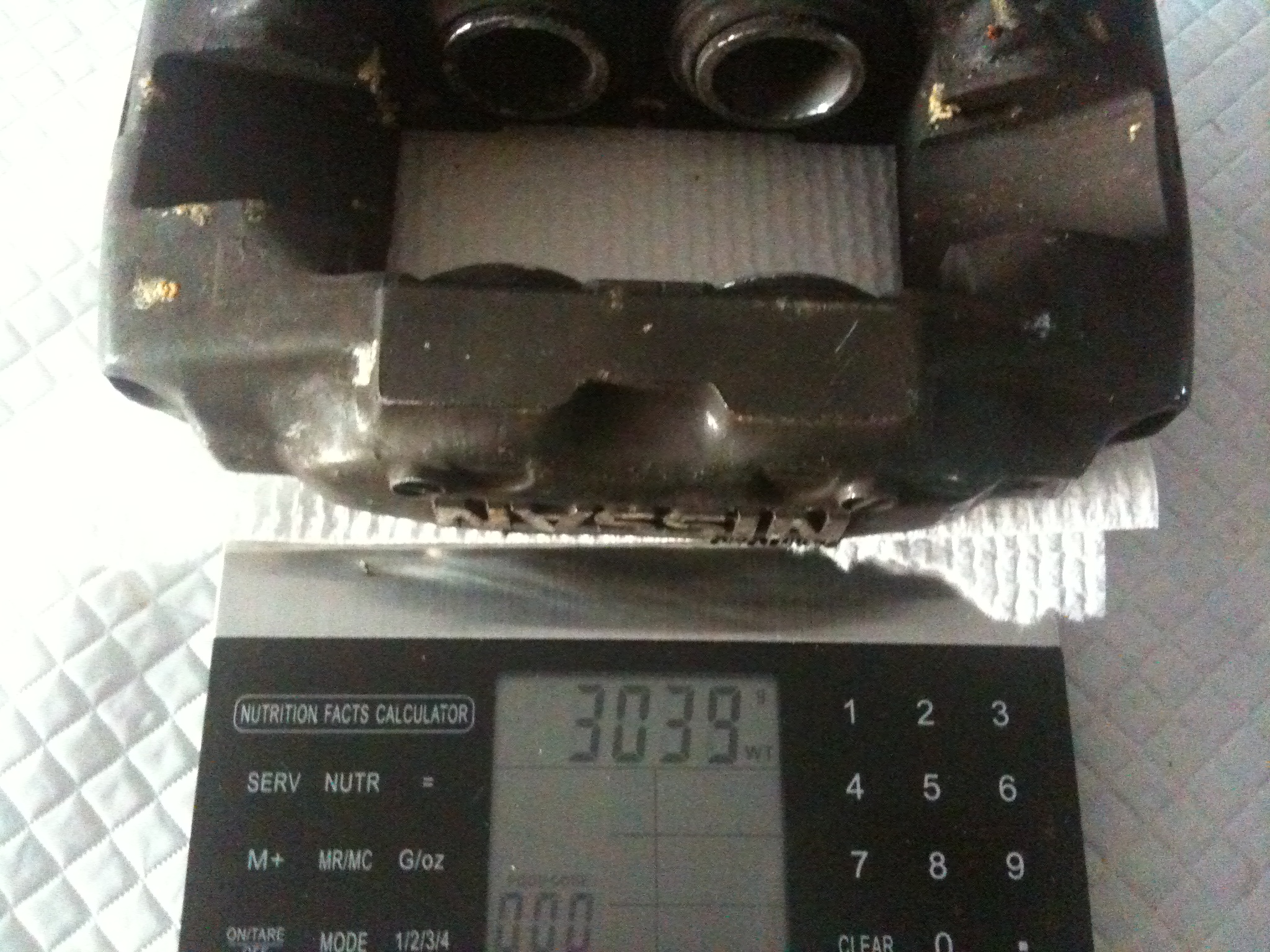

Finished rebuilding one of the fronts this afternoon. Decided not to paint them as the original paint is still in good condition. They desperately needed a rebuild. Pistons were rather stiff in the bore. I had to remove each piston individually, grease it up and put it back in the caliper before I could get all of the pistons far enough out to pull out. There's also what looks like molten bits Ferodo DS2500 stuck to the calipers at the bottom. Might go some way to explaining why they struggled to pull up a 1600kg GTR before brushing the tyre wall at Lakeside (also explains why these calipers are no longer attached to that car).
Snuck back into the kitchen while no one was looking for some weights.
Stock R32 GTR caliper.
And with alloy pistons.
Trying to find some weights on the GTR Brembos to see how they compare.
I'm quite enjoying rebuilding calipers, I'm a little bit sad I've only got one left to go. Need to go grab some more brake cleaner though.
