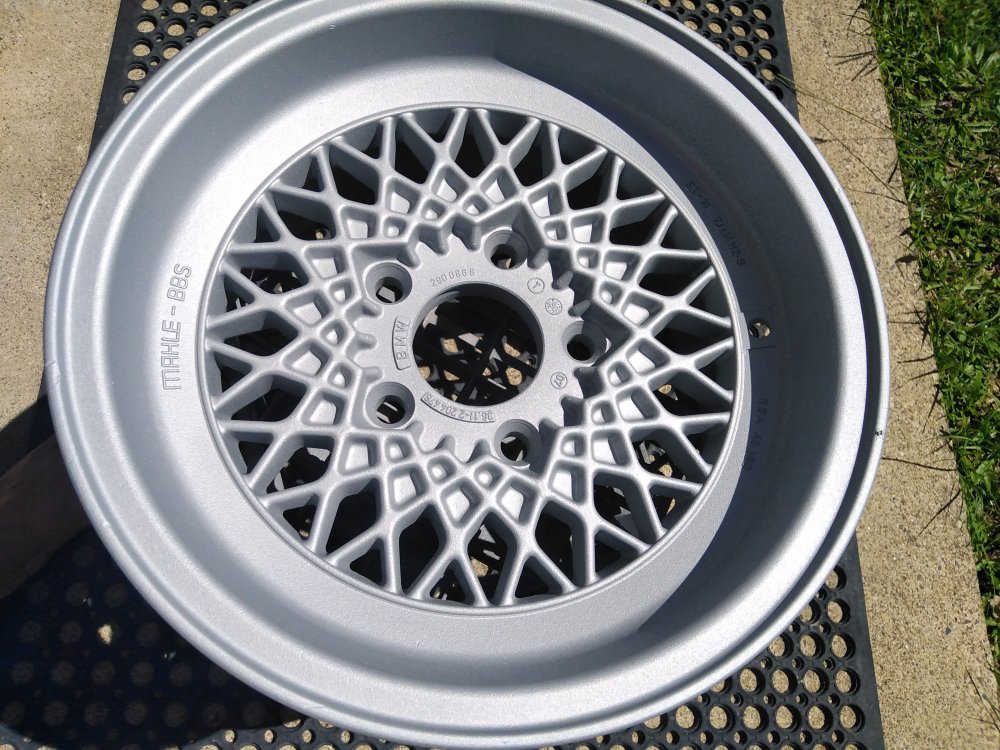

Been restoring some old bmw BBS Mahle 14x7 +11 factory upgrade wheels.  Got em looking quite good now.  Might have to strip and resto my ssr fins soon.  I think Ill leave the outersalone but I would like to paint the centres up in the silver.  I used fergen silber 144 from glasurits bmw range.  Apparently its what a lot of vintage bbs wheels were painted late 70s early 80s.
Before Restore:
After stripping and etch priming with ppg/protec etch primer.
After surfacer and mettallic top coat.
