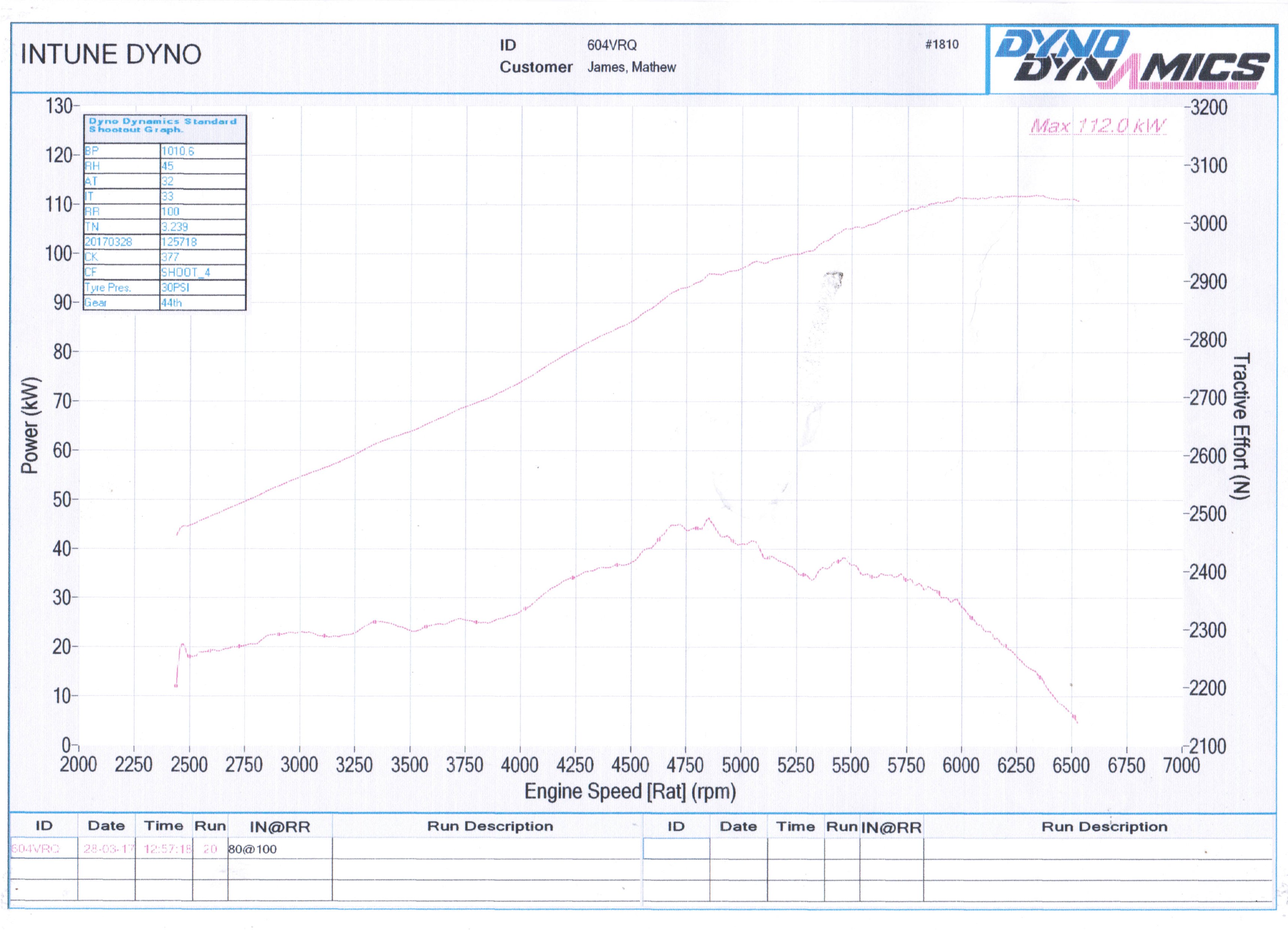

Changed diff oil this morning, ready for the tune at 10:30am.
Pretty keen to see what happens.  I will get a run done with no changes first as a baseline and as a comparison to the old tune since I have changed essentially everything from tuning modes on up since that time, and I'm sure its better to drive.
What a cool way to spend a day.
The tune went well.  Final number was 112kw @6300.  A much higher peak than before and at a higher rpm.  It still made power all the way to 6500 with no taper off.  Compared to a stock engine and manifolds that makes 118kw at the flywheel, my setup makes the peak power almost 1000 rpm higher with no camshafts!  The joy of ITBs.
Torque is strong everywhere now.   I was really rich up top and it was over advanced significantly, but the motor seemed to take it, it seems to be a pretty tough thing, plus I did very little driving at high revs to really stress it thankfully.
We tuned with and without socks so I have a 6kw incentive to make the airbox.
Drove it home on open loop, it was very fast, especially high speed from on ramp to overtake, my god.  To put it into perspective it makes the original 4ac engines 54 flywheel kw, at the wheels, at only 2900rpm.
Hers a video of the dyno run that made 112kw.
And the sheet.

I made a few tuning improvements.  I got closed loop fuel and idle control working well, changed some targets and expanded the control range of closed loop fuel control, which worked well.  I reduced the zero throttle fuel down to very little and shut off the crackle off throttle.  tweaked overrun settings and drove home in a smoother car.
