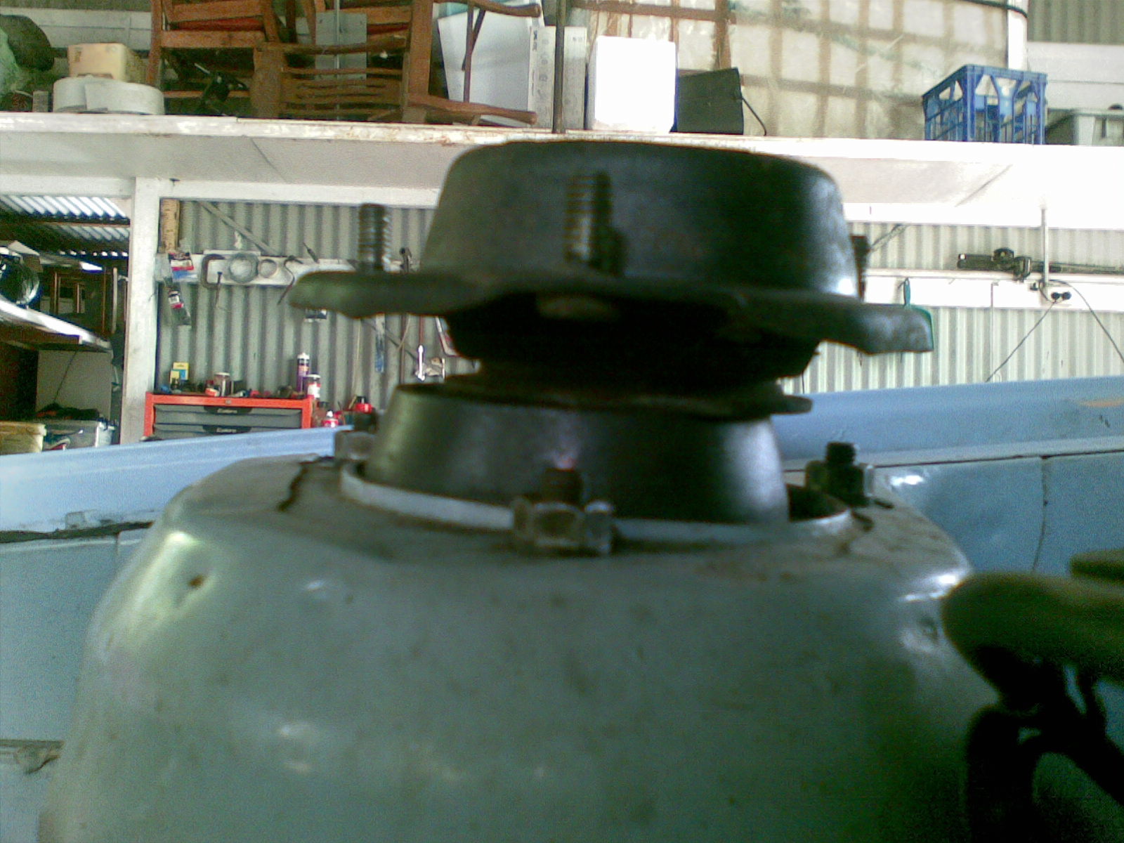

Okay I did some research, it turns out you are right Luke. The AE86 strut top bolt pattern is the same as KE70, but the AE86 strut tops push the shock shaft forward and reduces caster, whereas using the KE70 strut top pushes the shock shaft back and adds caster.
I thought I had noticed the AE86 strut tops in an AE86 sat to the rear of the strut tower, and this is what gave me the idea that they are a different strut pattern, as AE86 strut tops sit towards the front of the strut tower in a KE70. But it turns out that AE86 strut tops also sit towards the front of the strut tower in an AE86 as well.
Either way when I swap the AE86 camber plates from left to right and re-drill the inner holes in the KE70 strut tower I will end up increasing the caster, which is good. OR I could take the bolts and lower plate out of the upper plate in the AE86 camber plate and flip the upper plate over than bolt it all back together, and this would have the same effect(I think? See the last pic for a reference).
This is an AE86 strut top in my blue KE70
Notice the shock shaft is positioned more towards the front of the car.

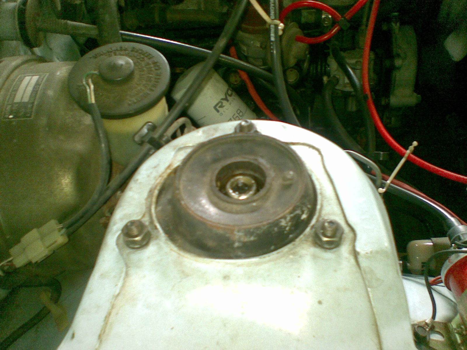

This is a standard KE70 strut top sitting on top of an AE86 strut top in a KE70:
The bolts between the strut top are lined up as best as I could, and you can see that the Ke70 strut top would position the shock shaft further back.

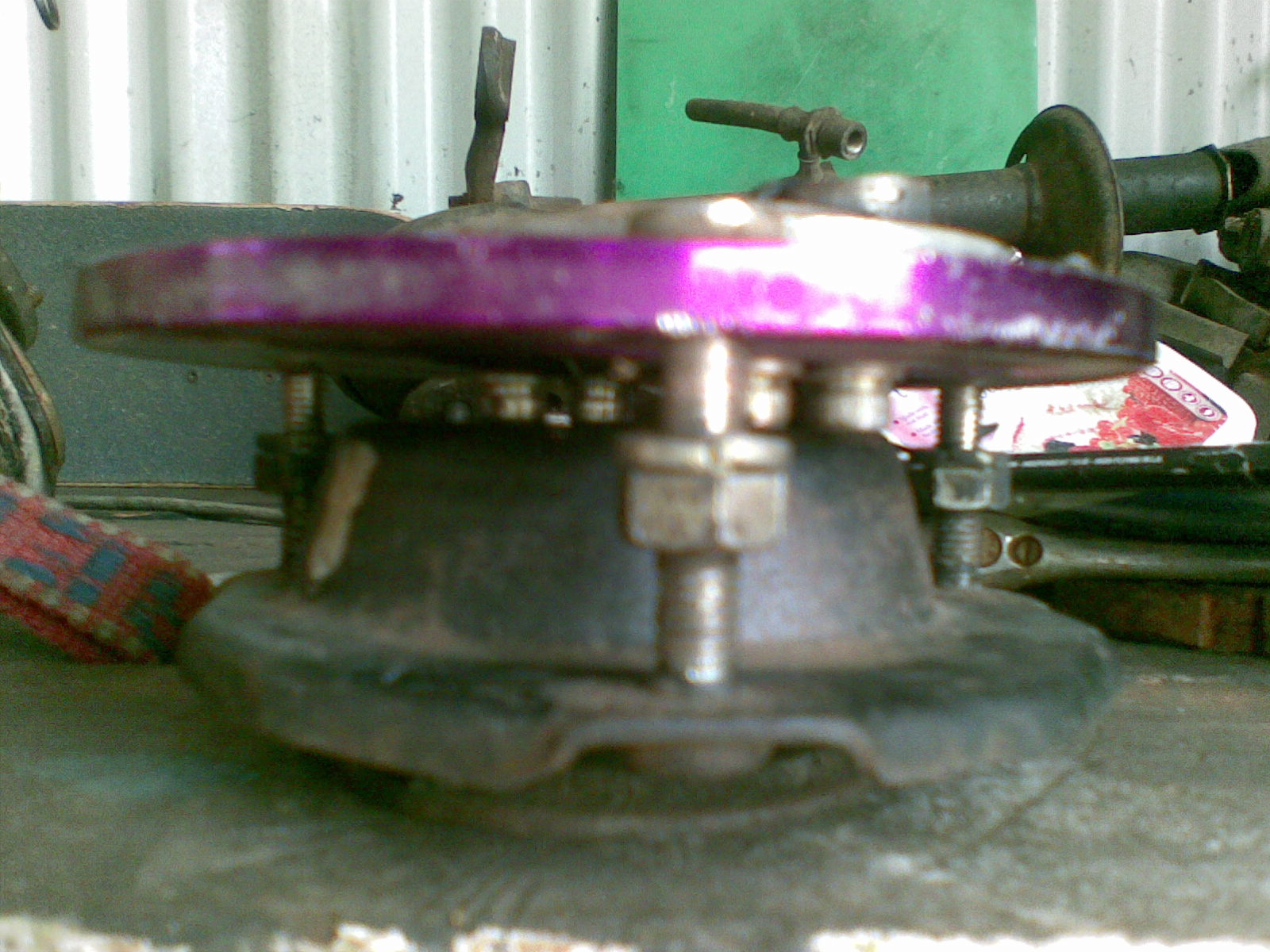

And this is what gave me the idea that they were flipped, this is a right side AE86 camber plate upside down on top of a left side KE70 strut top. Notice the bolts line up perfectly, the nuts are actually locking both the bolts from the camber plate and strut top together.

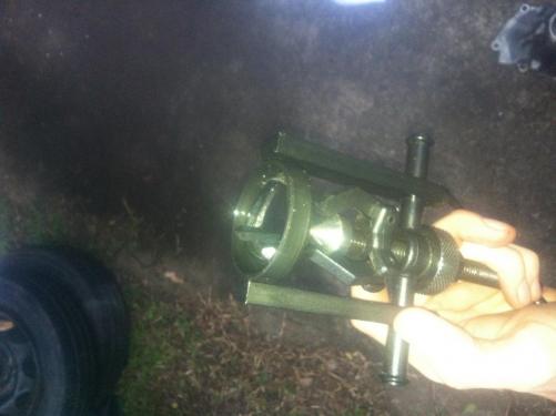

So I brought the coilovers back to my parents house to get them apart, I still need this tool to get the gland nut out:
Then I will take some measurements and see what insert I can use in the strut.
