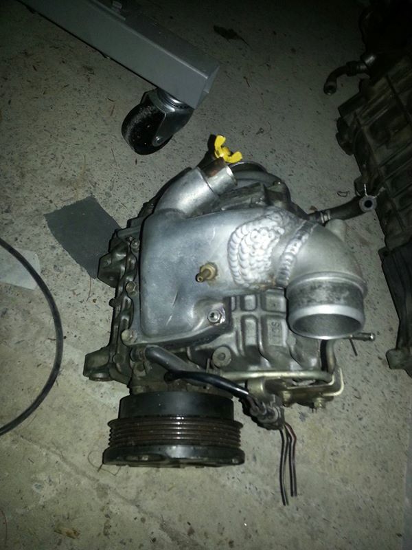

Hey Reed, what oil did you use in the supercharger?
Oh, I swear I read on the previous page that you changed it haha
That inlet pipe is dope!
175mm Nevo pulley with undersize tensioner, plus that outlet pipe Rian likes has a fitting to hook the ABV to. This will hold the ABV shut better, increasing boost.
