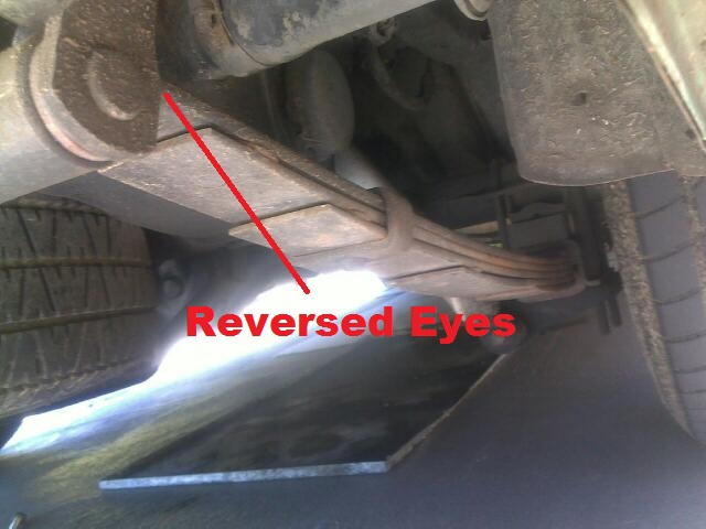

Factory leaves have the eye above the main leaf. Reversed eyes move the eye to the bottom side of the main leaf. Lowers the height without losing the camber out of the spring pack.

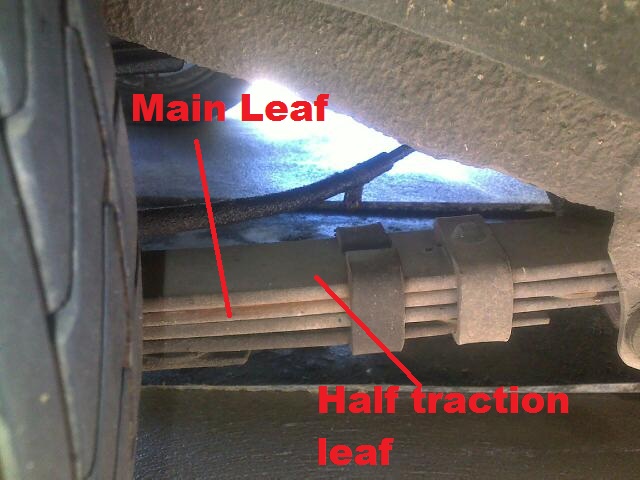

You can have a really basic 2 link rear end whilst keeping a completely factory floorpan.
If you stiffen the FRONT half of the leaf pack (reduces tramp) This effectively turns it into a 2 link.
Where the front half of the leaf pack is an improvised control arm and the rear half of the spring pack becomes the "spring"

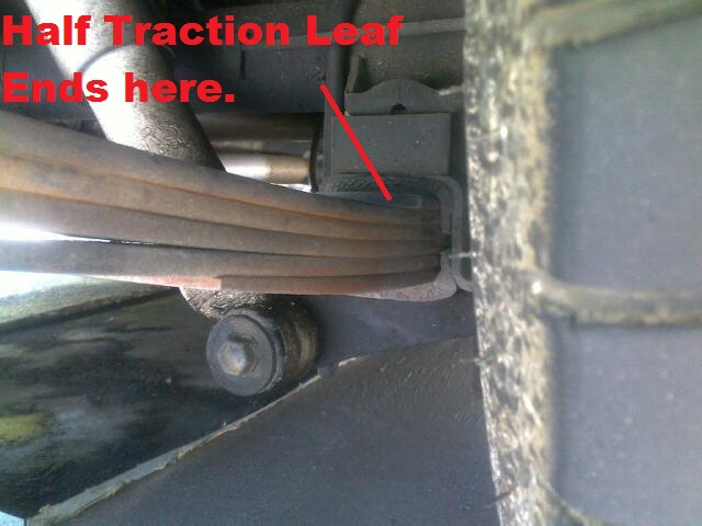

I can supply the same leaf pack as mine. To your height specs.
Its all perfectly legal. Just another leaf that extends from the front eye and ends at the back of the diff mount.

If you can work out how much lower than stock it is. We can go from there.
Making a set wouldn't be too hard. Just the front of the half traction leaf needs to be clamped tight to the front of the leaf pack.
