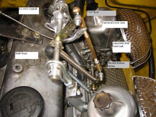

Yeah i have twin 1 1/2 inch SU's and i have never hit more than 8 grand. Also i must have scored the bargain of the century when i got two hand polished dellortos on a k motor manifold for 500 bucks with all linkages.
You don't wont to sell those dellortos on the k manifold do you with all the linkages.
