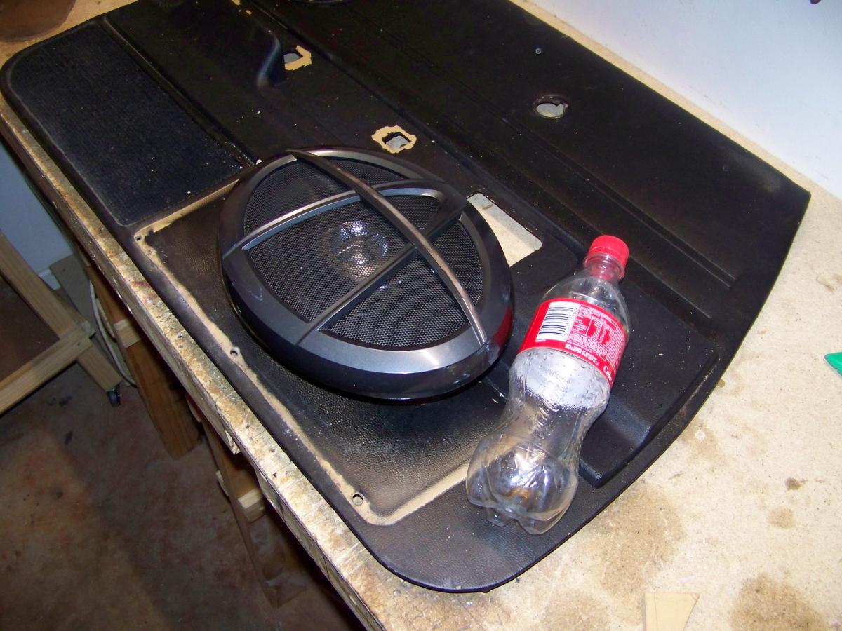

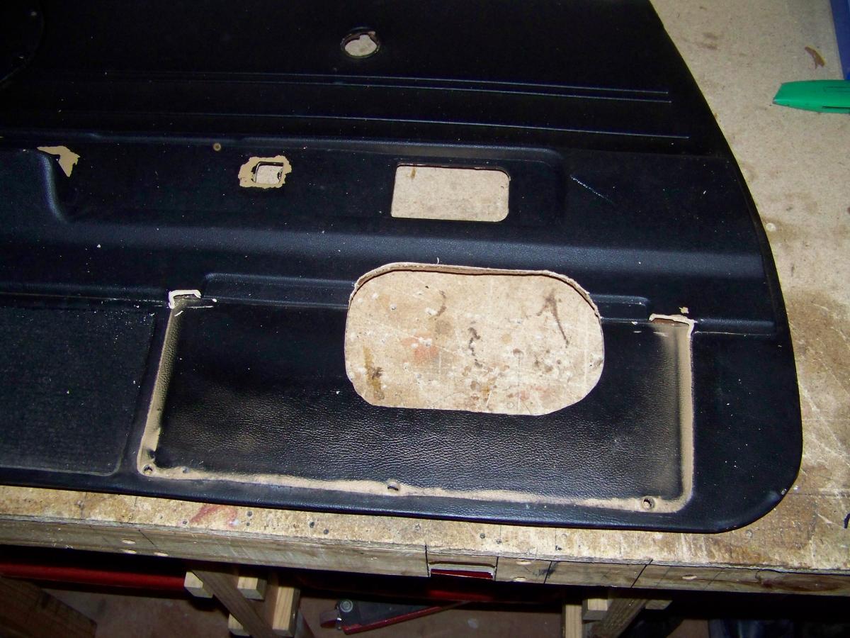

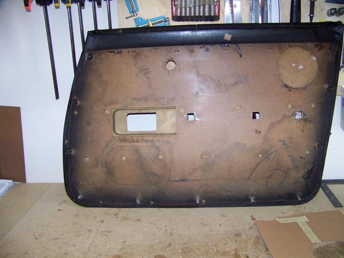

After making up a template of the door where the speakers magnet is going. I traced it onto the back of the trim.
I cut open the trim and removed the door pocket for the speaker.
Sitting the speaker in the hole, i noticed there's enough room in front for a drink holder.

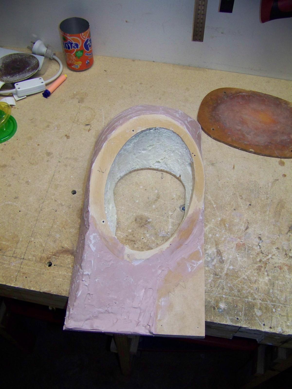

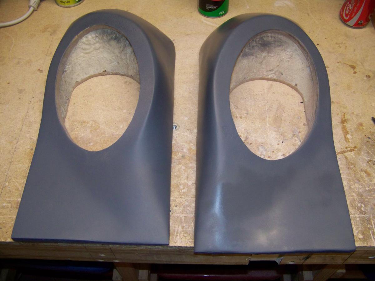

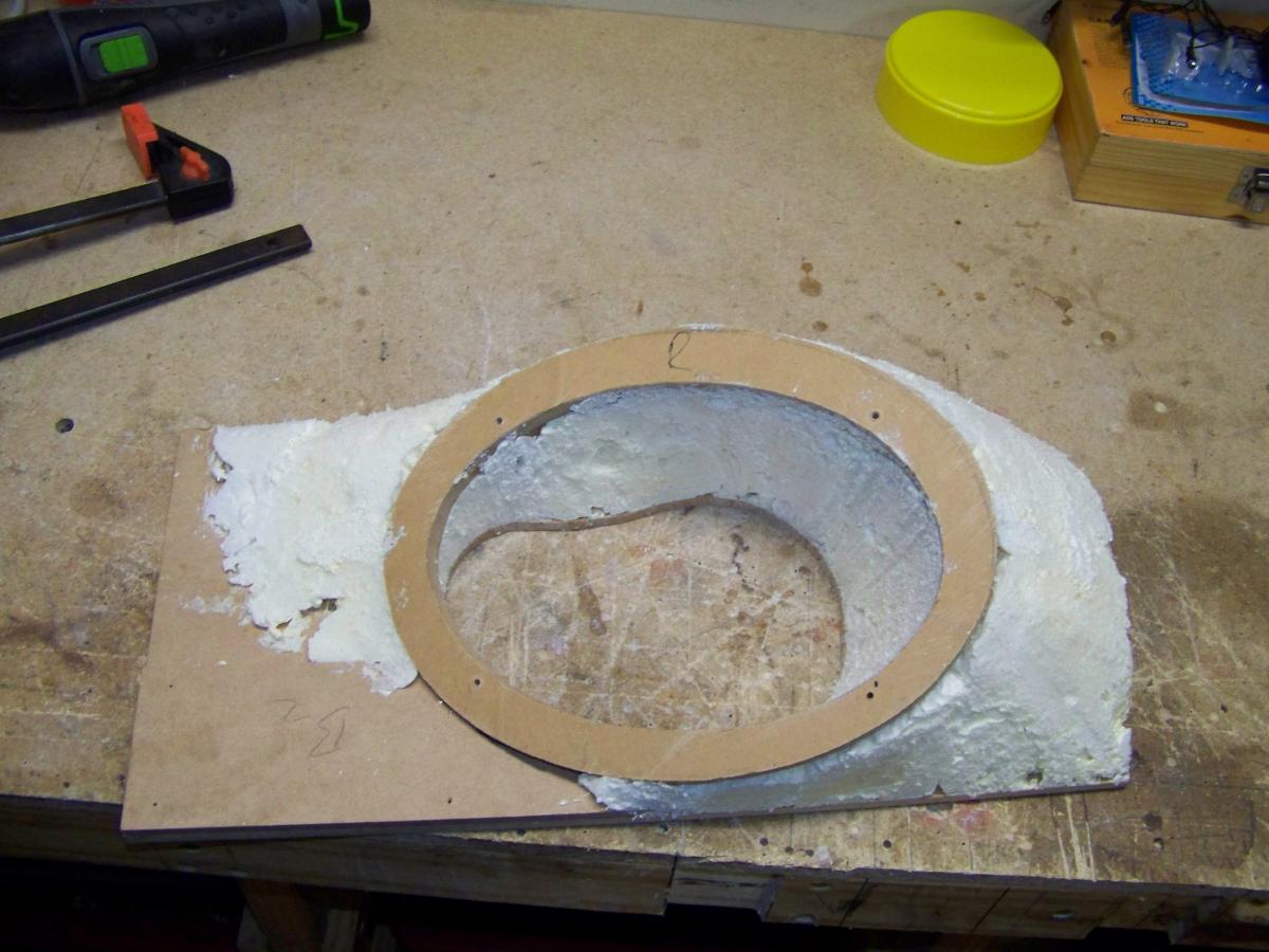

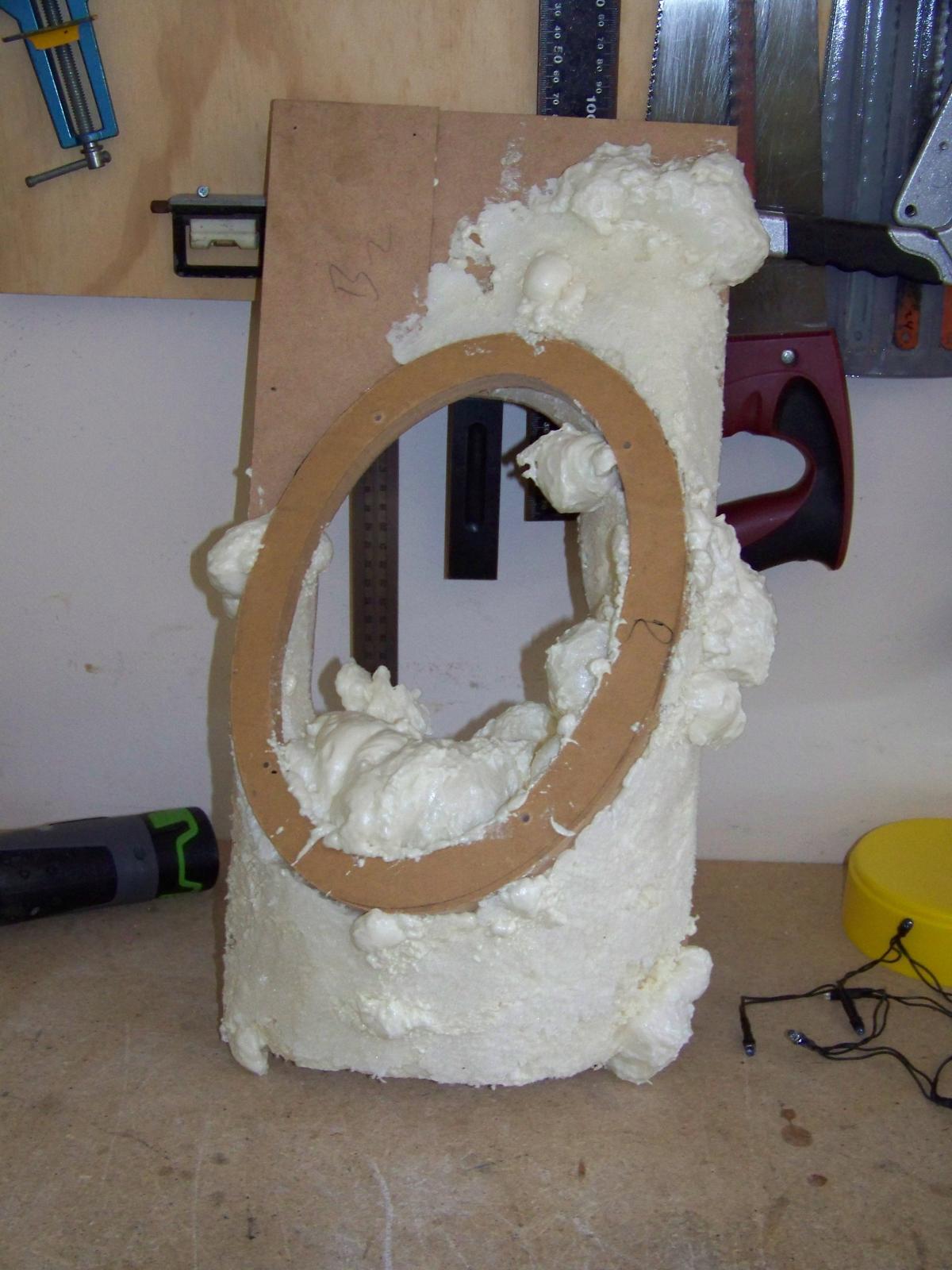

Yep been a right royal slacker with the updates. Been getting carried away with working on the front speaker pods of late and forgetting to take photos of the work.
What the lefthand pod looks like
And since i forgot a before shot.
This is what the righthand pod looked like.

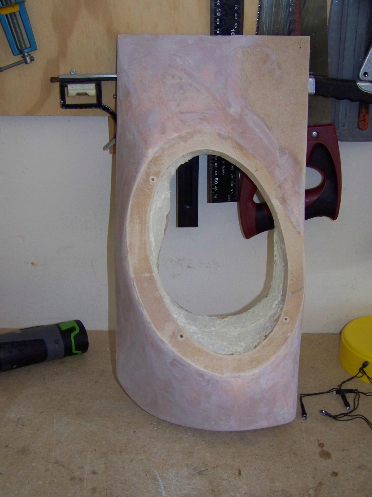

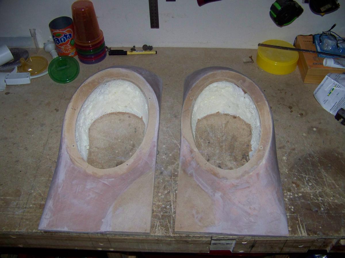

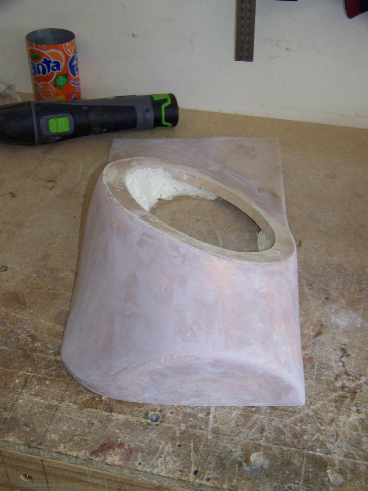

After a bit of shaping with a handsaw and a hacksaw blade.

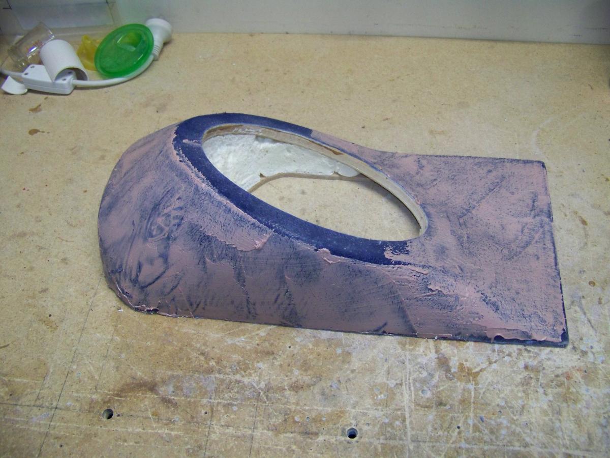

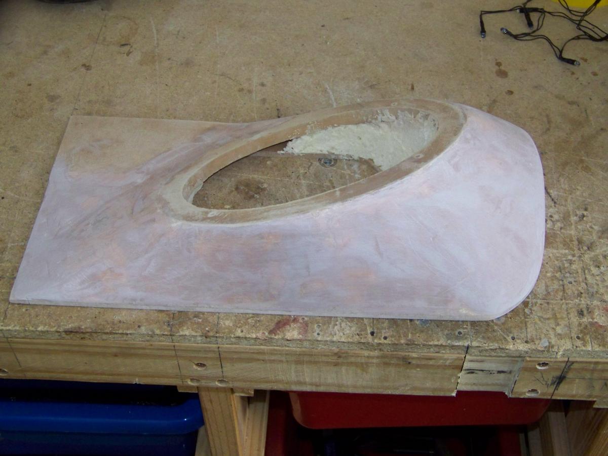

And where i'm at now is working on the body filler.
your going to have a lineup of people wanting work done on their cars soon with the quality of your work
agreed Trev, these were made from scratch..!
and what i love is, they are so dammn light, yet strong as

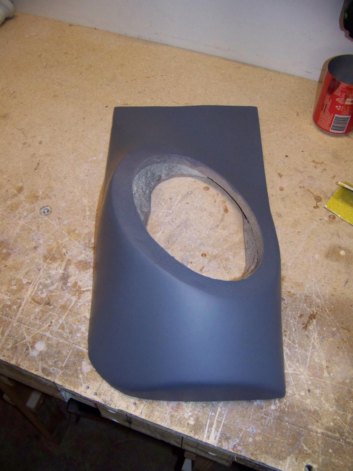

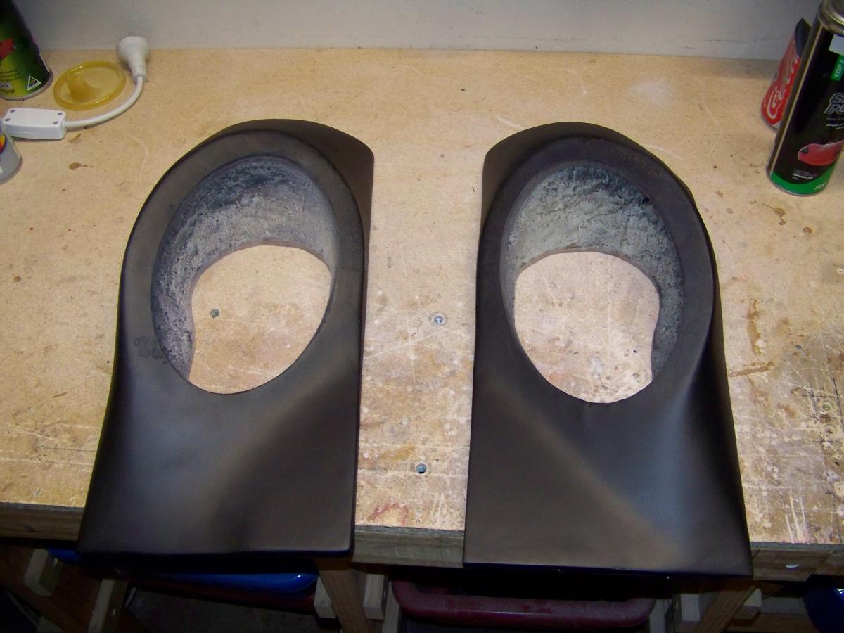

Done
Well kinda.

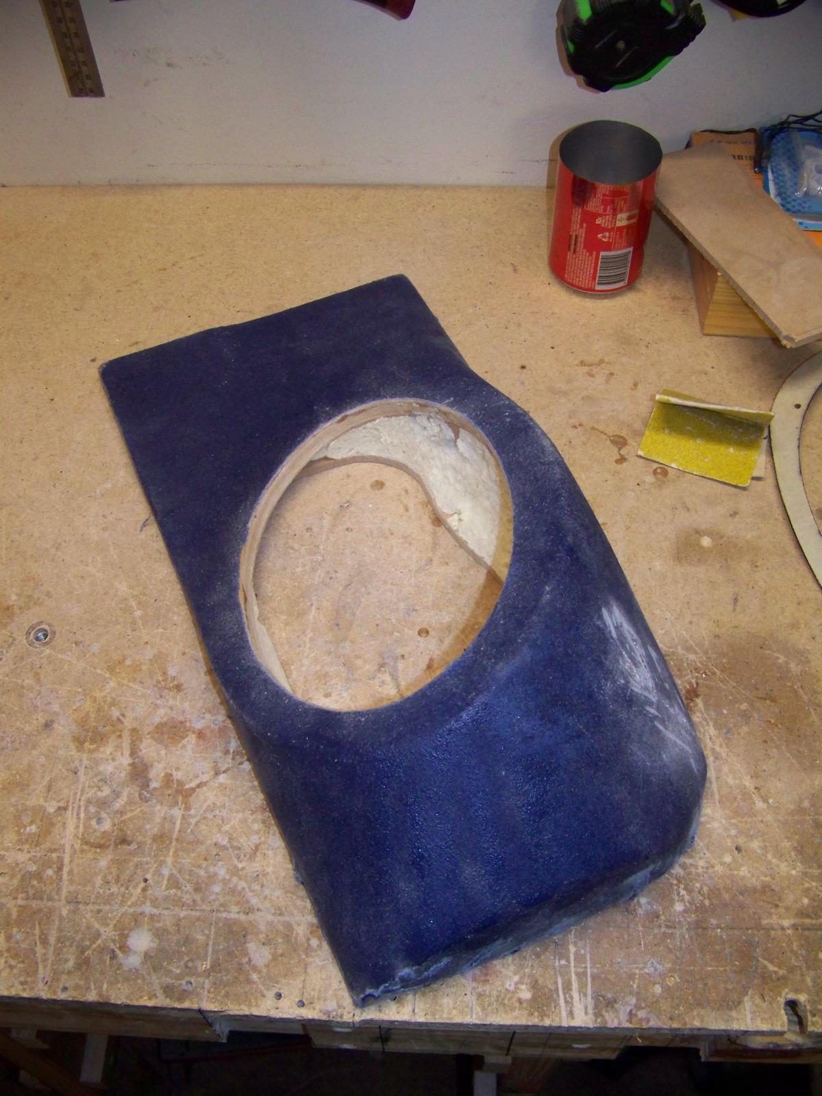

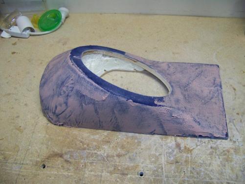

Just have to give them coat of fibreglass and paint them - at the moment i'm not going to carpet them or some other material, just a couple of layers of paint.
And then i can move onto the next job.
So thats just your typical builders expanding foam?
I'm not giving away any secrets ;)
Yep, it sure is. But you have to cover it with body filler before laying down the fibreglass, otherwise the resin will just soak into and soften the foam.
I wouldn't recommend just the body filler on its own. Its got some strength but i have crushed in the filler a few times. I don't know if using the fibre filler (metal mend or whatever its called) would be stronger or not.
fiberfill has fiberglass strands through it so it will be a slightly stronger than just normal "bog"
I used it to fix my front lip, tough as. Bitch to sand though.
fiberglass always is hard to sand

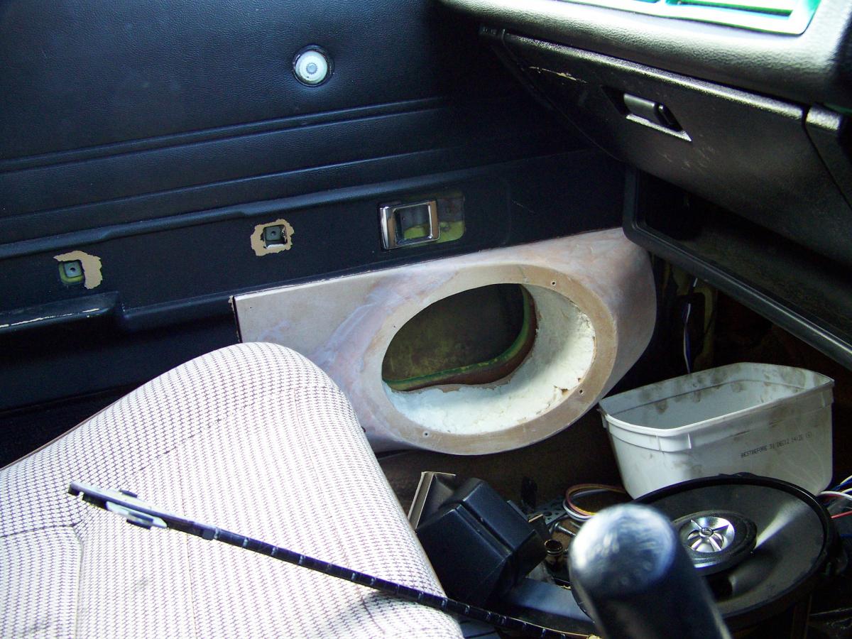

Left hand door pod is mounted onto the trim, just have to clean it up a little. Fit the door lock solenoid, run all the wiring in the door and refit the door trim and thats the end of that door. And on to the fit and finish of the drivers door...
