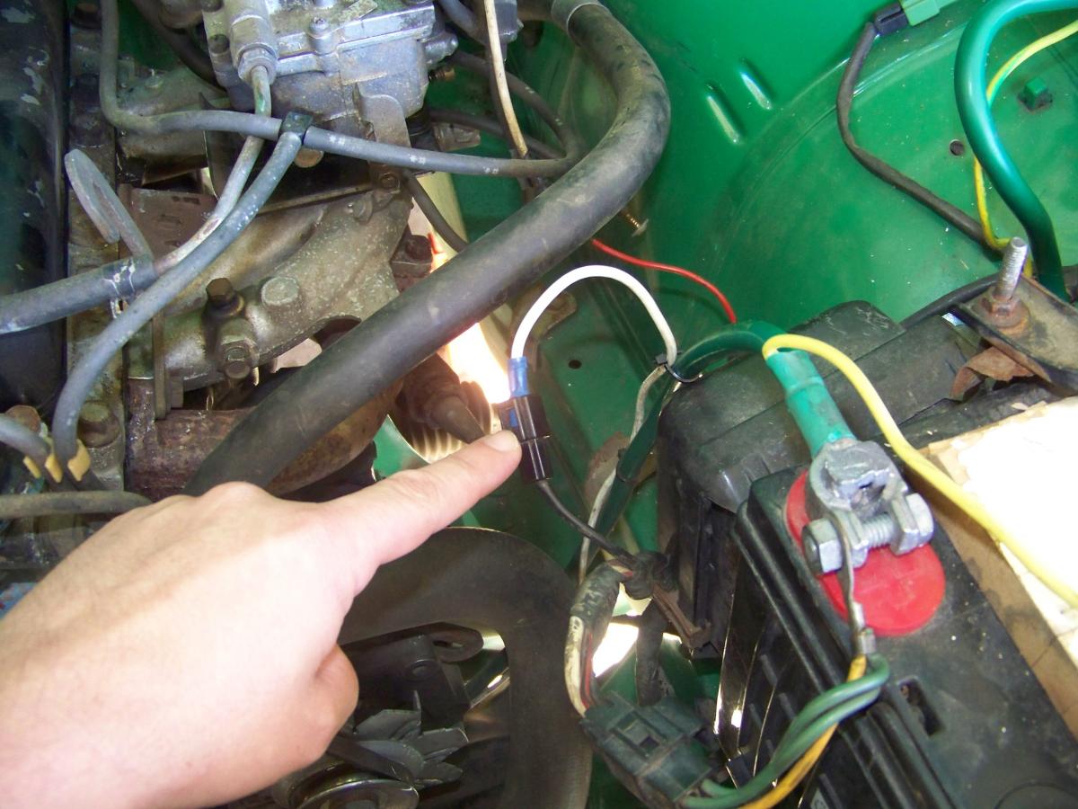

Redid the start/ignition wiring it was giving me the shuts on how i had to start the thing.
Sequence of how to start the car.
  1. Turn the key to ignition for the fuel pump and ignition.
  2. Flip on the switch for the electric fan.
  3. Push the start button.
  4. Turn the fan off.
So i pulled half the dash out to figure out the wiring mess was going to rip the manifolds off to figure out what went where.
All that had to be done was hook the white wire up to that connection.

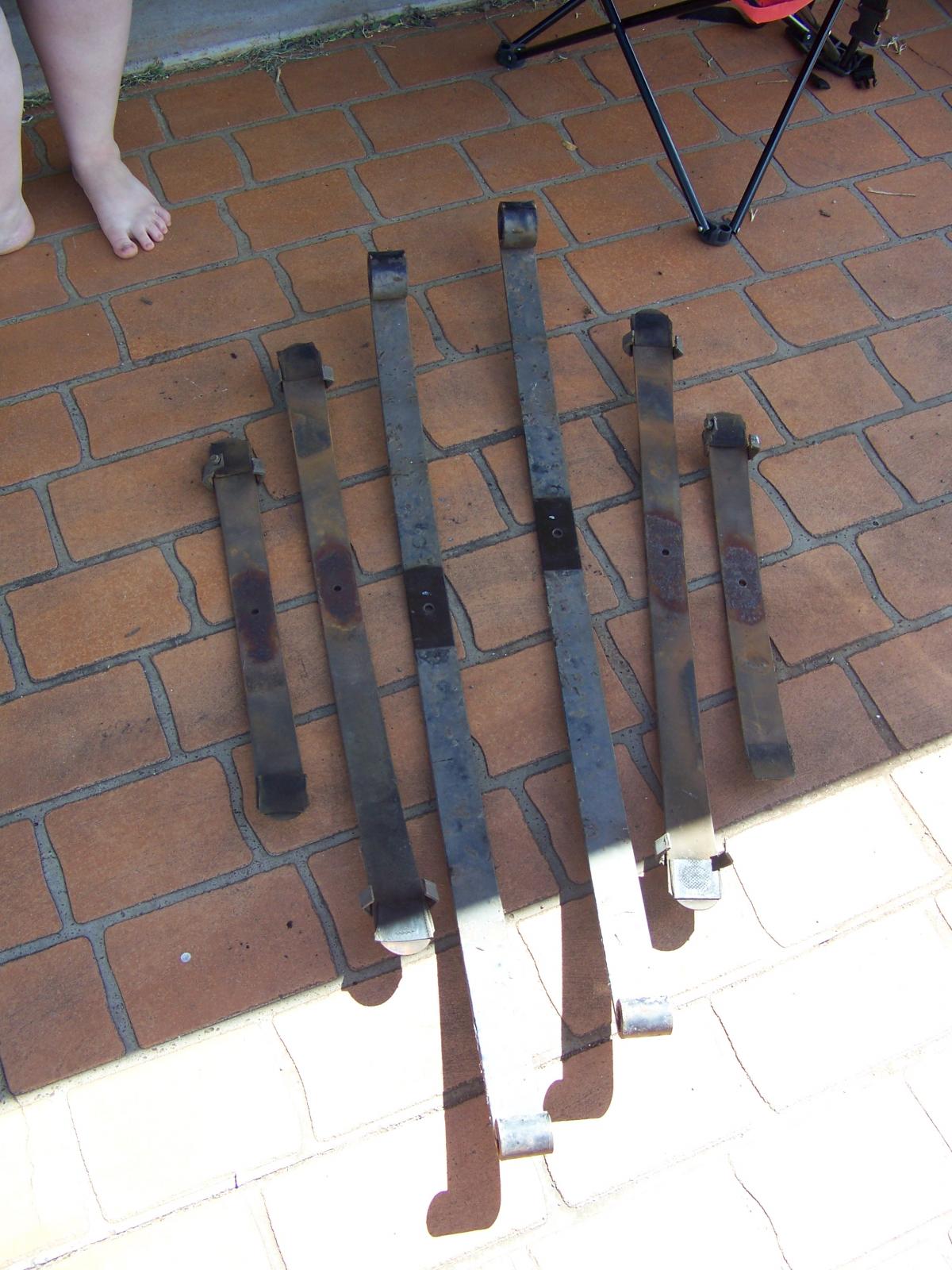

KE55 springs would be able to be used in the 70's spring pack.
Ke55 spring shown only cause i forgot to take a side be side photo :(

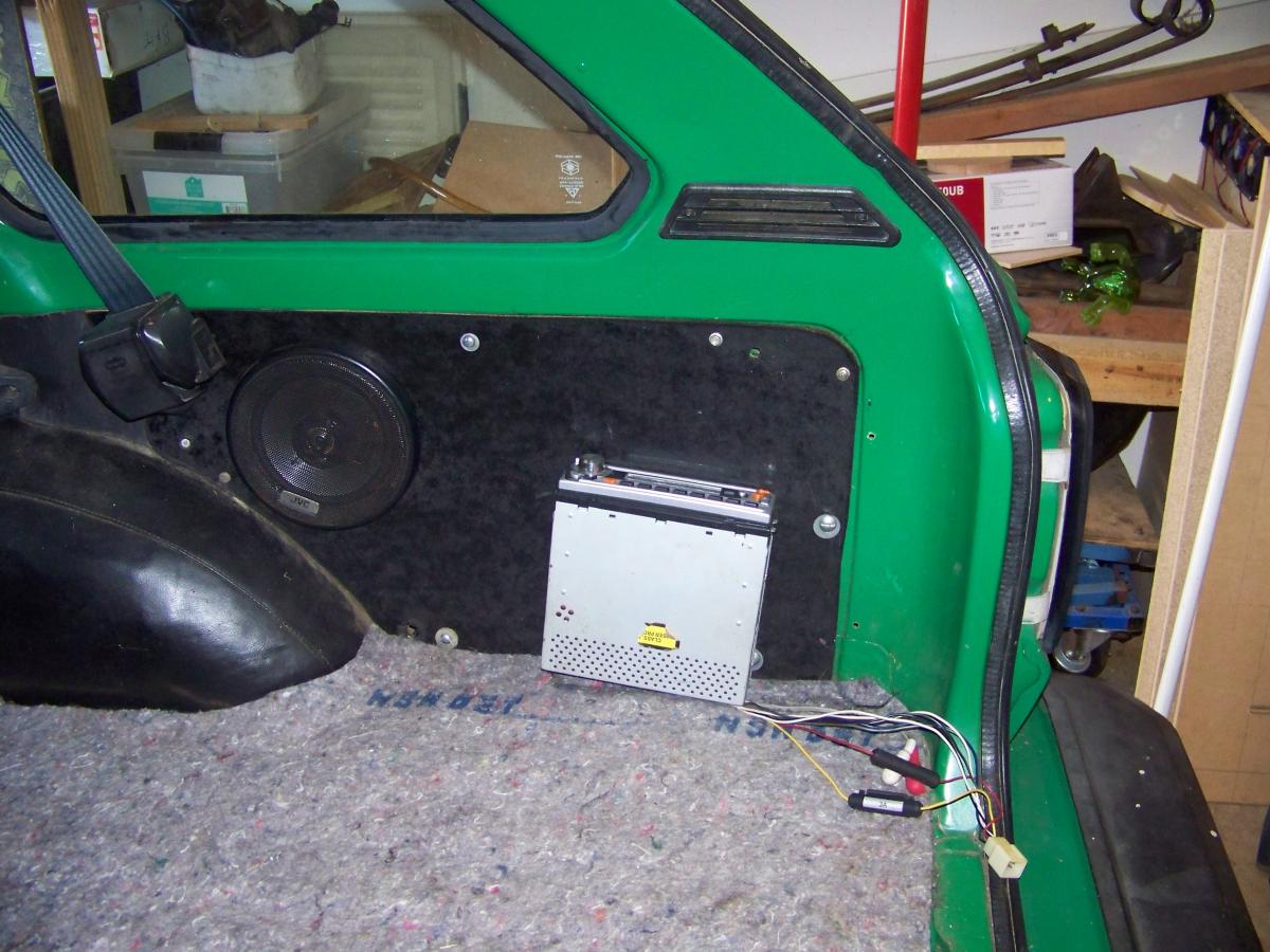

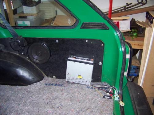

Finely mounted up, just needs a couple of little niggles sorted out.
Might be a spot for a dvd player
Or an xbox :)
Next on the cards is to fix up the surround on the head unit.

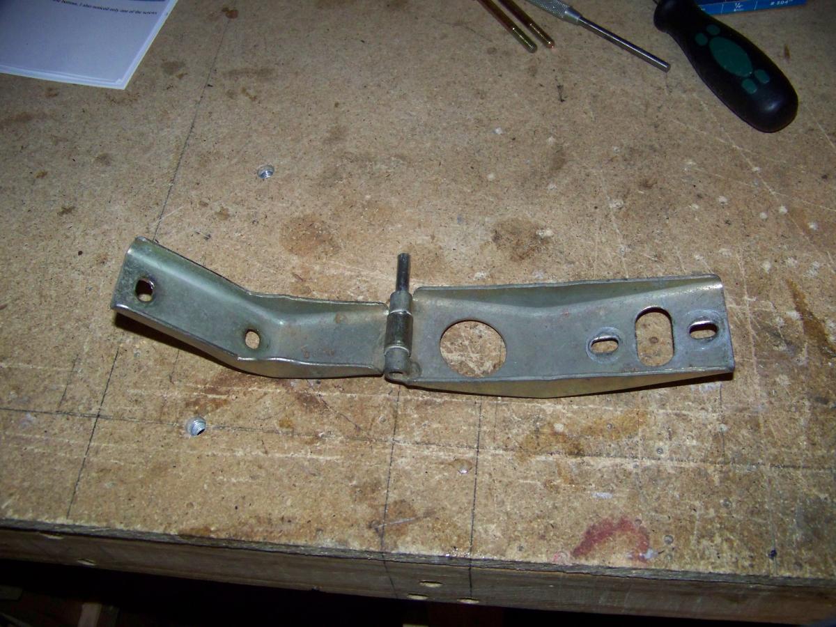

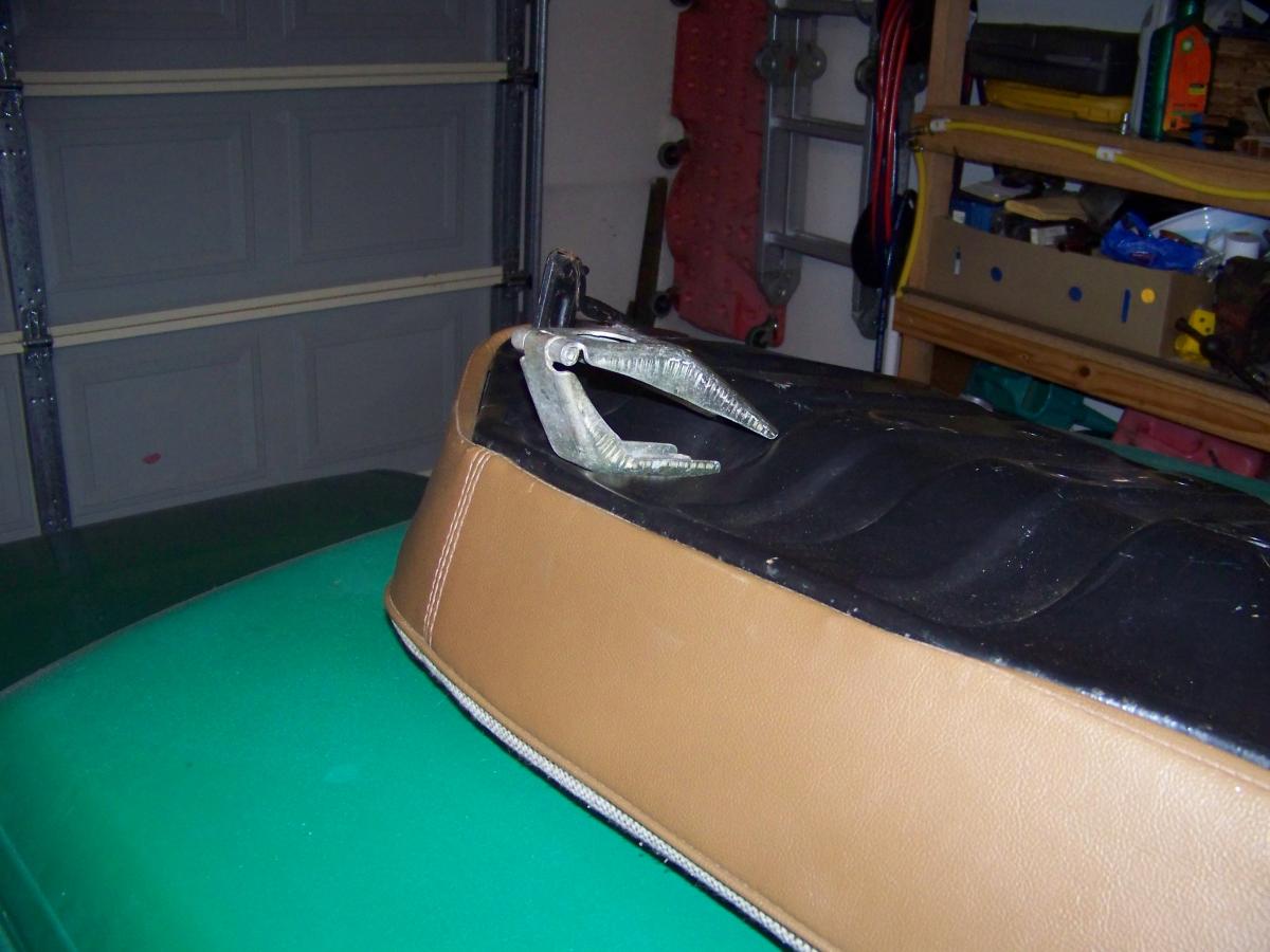

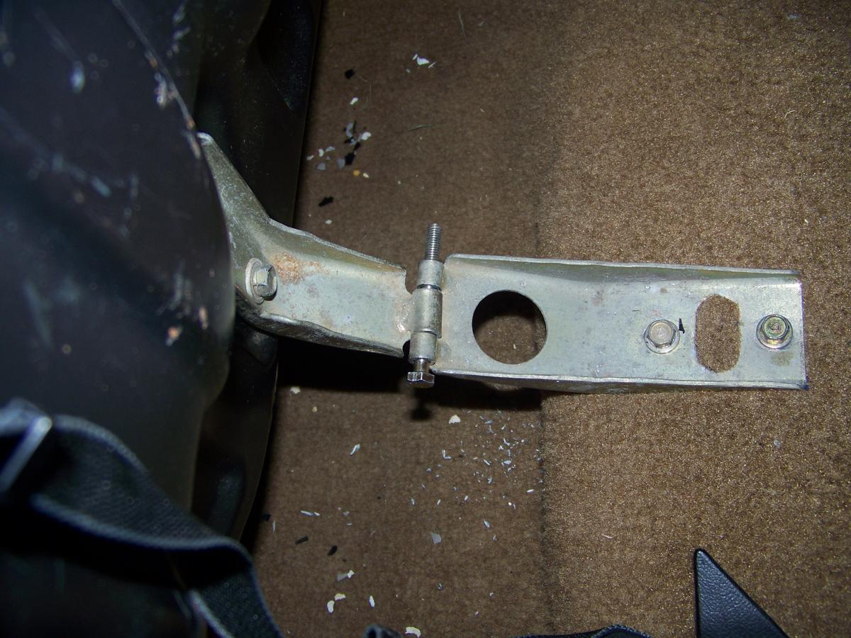

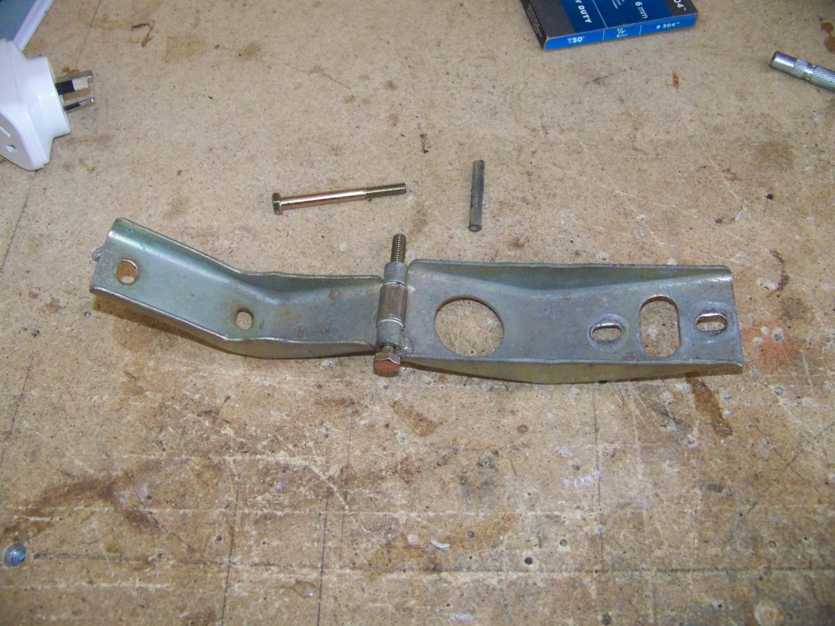

Pulled out the lower part of the back seat
Unbolted the hinges from the seat, hammered out the pins
And replaced the pins with a pair of M6 x 60mm bolts
Just had to remove the plastic insert things from the hinges. There's a bit of play in the hinges now but pulling the pins doesn't require the use of a hammer now.

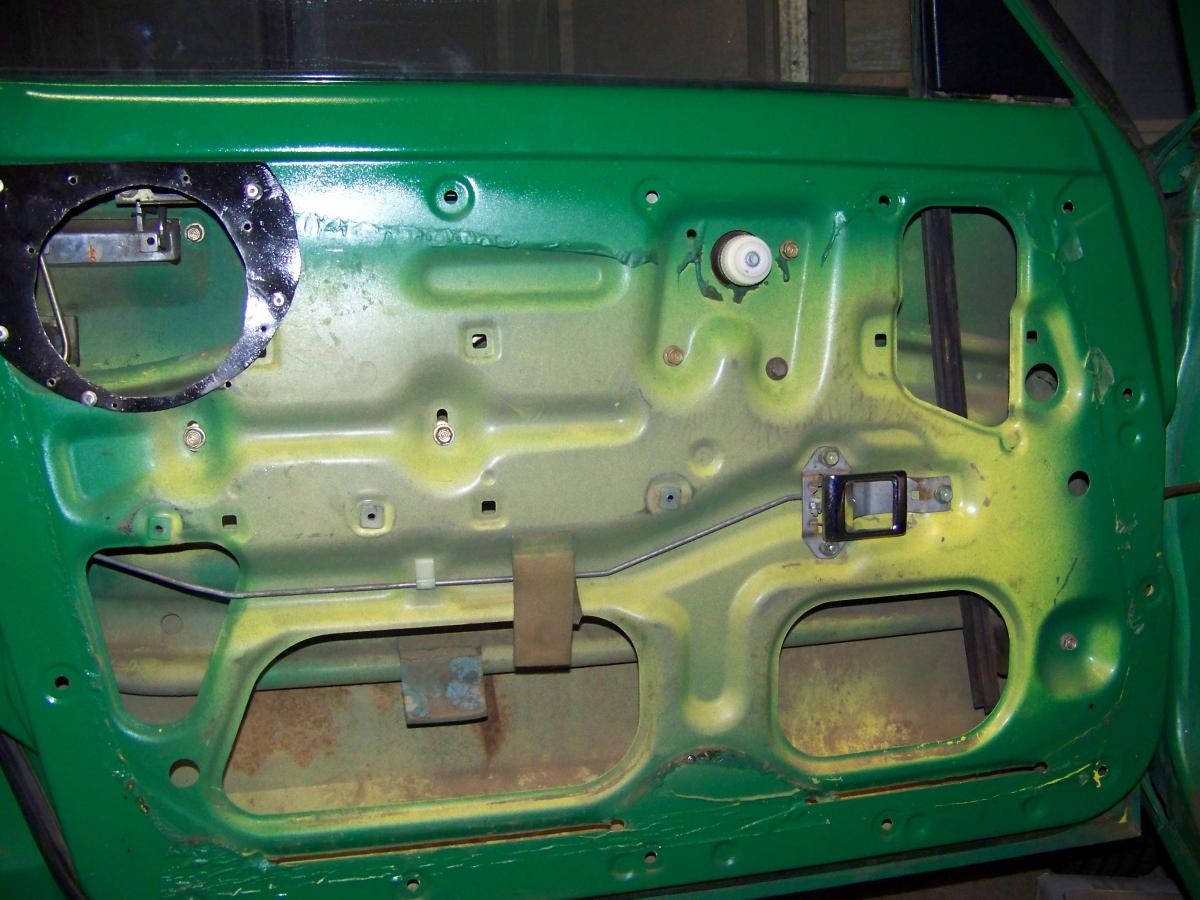

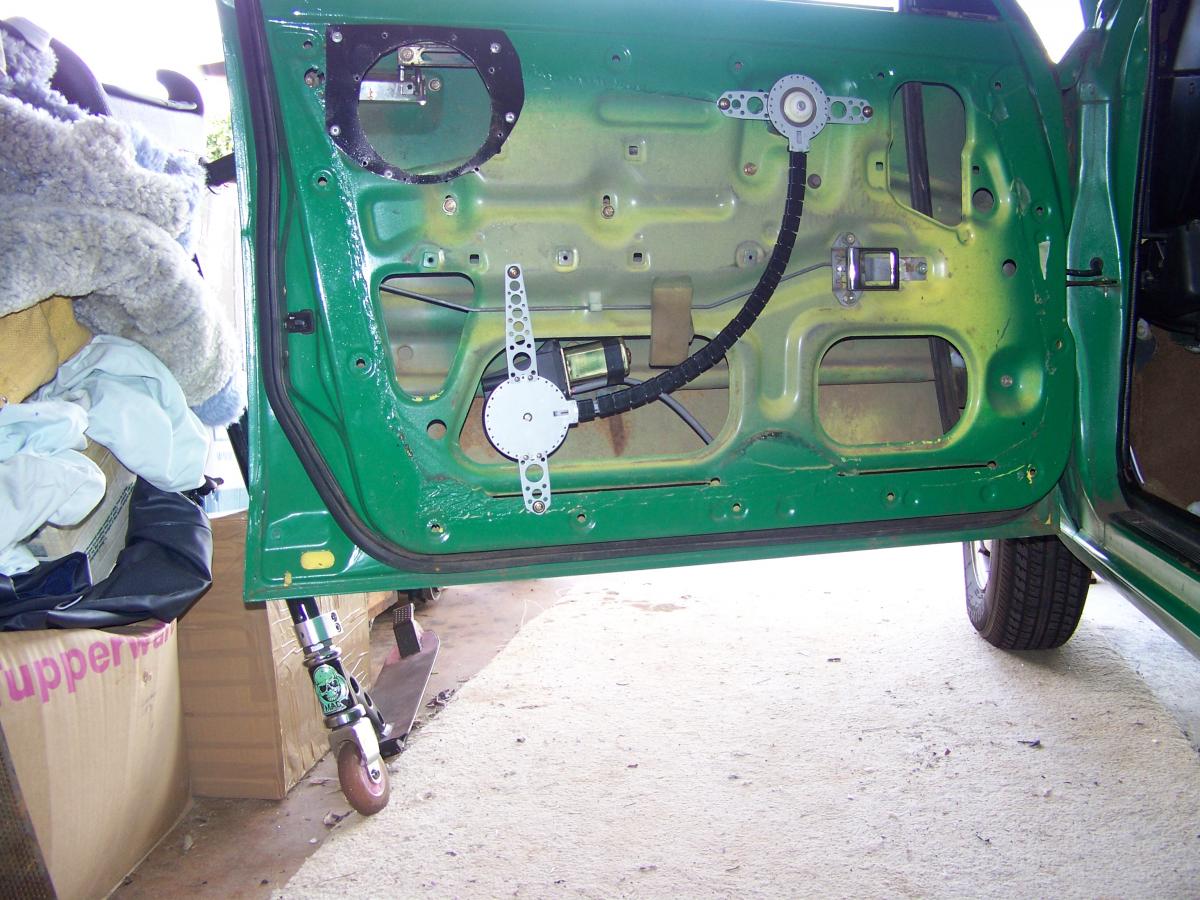

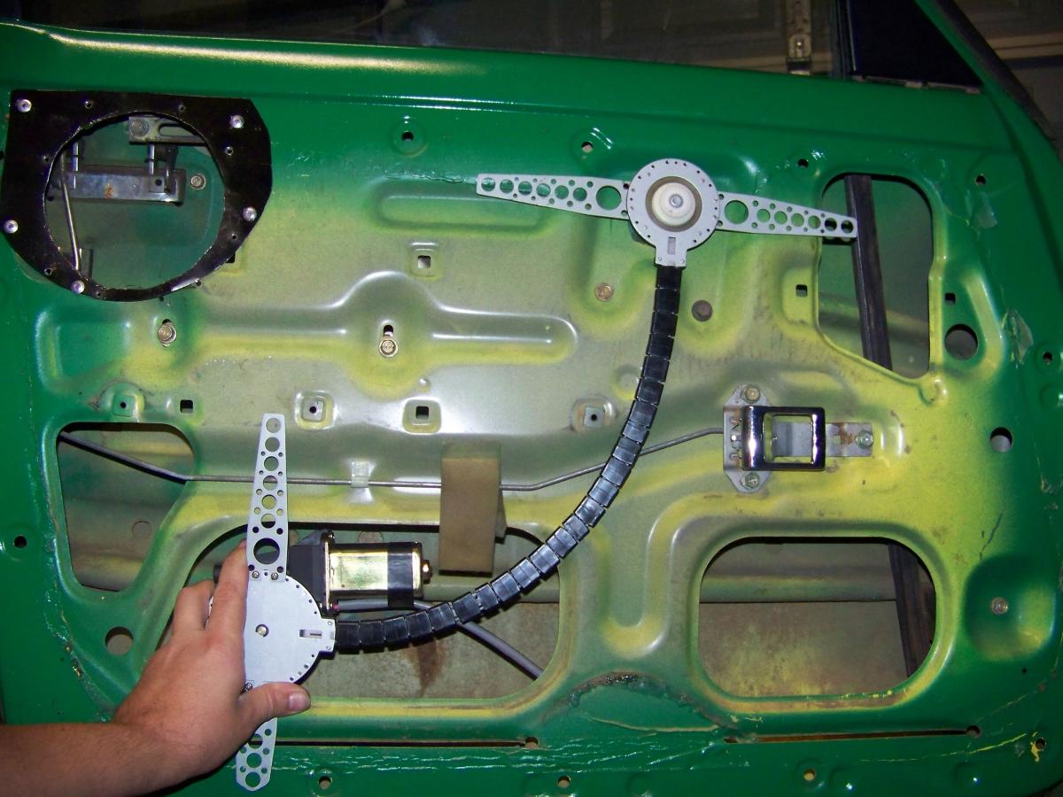

Power windows on the front doors
Location that i worked out to about the best spot for the motor.
Screwed in place.

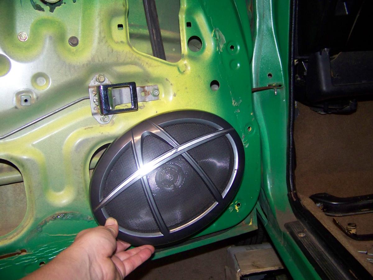

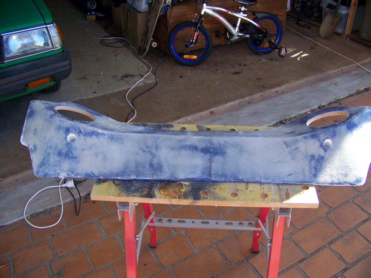

The black thing riveted to the door (top left corner) is where speakers had been placed.

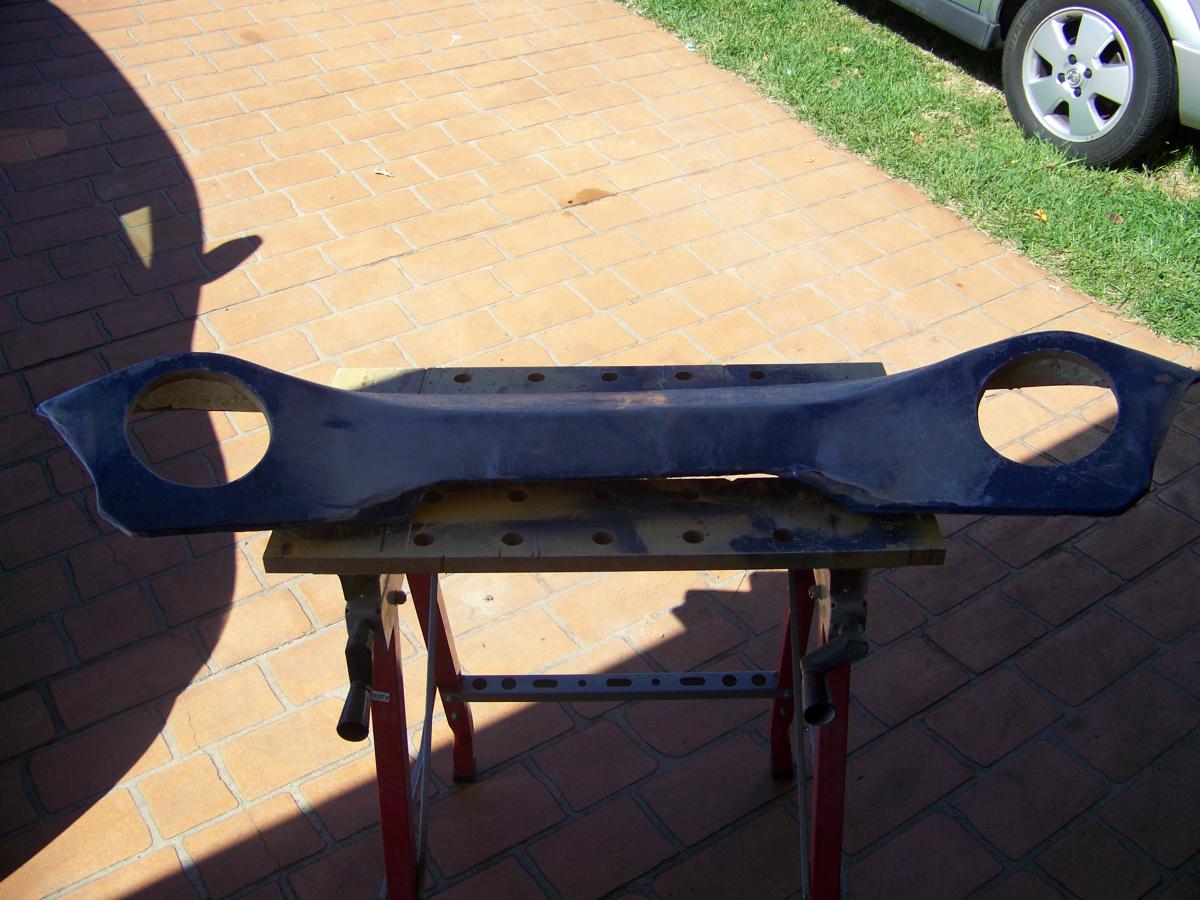

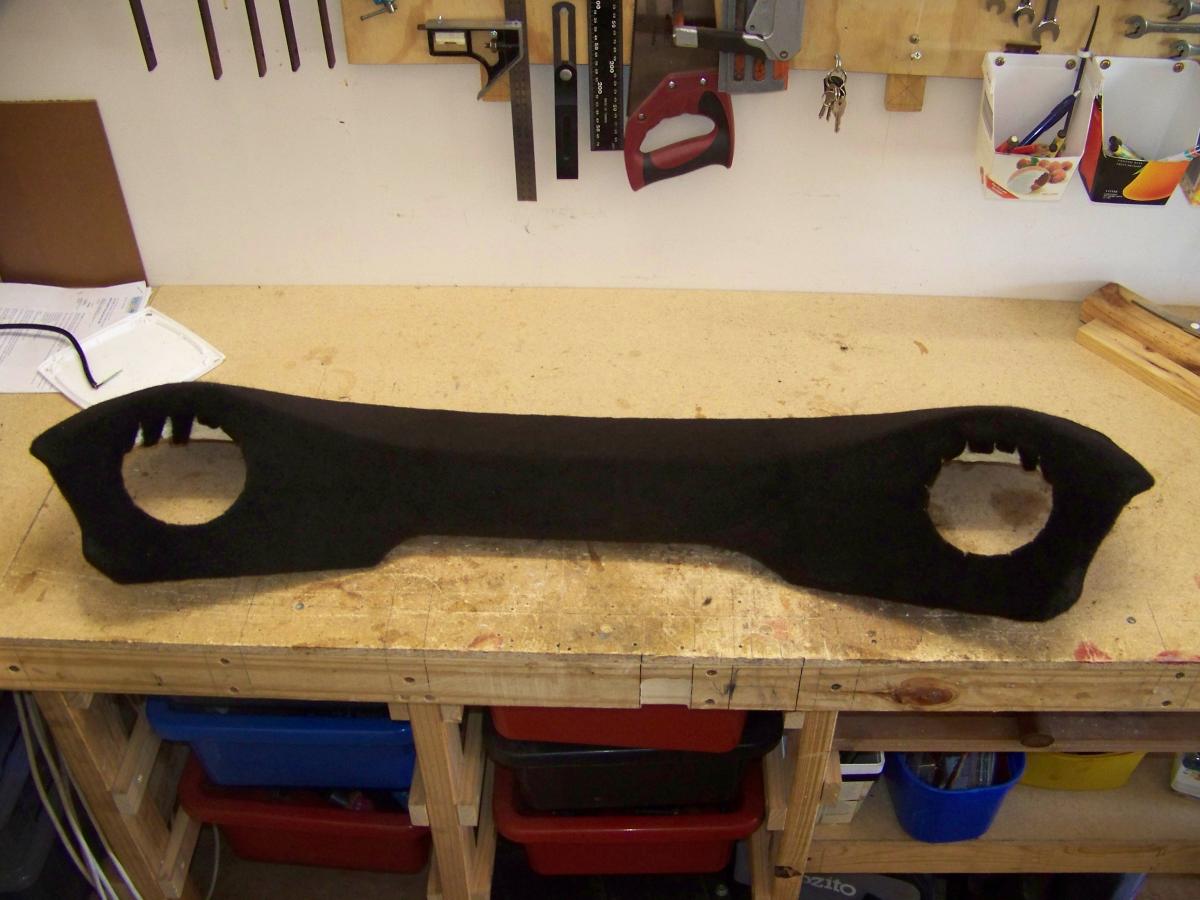

Not going to put the trim back on till i have speaker pods
made up for the 6x9's
