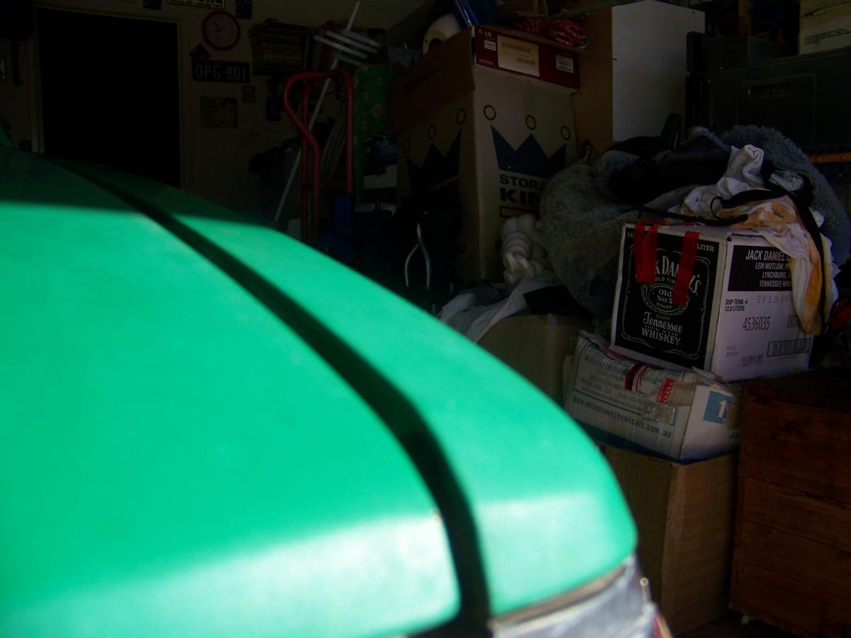

The Green Envy
Enough said
Edited by towe001
  • Replies 88
  • Views 25k
Must keep mouth shut......
been waiting for this one!!!!
H3ktik MDF boot spoiler brah?
LOL
No.
I can wait....
ta?? or ke??
I'm going to prove myself wrong & say AExx :laff:
i think it could be a T18 (just a wild stab in the dark)
RT Corona or KE20..........thats my best guess
Edited by PHATKE20S
This photo has me really thinking now......RT8# corona ? ?
ta?? or ke??
:hmm:
Sorry to say it but you are wrong.

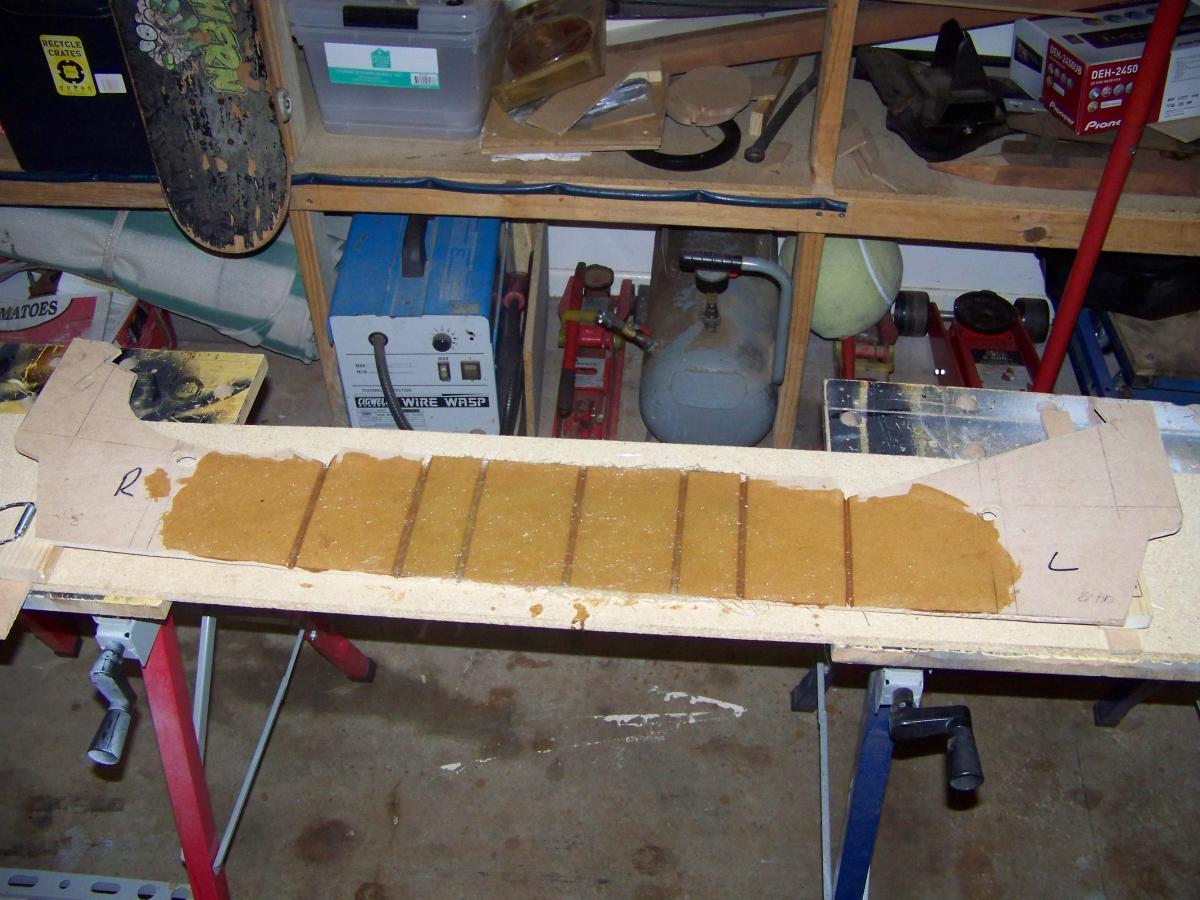

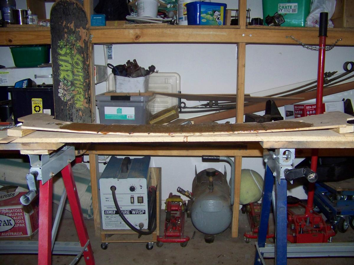

After work i did a bit more work to the mount for the rear speakers
As you can see i need a curve in the board
So i routed some trenches into the board and then laid some fibreglass over the top. All going well it'll hold the curve, otherwise i'll have to use thinner mdf sheets and laminating them together for the needed curve.
