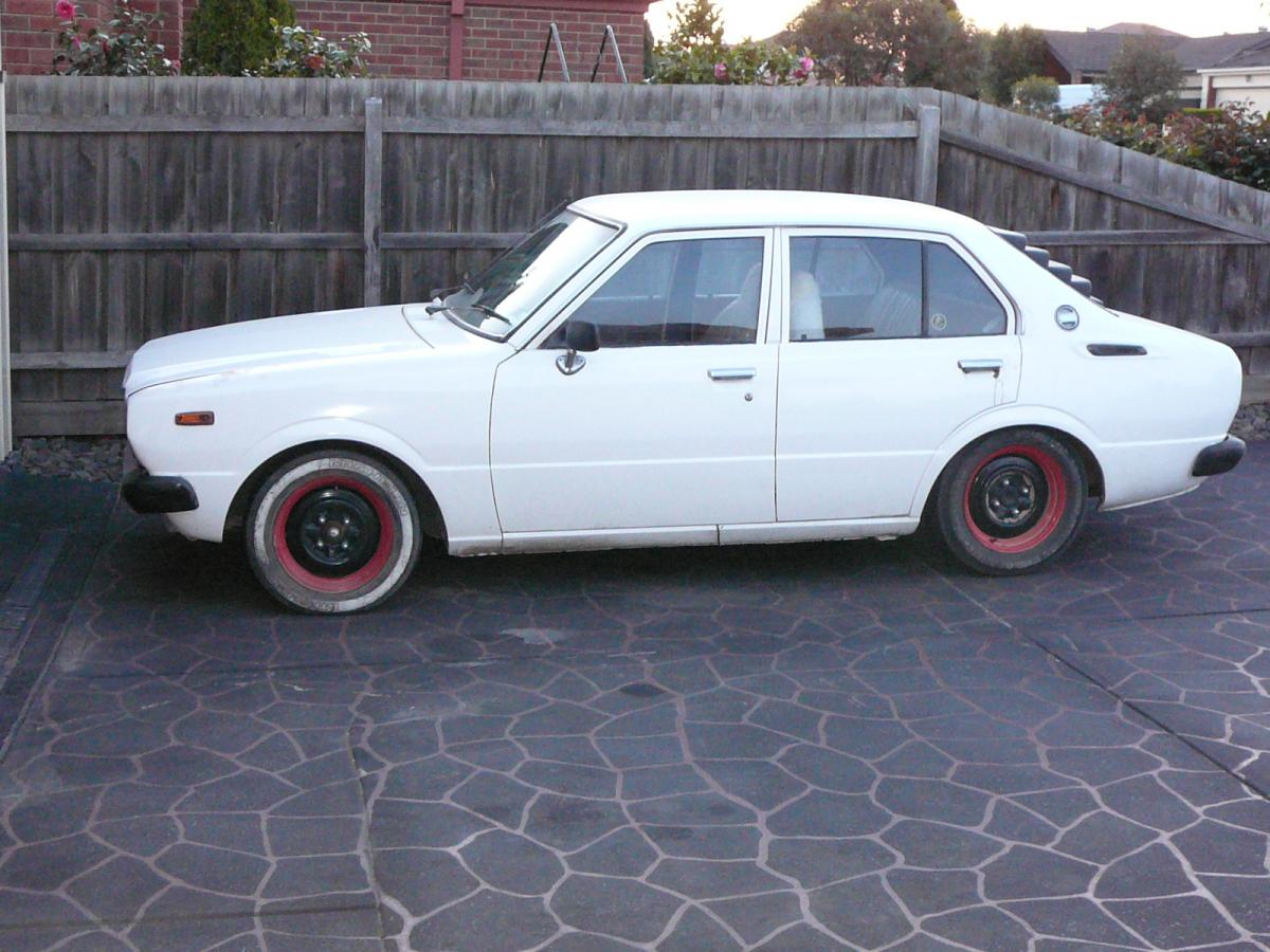

2 inch is perfect!
this pic is with 2 inch lower front and 2.5 rear ( on bump stops. don't recommend it!)

Here is a pic (at a dodgy angle sorry) of how it used to sit.
