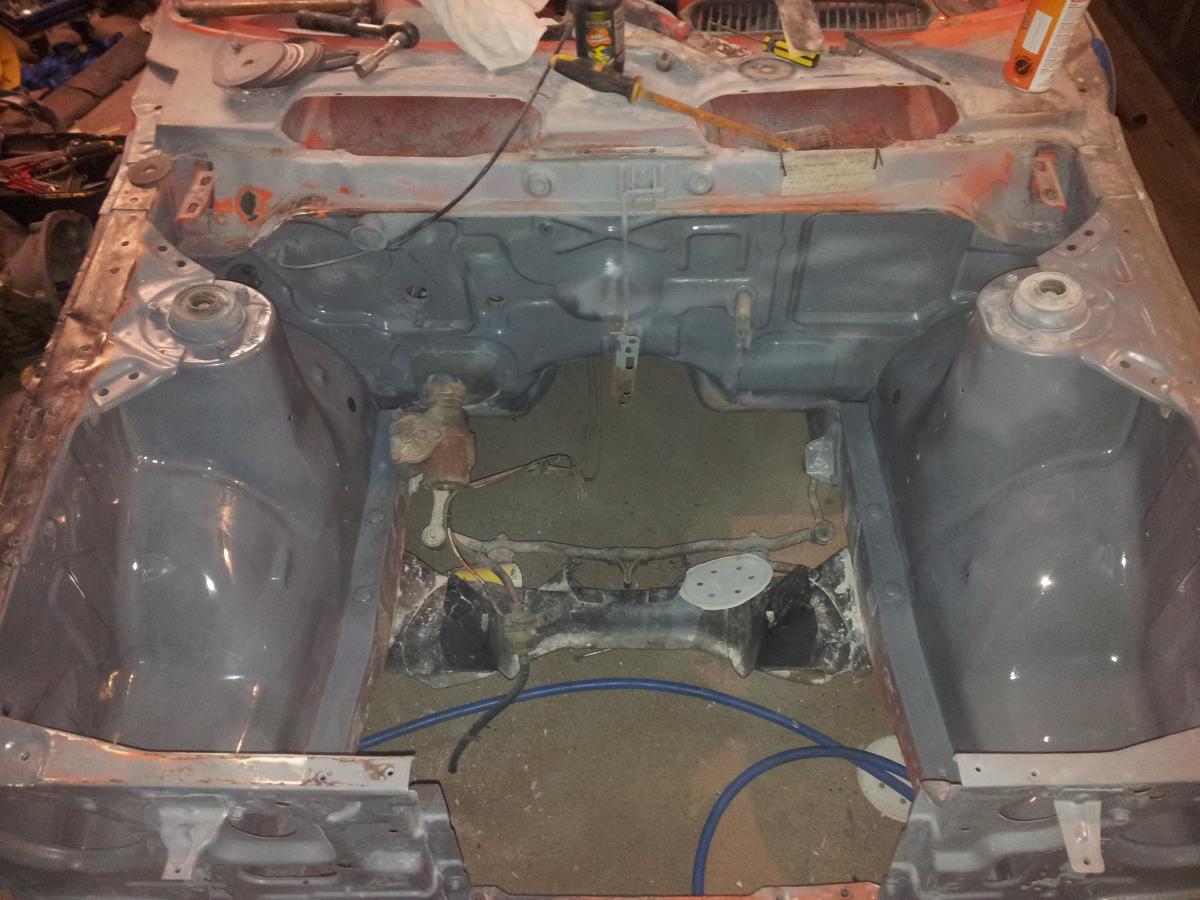

and the start of the engine bay

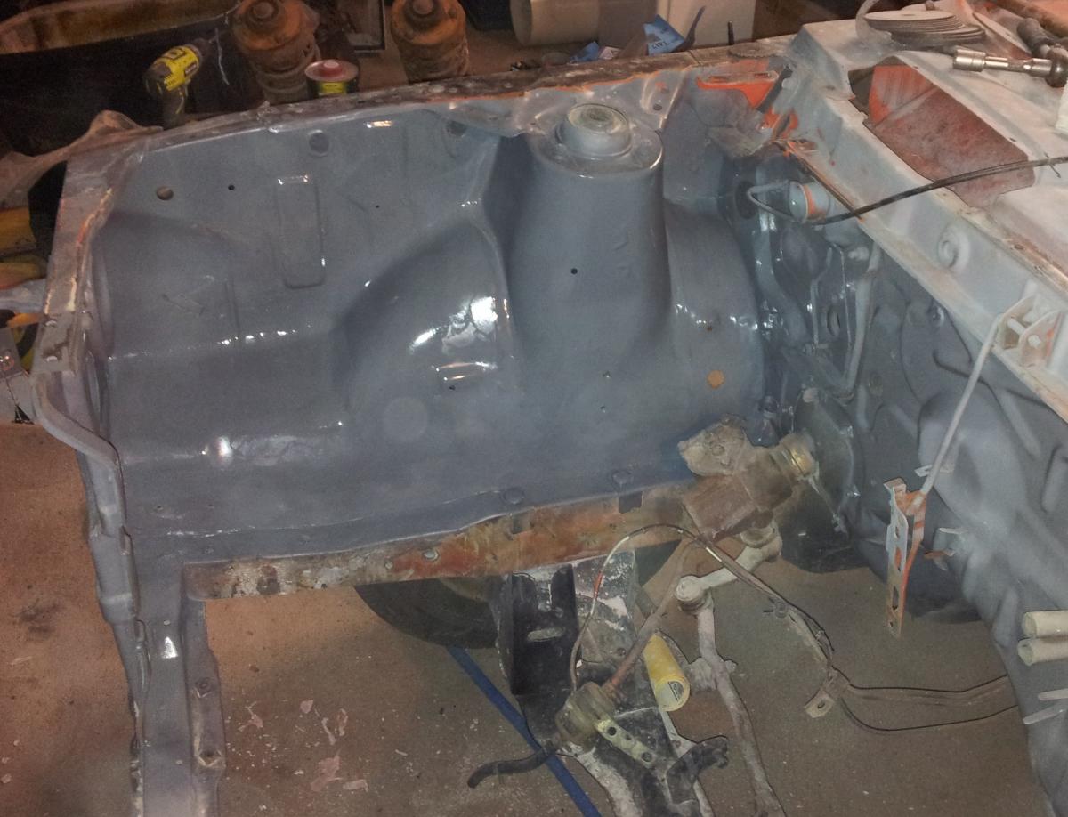

well i have been a little busy with the 20 and i will let the pics do the talking
Edited by flyinwall

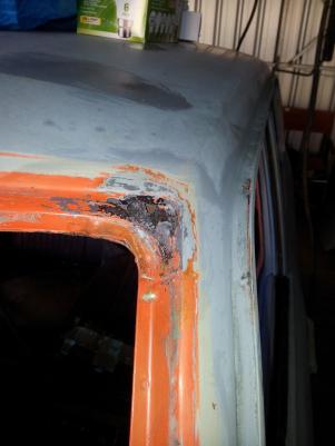

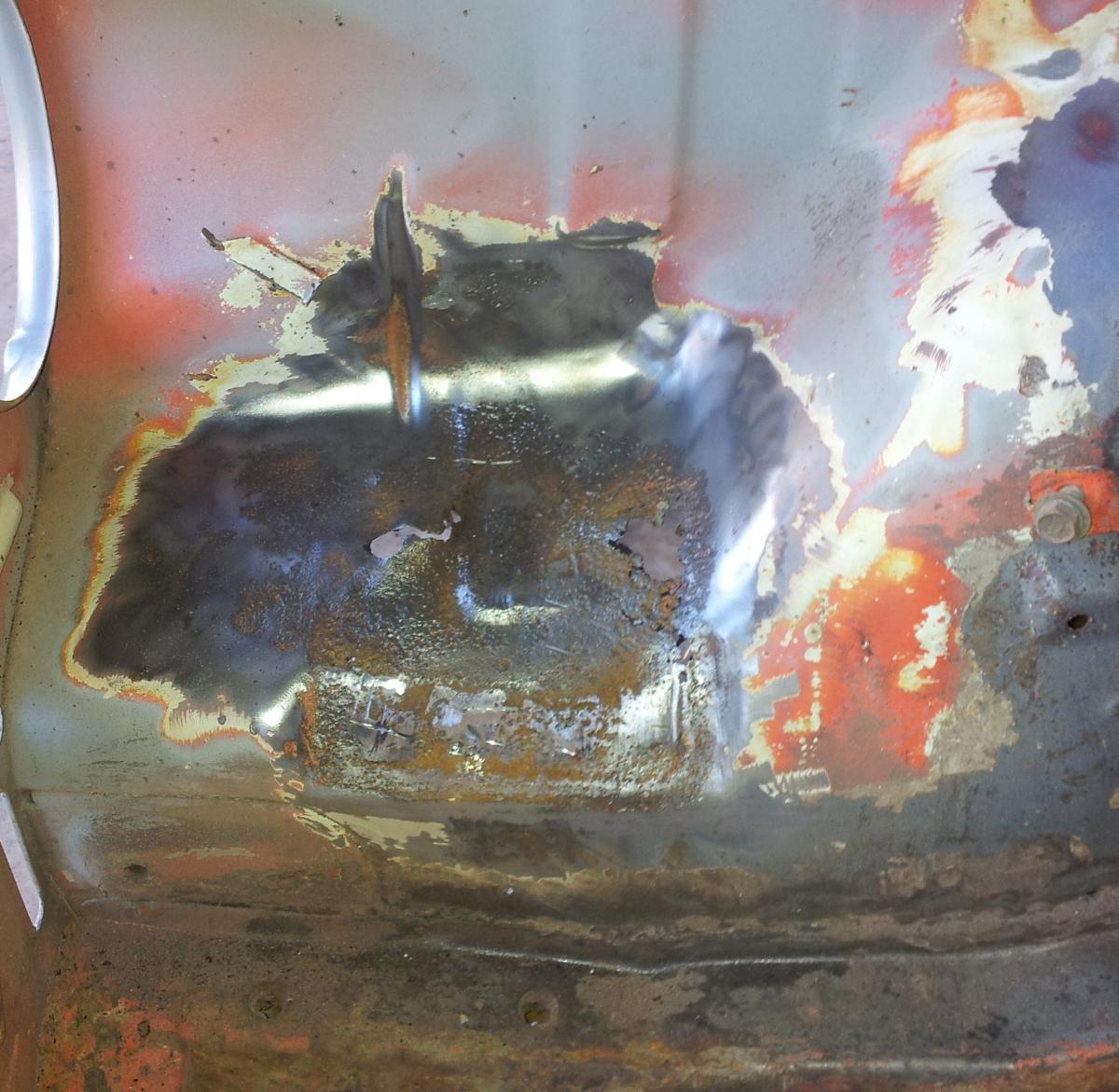

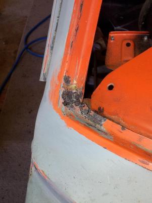

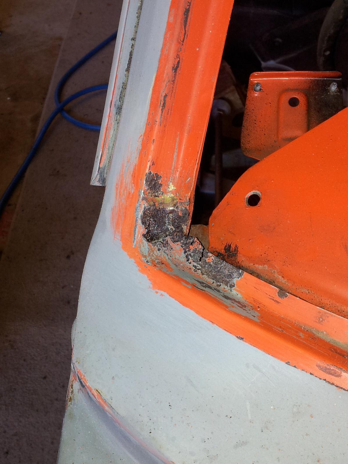

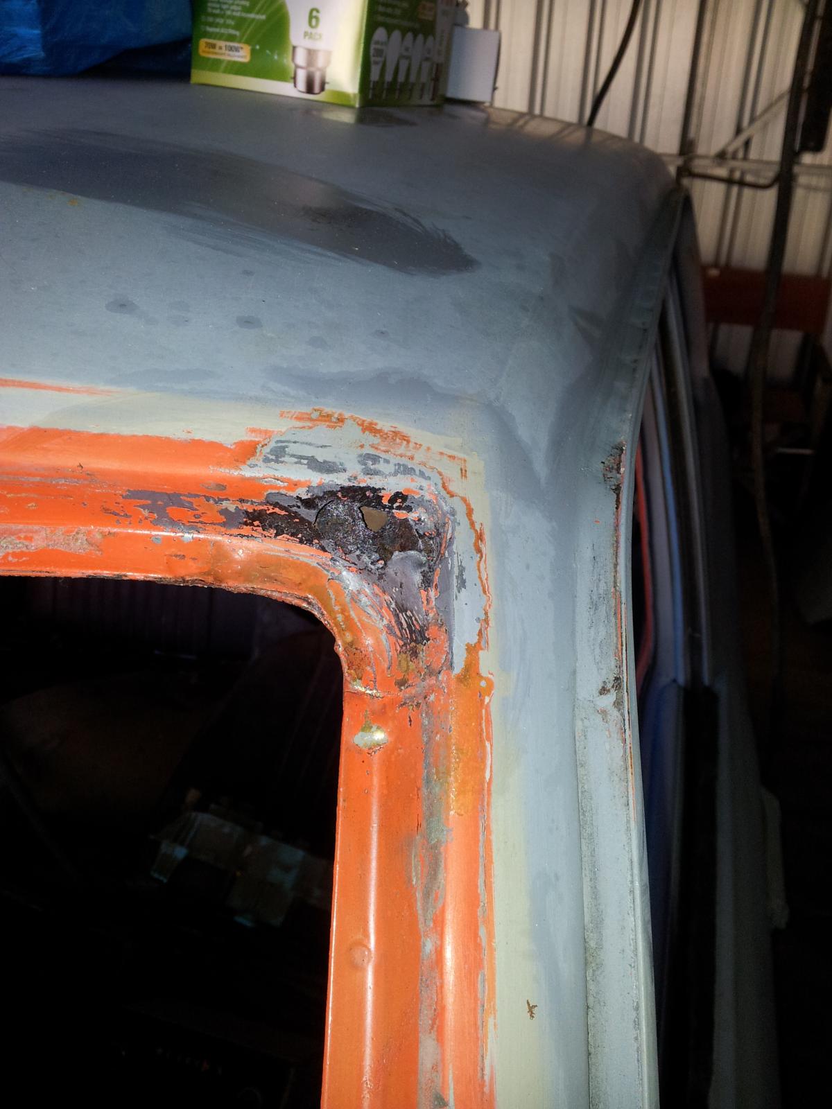

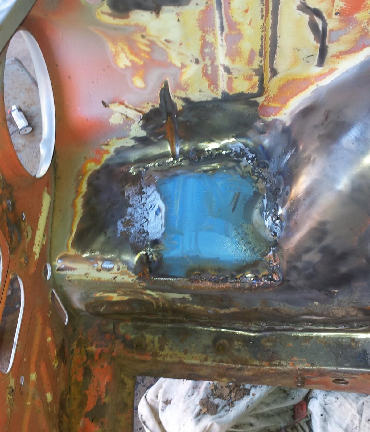

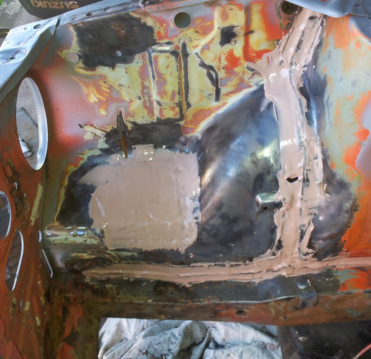

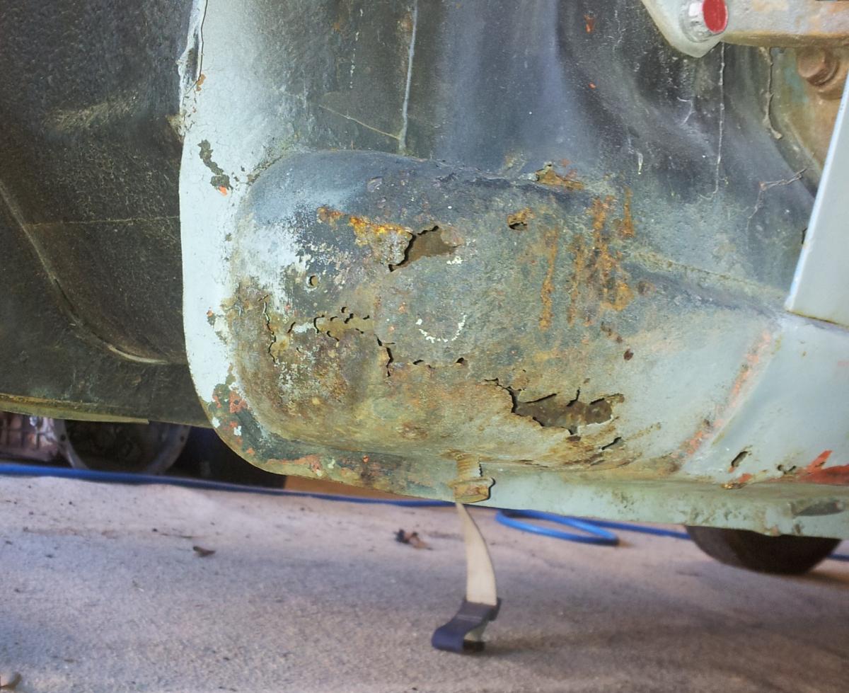

and here is some more bits of rust that have been repaired (will get more pics of the repaired parts later)
other than the rust pictured there is some under the radiator support panel and a little bit in the sub frame that is an easy fix and that is about all there is so i will be replacing the entire lower radiator support panel and getting a couple of plates made up to go where the rust is in the sub frame (the rust will be completely cut out and rust converted and new metal welded in
