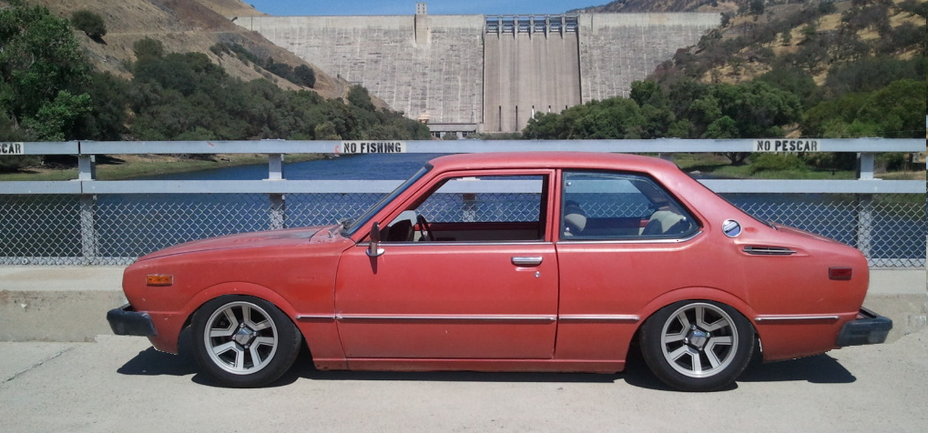

I was bored and early for work. So I took these:
I have completed my seat swap (about time). These seats feel like lazy-boy recliners. I had to take apart the sliding mechanism to make it work and then modified it some more to make the seat belts fit and work properly. It would of probably been easier to build my own form scratch. Fitment is perfect:

That back bumper looks like its big enough to be a decent workbench. The seats look great. Good work!
Nice seat swap. They look factory!
Always good to see updates from this car. Gotta agree the colour match on those seats to the trim looks near perfect!
Thanks guys. that was what I was hoping for.
