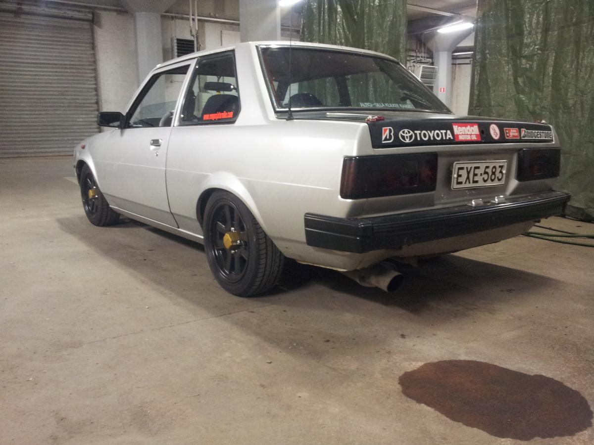

Now suspension down to below the rims, are celica wheels. tires 175/55/15
engine changed now 2t 1.6 liter
On the floor waiting 1gge engine installation .. first, the maintenance
Car wax is not enough. So, a little rough grinding and the color of wax to the surface with a syringe
New wheels have been acquired
and D2 Coilovers installed
:bounce:
Now the performance rims in the car
Gloss gun metal type color looks cool as!

not to insert a 1g engine, exchange started 2t --> 4age 20V blacktop .. oh oh a lot of work ..
satanut koko viikon, edistystä ei oikein tapahdu kun ulkona tekee lomalla
Isn't it nice when the brake booster is on the other side!!
Great work Hayha!
now been permanently in its place the machine .. of course, will remain up even if I wanted a bit lower (sump shaft 3mm)
