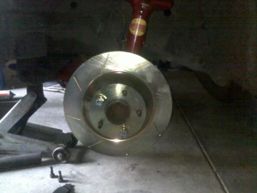

glenpos Posted July 18, 2013 Author Report Posted July 18, 2013 G'day, cars getting there, surge tanks hooked up and working, seems a touch better too, might be because of more fuel pressure, put a different air intake setup for a bit more cold air, i can't use it in saloon cars but will be better for now anyways. waiting for my caliper brackets to turn up so i can put the brakes on, you can only buy them from one place that the rules allow, he was meant to send them a week ago but i rang today and it was sitting on their desk, should turn up as long as they sent them today. pulled the rear brakes off and removed the handbrake shoe etc, and had a play with the pads and discs, there was a rusty lip that the pads had been touching, before i could barely turn the wheels, now they spin freely, was hard to push the car before too and now its much easier so should be a bit better, racing sunday so should be fun, might even rain ;) Quote
