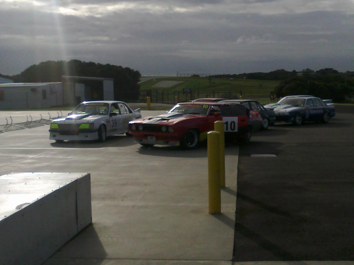

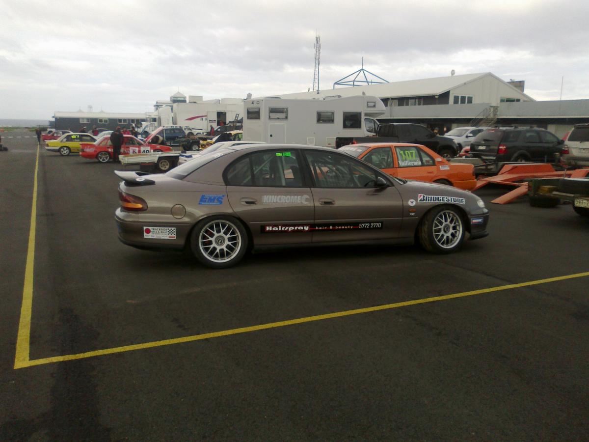

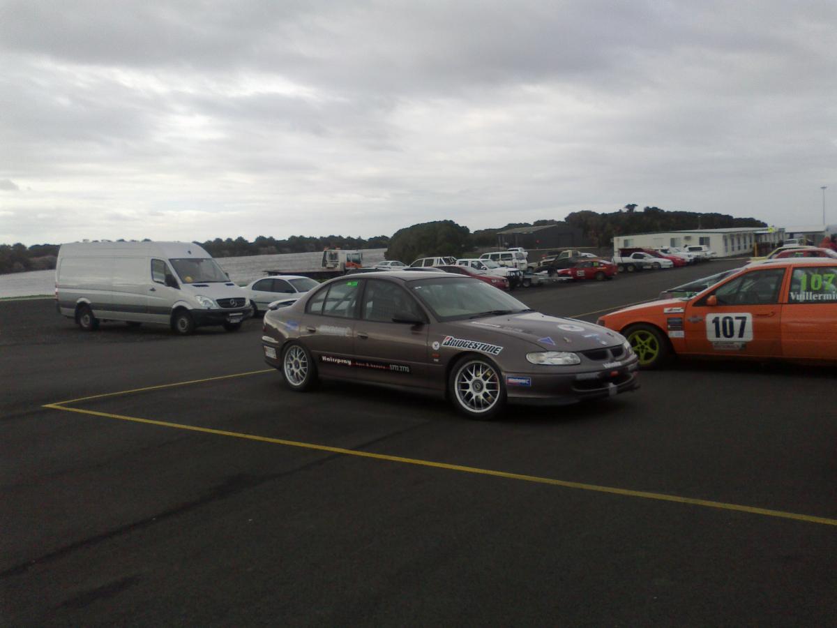

hey guys, Phillip island was a blast, although it was freezing and really windy, its such an awesome facility, there was allot of serious cars there, i had a few problems with the car.. but don't really care, for starters the tail shaft is out of balance and starts to wobble the car at over 200kph haha, so i couldn't hold it flat down the whole straight, there was a bloke there in a ea saloon car, he parked next to us and was really nice and helped out with a few things, he's currently 2nd in the trophy class of saloon cars (older models) they aren't much slower than the new ones, i got to follow him in session 2 and pretty much kept with him, the car was a bit understeery, was gonna put spring spacers in the rear but didn't get to, he was about 1.5 secs faster than me, he said he was getting 214kph so i wouldn't have been far off, i got 7 laps but only got 1 fast lap until half my windscreen rubber came off and was banging on the roof, so i came in and fixed that, then noticed there was an oil leak, one of the lines that goes from one end of the rack to the other had a crack in it, these had never been pulled off... but we are guessing it was from the tailshaft vibrations, after this it started raining so i wouldn't have improved my times any more, so i'm looking for a new gearbox too, mine is jumping out of 3rd, and a few times it wouldn't come out of 3rd to go to 4th and the same for 4th to 3rd, it also crunches every time i go into 3rd haha, have winton in 3 weeks, lucky all i have to do is fix the line, don't get fast enough for the tailshaft to vibrate.

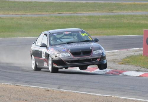

Hey guys, winton was awesome on saturday, great weather, the car didn't miss a beat!! managed to drop a second off my best time in session 2, i'm now down to a 1.41.1, i got about 5 laps in the 1.41 marks and most of the others were low 1.42s, might have got faster too, but in session 3 i lined up next to a vn saloon car, and there was 4 more of them infront, managed to pass them all in 4 laps so i was happy, and the next race i lined up next to a mate in his 300rwkw r33, bet him off the line and pulled away, he said if he got infront off the line i wouldn't be able to pass him, so i let him get infront off the line, we had a fun battle, i was able to get him through the corners, but down the straight he just flew by, on lap 2 i managed to get hi back through the corners and pull enough of a gap so he couldn't get me down the straight, then i started to pull away, was great fun though, came 1st in my class, came around 10th-15th out of 76 cars so i was pretty happy, only bugger was that i left my incar camera at home on charge..... but got some good outside vids!
it was also a pain driving with one hand for 6 corners in a row as i had to hold it in 3rd hahaha

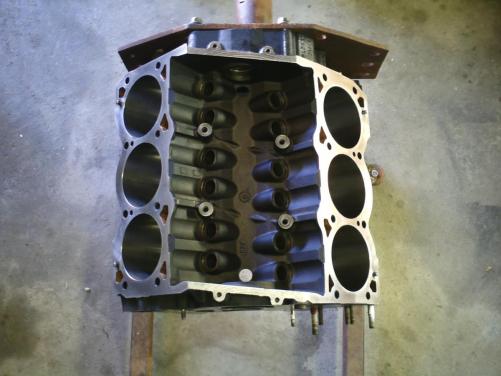

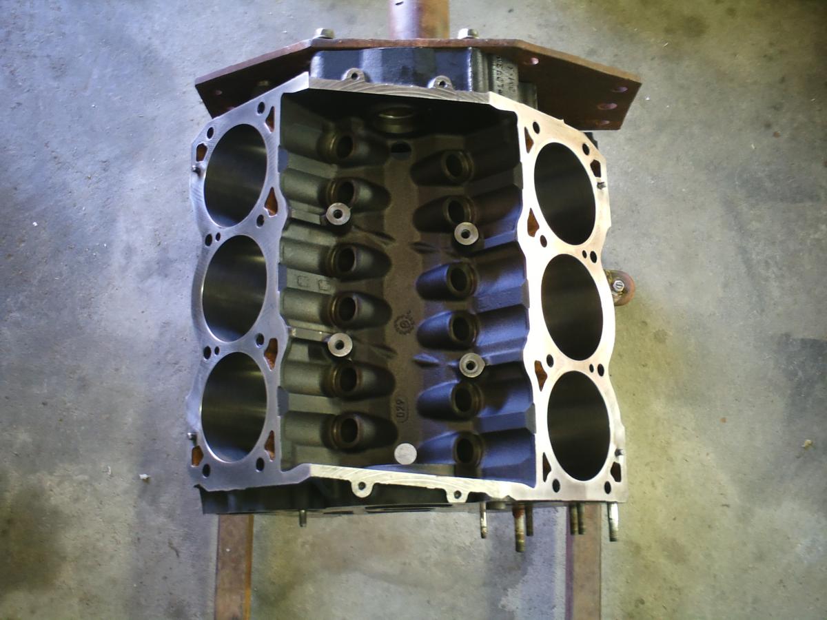

G'day, engine work is starting soon, went in to order pistons today, ordered STD size ones, $456, then got a call a few hours later saying that they no longer make the pistons and they have no STD size ones left, so am getting it bored out 40thou which is the max the rules allow and they have a few sets left, it will cost an extra $270 to get it bored out so not too bad, will give it a touch better performance, also got a price on balancing for $200, much cheaper than i was thinking haha, and getting acl race series gaskets for $50 each, they are 1.4mm thick, so after they have been squashed down they should be a bit closer to the 0.95mm min, the STD ones that are on it now are 1.6mm so probs like getting 10thou shaved off the heads.. will also do the 6mm wide and deep match porting that is allowed to the inlet manifold.. and can get it glass bead blasted, can't wait till it starts coming together!!

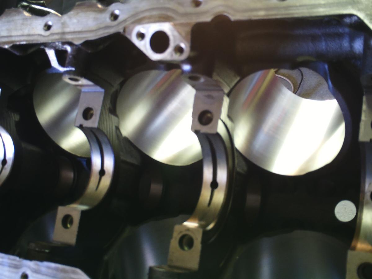

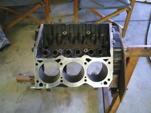

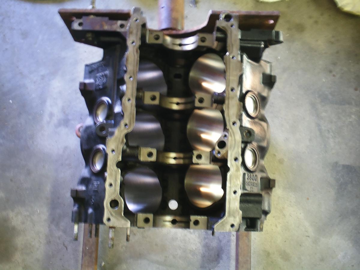

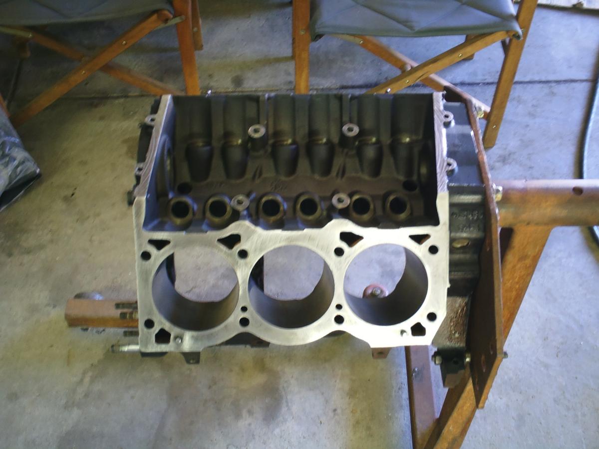

G'day peoples.. picked my bottom end up last week, came up great, new pistons look nice too, just picked up the crank flywheel pistons etc etc from getting balanced, he seemed to do a nice job and took a fair bit of meat off too, so should be sweet, will start putting it together soon and get it sealed :P
thought i'd put some pics up of the block, doesn't seem to have much interest but i guess it is a commodore haha, will put some pics up of the rest of the bottom end when i'm putting it together.
would be putting it together, but i'm to busy getting square eyes watching bathurst stuff haha
