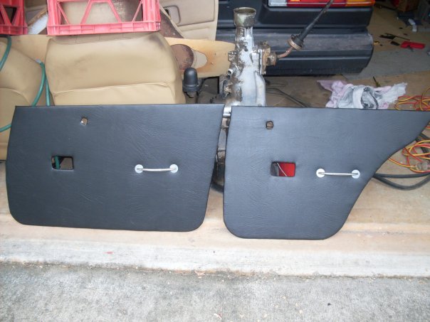

October 2, 201213 yr comment_629912 If you want something cheap and light to cover your door cards, go to spotlight and grab some vinyl. Costs about $15 for a 1x2m strip. These are the ones I made for my old KE70, same as yours just some MDF but I stretched the vinyl over the edges and stapled it with 6mm staple gun staples. Only thing is the staples might push through so you need to lay a thin bit of padding down but you can get this 5mm white fluff sh1t from spotlight too. Cars looking schweeeet Report

October 4, 201213 yr Author comment_630200 wow it came out really well!! great effort!! in time you might consider a 7A bottom end, doesnt like to rev high but great for a 10psi turbo set up :P and that oil cooler is BOSS!!! Thanks mate!!! I'm still undecided as to which way i will go with the engine N/A or Turbo???? hmmmm.... I'd have to say I'm leaning towards N/A atm but who knows. The oil cooler looks awesome, not so sure on the practicality of it tho as i just spent 15 mins picking all the bugs out from last night!! hahaha. If you want something cheap and light to cover your door cards, go to spotlight and grab some vinyl. Costs about $15 for a 1x2m strip. These are the ones I made for my old KE70, same as yours just some MDF but I stretched the vinyl over the edges and stapled it with 6mm staple gun staples. Only thing is the staples might push through so you need to lay a thin bit of padding down but you can get this 5mm white fluff sh1t from spotlight too. Cars looking schweeeet Cheers!!! I thought of using vinyl to cover the doors but i ended up just painting them with export satin black hahaha super cheap had it on special!!! Came out ok but i will probably go the vinyl when the paint starts to look shit. This is how they turned out, Looking awesome dude!! I think tis time for some coilovers ;) Thanks mate, Coils and sway bars are most certainly next 2 thing on my list!!! Just need to start saving up some dollars!!! I have read your build thread right through but can't remember what you are running.... An advice or recommendations? I'm set on whiteline for the sway bars but as for coils I haven't really looked into it too much just yet. looks awsome mate Cheers Azza!! So last night I went out to the willowbank test and tune night super keen to see what diference all this work had made.... I had in mind mid to low 15's. My first race i was up against my mate in his Gti-r and i already knew i was gonna loose!!! haha. My first take off was soooo bad!! The sticky track, semi slicks and LSD made the car completely different to last time i was there!!! I axel tramped hard off the line and missed 3rd gear 3 times!!! and only ran a 16.4 My next few runs were not so bad, still axel tramping a little bit off the line I got down to a 16 flat then a 15.9 and 15.7. Last race of the night I was up against another of my mates in his Evo 8, his best time for the night was a 14.8 so were wern't to far apart, I got a decent take off, no axel tramp and managed to be almost level at 60ft then he pulled away... I ran a 15.6 tho best time for the night so i was really happy with that. I know the car can go faster too i just need a bit more practice to get it right!! Here is my time slip. Not bad considering i was up against an Evo!!! That was also his best time for the night too. Pic I found today. Edited October 4, 201213 yr by ShAe82 Report
