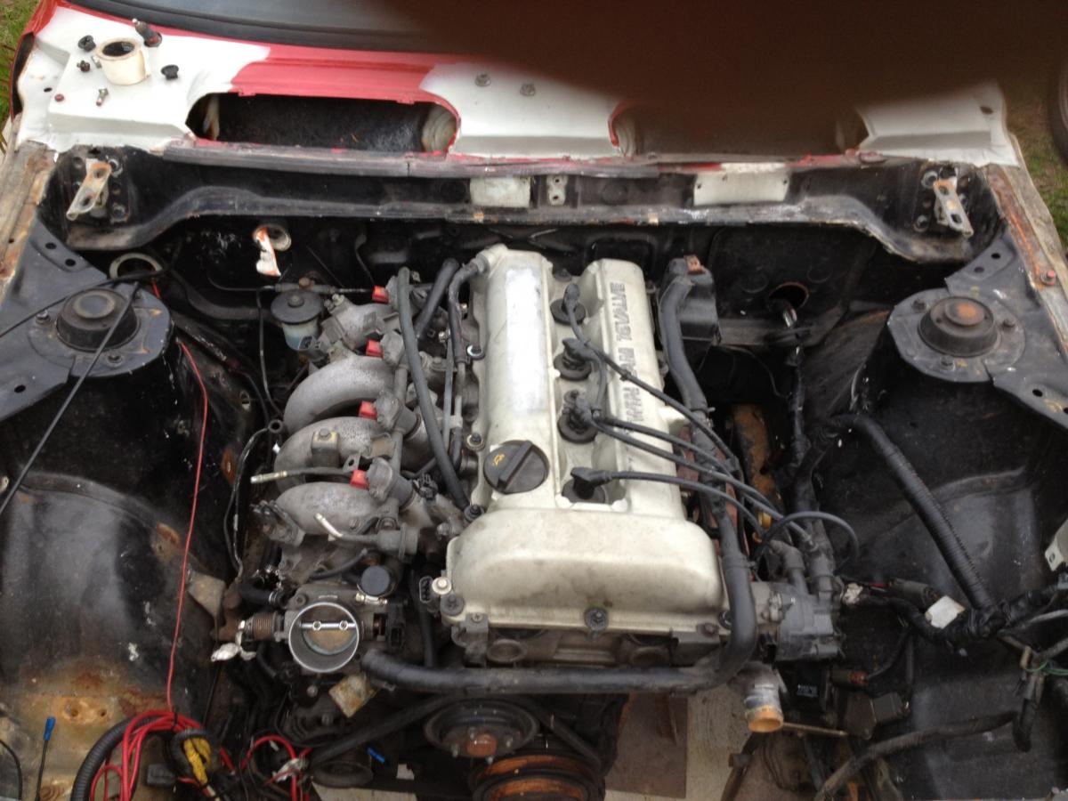

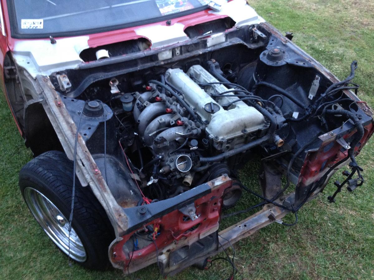

maybee ..still thinking wether or not to put it in.. probably won't need it ...

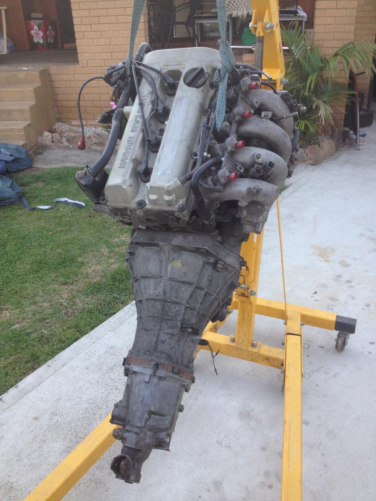

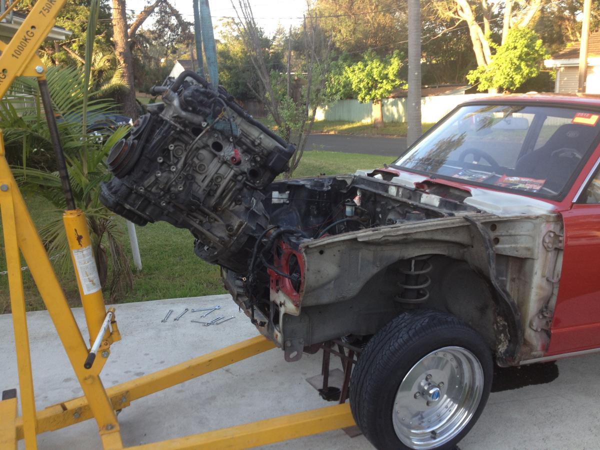

disconnected motor and gearbox today .... all ready for when the crane arrives tomorrow

Defiantly needs a fat turbo sitting in the bay :P
Looks a bit bare yeah!

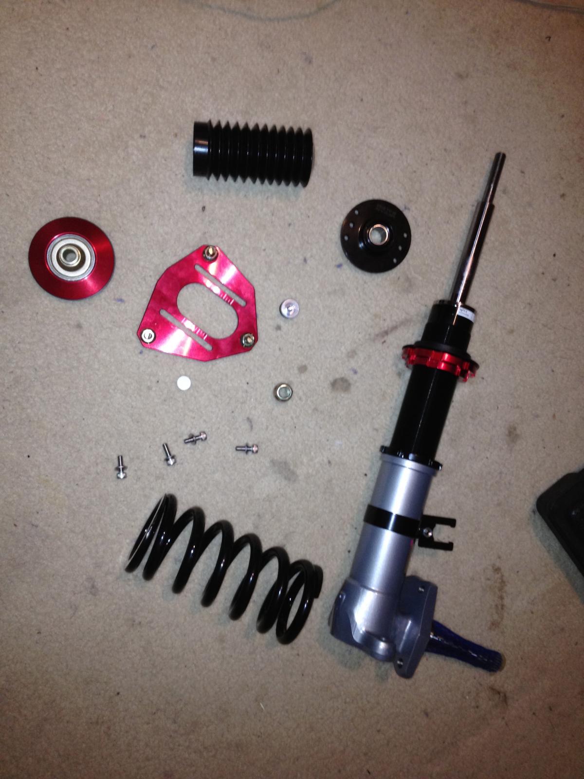

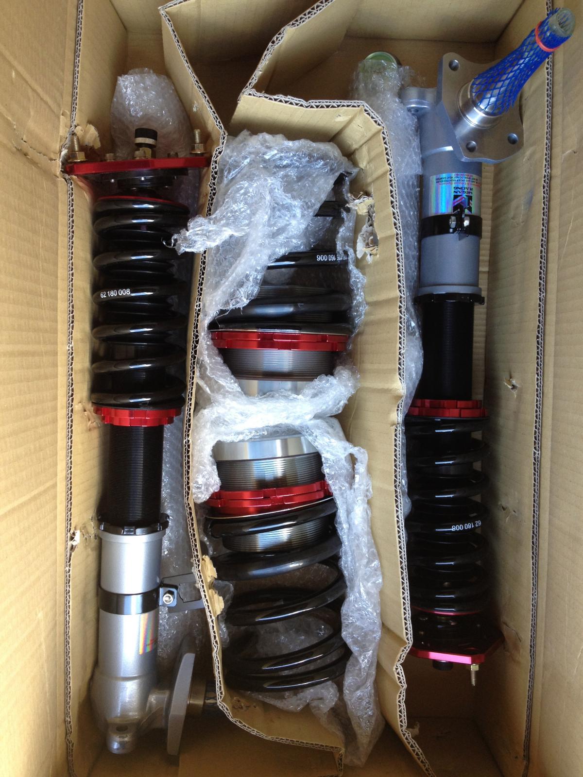

What brand is the coilovers? Where did you buy them?

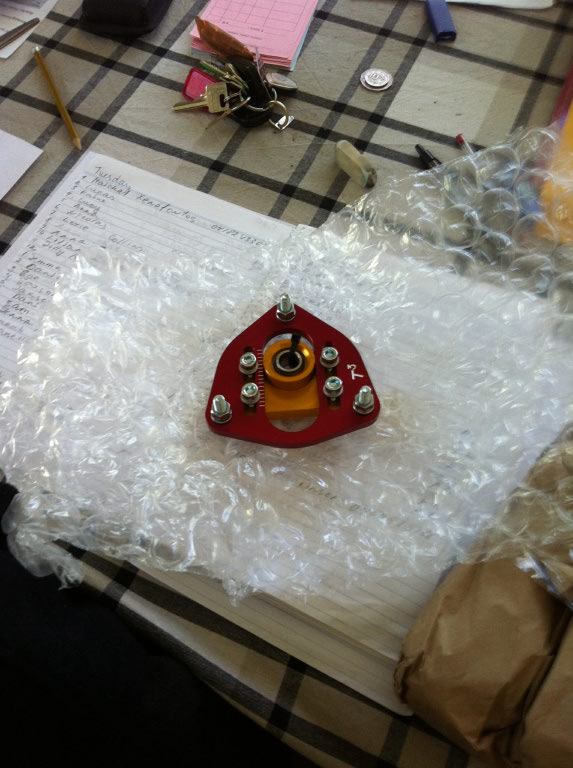

they're megan coilovers and don't fit ! lol going to take them to get machined tomorrow
Ok,
What kind of car is it for and what do you have to do to make them fit?
(puuuuuuuh that was a lot of todo`s) ;)
they're off an ae86 .... theres a few nuts and ball joint spacer that i had to machine so the camber plates fit..... thats just the top bit.... haven't sorted out the bottom yet... that drama will have to wait till after the motor goes in when i end up fitting them ....

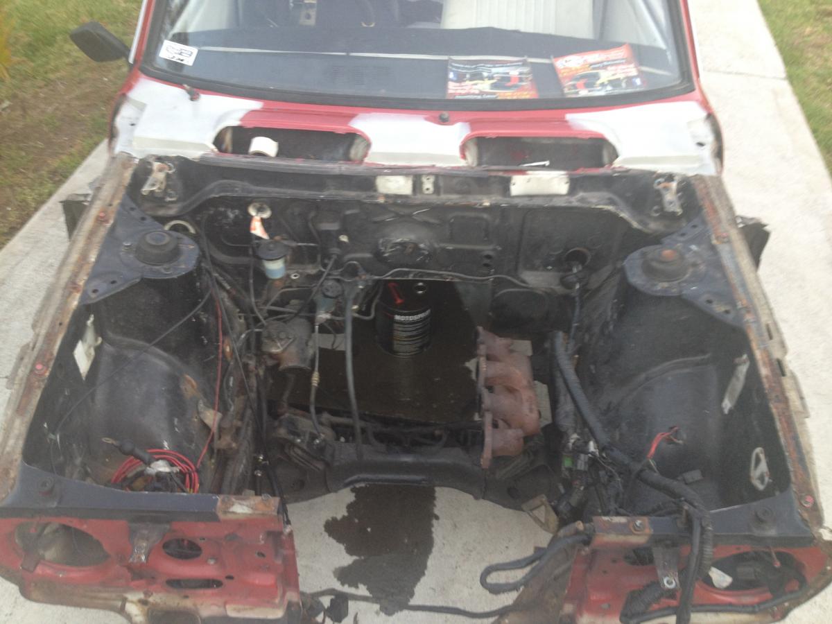

just took the motor and gearbox out... and paint stripped half the engine bay ready for seam welding
