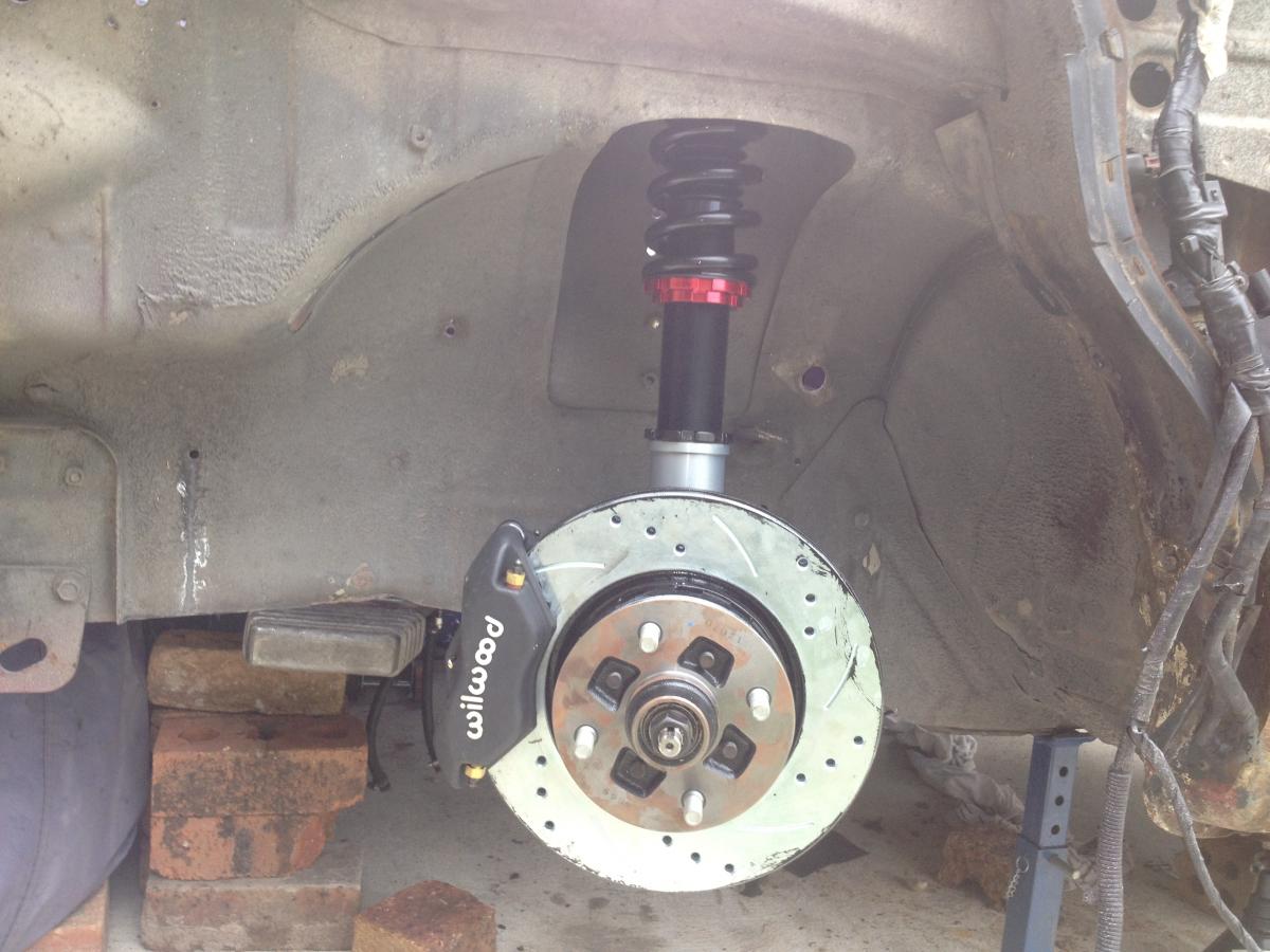

Ended up selling the aw86 power steering knuckles. Turns out they don't fit at all . Way off. So I just got some blank copy's of them made up and drilled them myself

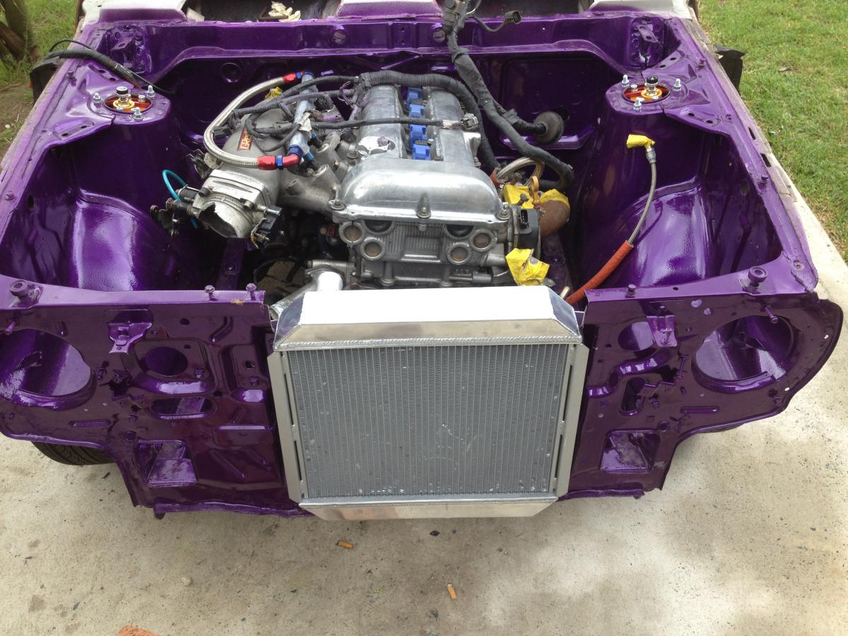

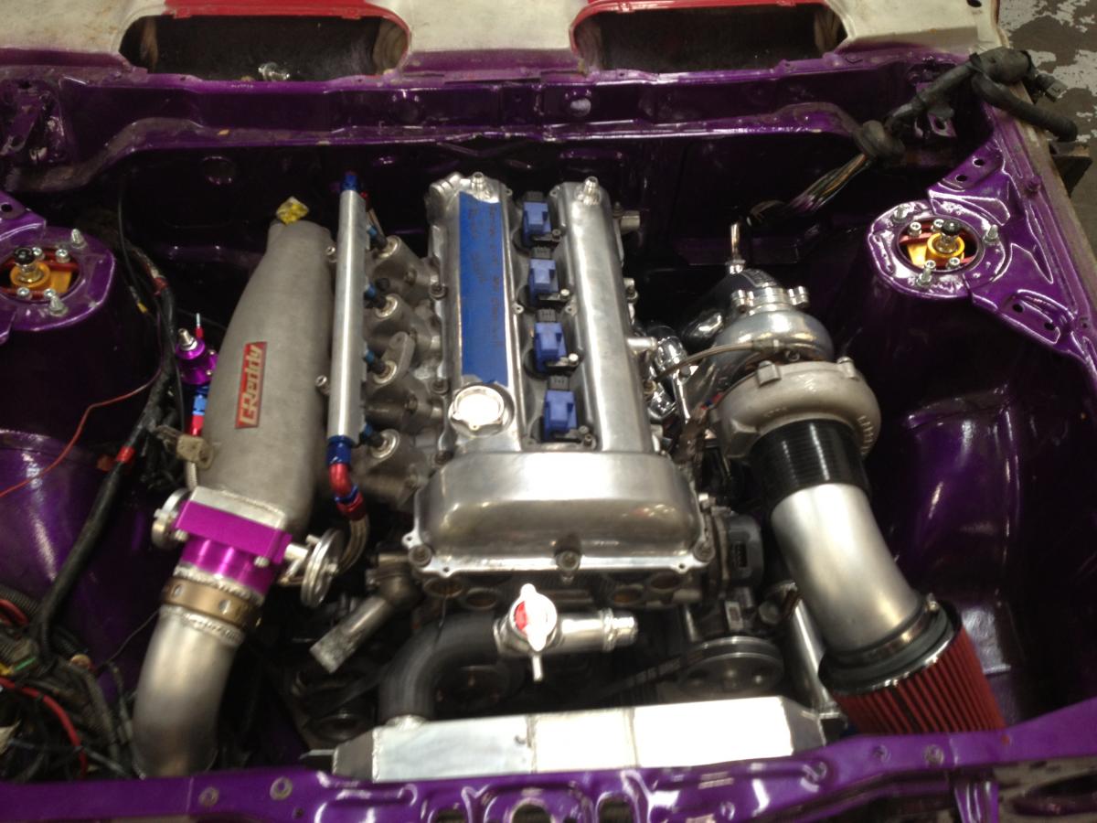

she's rollin now and radiators finished and all in .... nathan from just alloy radiators did a mad job ... heaps happy with it ....

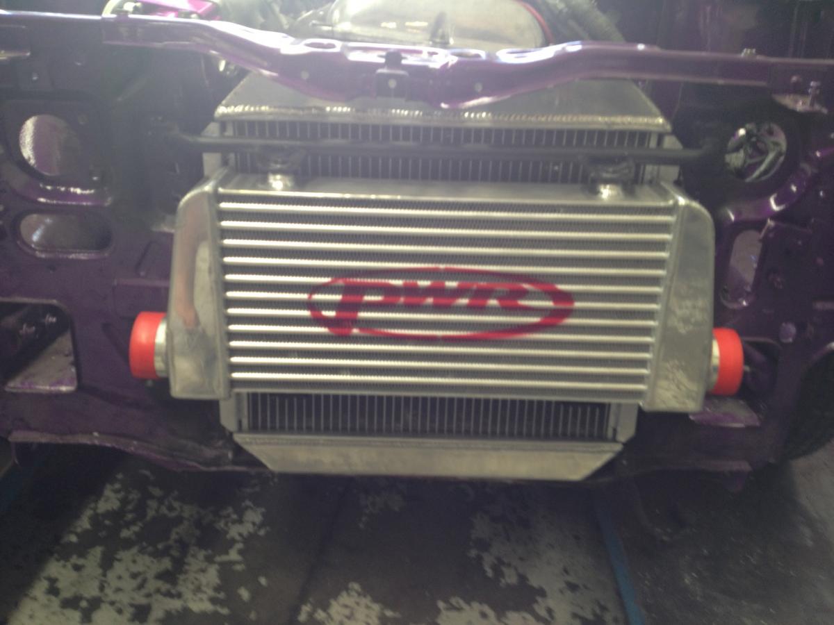

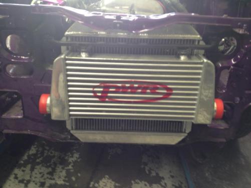

Custom made Pwr intercooler came today :)

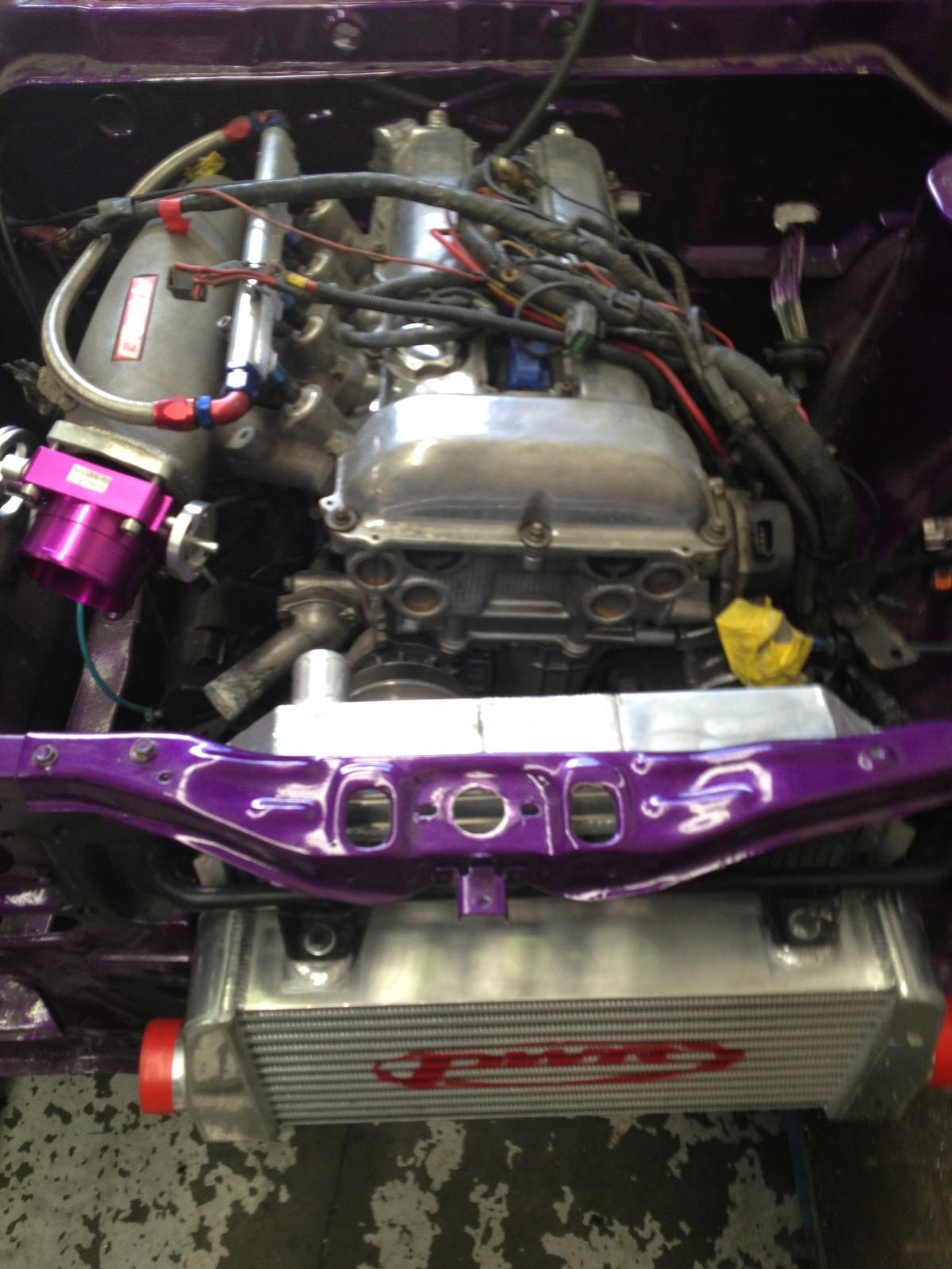

Been a wile . Car is getting wired up , powersteerig, new manifold, more braided lines an nice fitting . New gearbox tunel made . And plenty more done to it . After I get it back only got to put in a wiwoosd pedal box in and get it tuned on methanol and she shud be right to drive . Ooo I'm hangin for it .......

so another update ..plenty more been done :)

looking good mate, will you be able to get the grill over that Intercooler? please tell me your not going to cut a great big hole out of the grill/bumper to accomidate it?

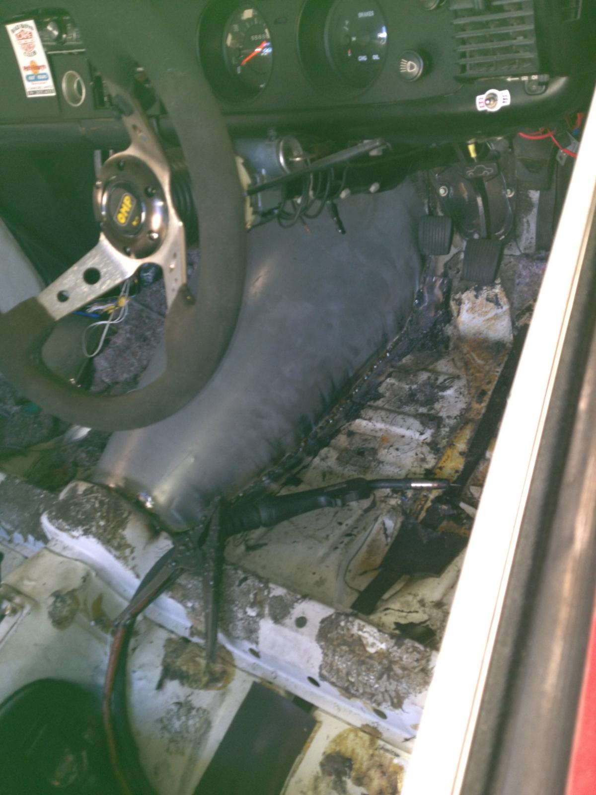

Wiring hardness is done . Just have to wire up the computer . the wildwood pedal box and remote masters . And the throttle position sensor. And finally to paint it ....
Yea the front apron should fit . But the front bumper may need to be remounted but will still sit in the same place looks wise

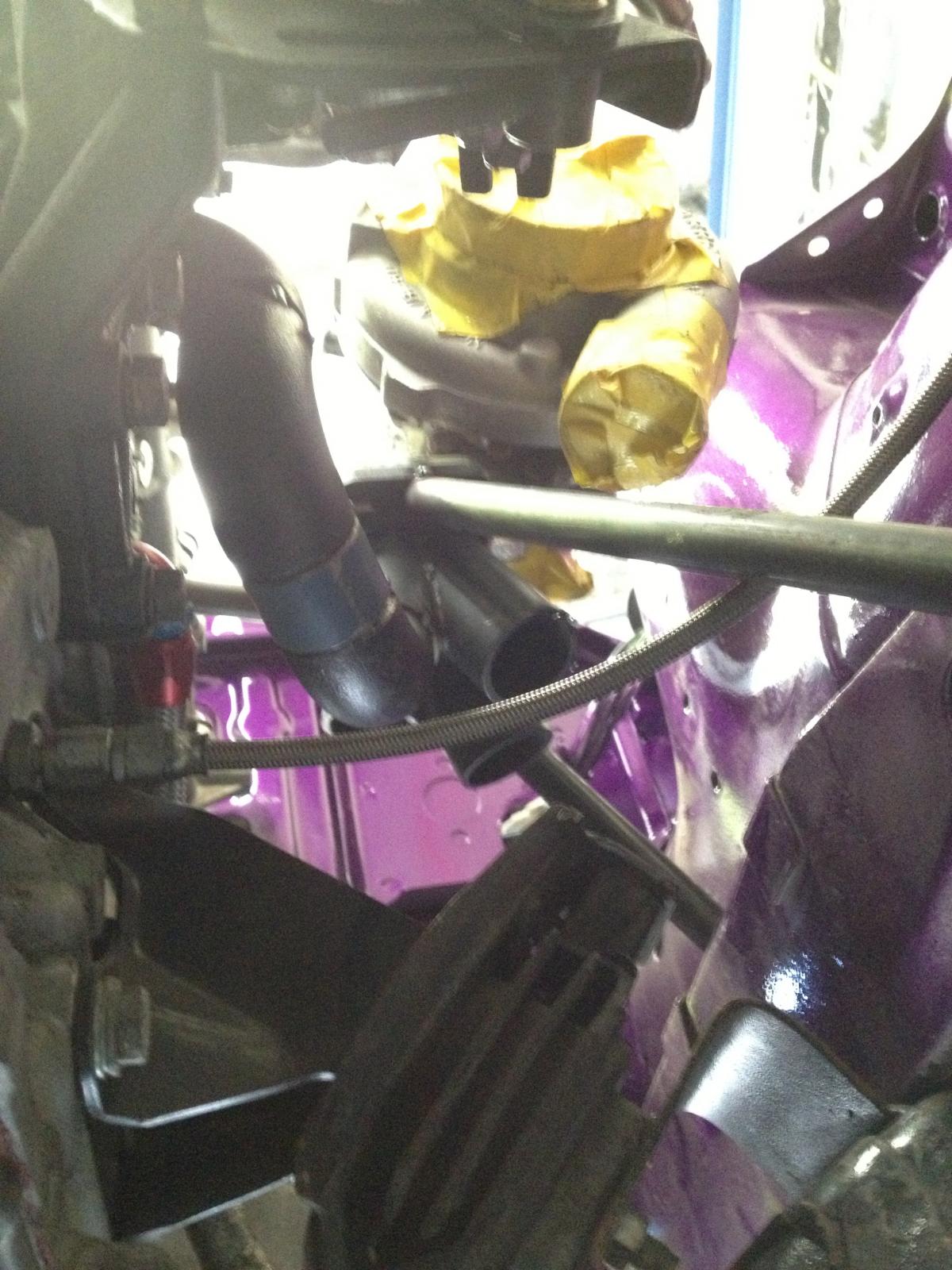

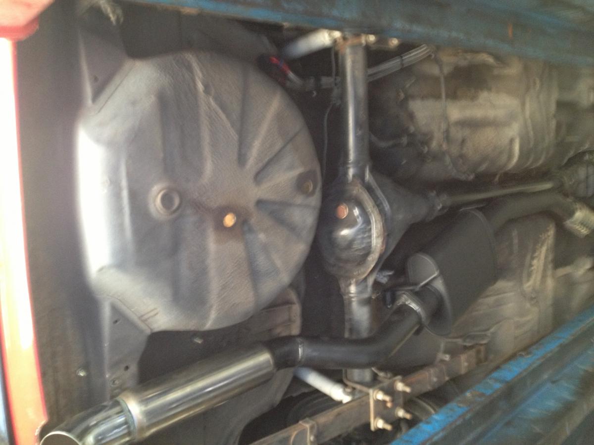

Exhaust, diff tailshaft and braided fuel lines
Edited by flawless-paint
firstly, this car is awesome.
Will this be engineered? If so, you might wanna check if running braids under the car is ok…last I remember it's not ok.
