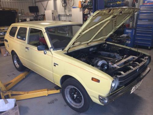

Getting closer should have gearbox back this week and can put the engine in and start to make pipework for turbo
looking great mate..!
can't wait to see this thing in person

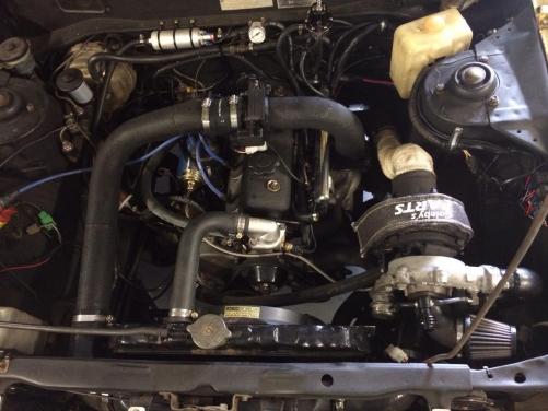

motor and gearbox is in, will be interesting to see how the convertor works. not to many people have done a histall convertor for a 1.3 with boost and large camshaft lol
haha nice mate..!
that carby hat looks secksee..!
what brand stall is that mate?
and good to see you also run powerade in your autos
MORE POWA!!
:-P
haha nice mate..!
MORE POWA!!
:-P
its a gilroys gearbox and convertor, the convertor should be around 3500rpm and has a full manual valve body and heaps more clutches than standard so should be good
