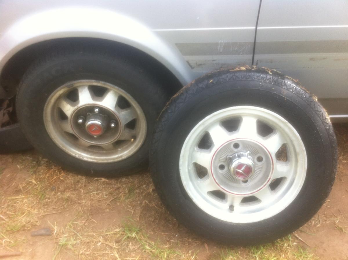

Gave sodablasting a go with a $30 sandblaster. this is 1 kilo of bicarb:
Compared to the old wheel:
Pretty cool I think. The wheel is even shinier IRL. Need to get a rear pair of alloys and do the same thing :)

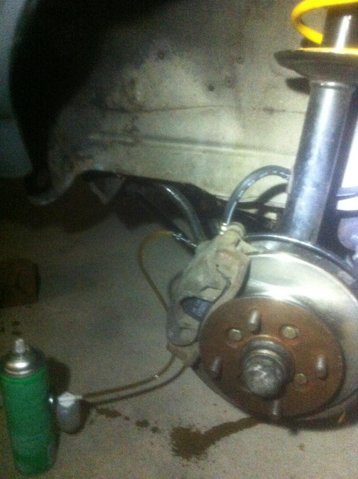

Had some slight issues with my brakes:
Turns out the pads seized in the grooves. A little copper eze sorted that out.

Had the brake issue AGAIN tonight after a spirited drive. Lucky for me, I had tools so I was able to fix it to get home (cool off and a quick sand of the pads)
Basically, the brake pedal feels much harder and the car brakes on its own before halting altogether. I've read in another thread that it could be a number of problems.
Probably going to strip the calipers down and see whats up.
Not going to rule out the master cylinder either being the problem.

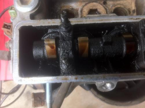

Had to grease the lobes in the distributor after cleaning it a while back due to screeching, awful noise. Didn't even know they needed grease (apparently, the Internet thinks so).
