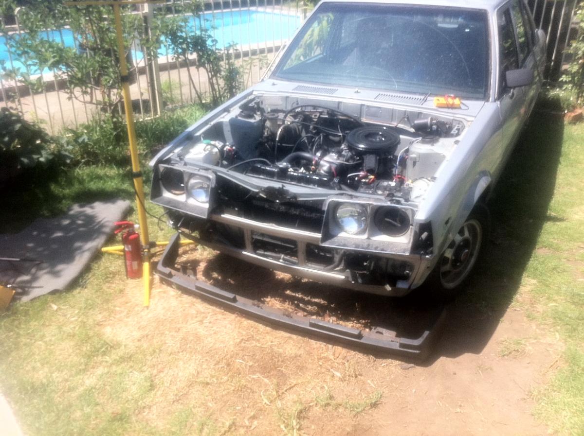

So uh, this happened today:
Bought them (the quads) veeery cheaply. Came off an RA40 celica. Might try to make them fit later with some different surrounds, or cut out the beaver panel to make them fit.
Curious to hear what people think. I really don't want to spend stupid money on quadlights, frankly the $500 or whatever people spend on them these days for JDM points is pretty meh for me.
Clear semi sealed lights (7x5) are on the way, bought a replacement indicator multiswitch thing and a driver sunvisor.

Nice idea! Can you just trim the plastic of the Celica surround to fit?
