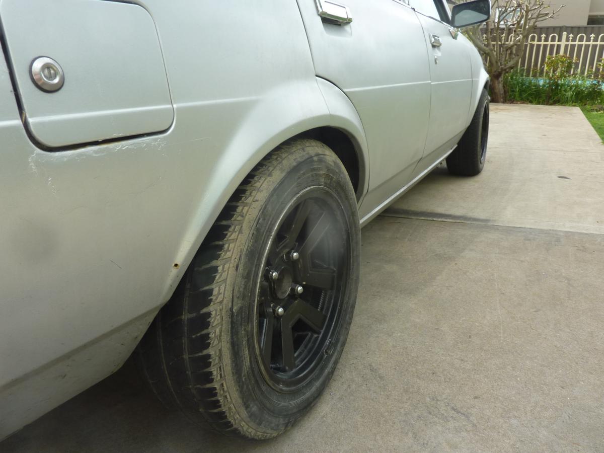

  2. Bought some MA61's the other day as I was getting real tired of how my car handled in the wet with the pizza cutter CSX alloys. Rear tyres are borked and am looking at options. Seems like theres not much in 195/60/R14. Might give the used tyre place a buzz. Fronts are 185/60/R14 Pirelli P6's (?) and handle well in the wet. Looks way, way better now. Fog lights were NOS Mazda items I picked up at Cashies for $20.

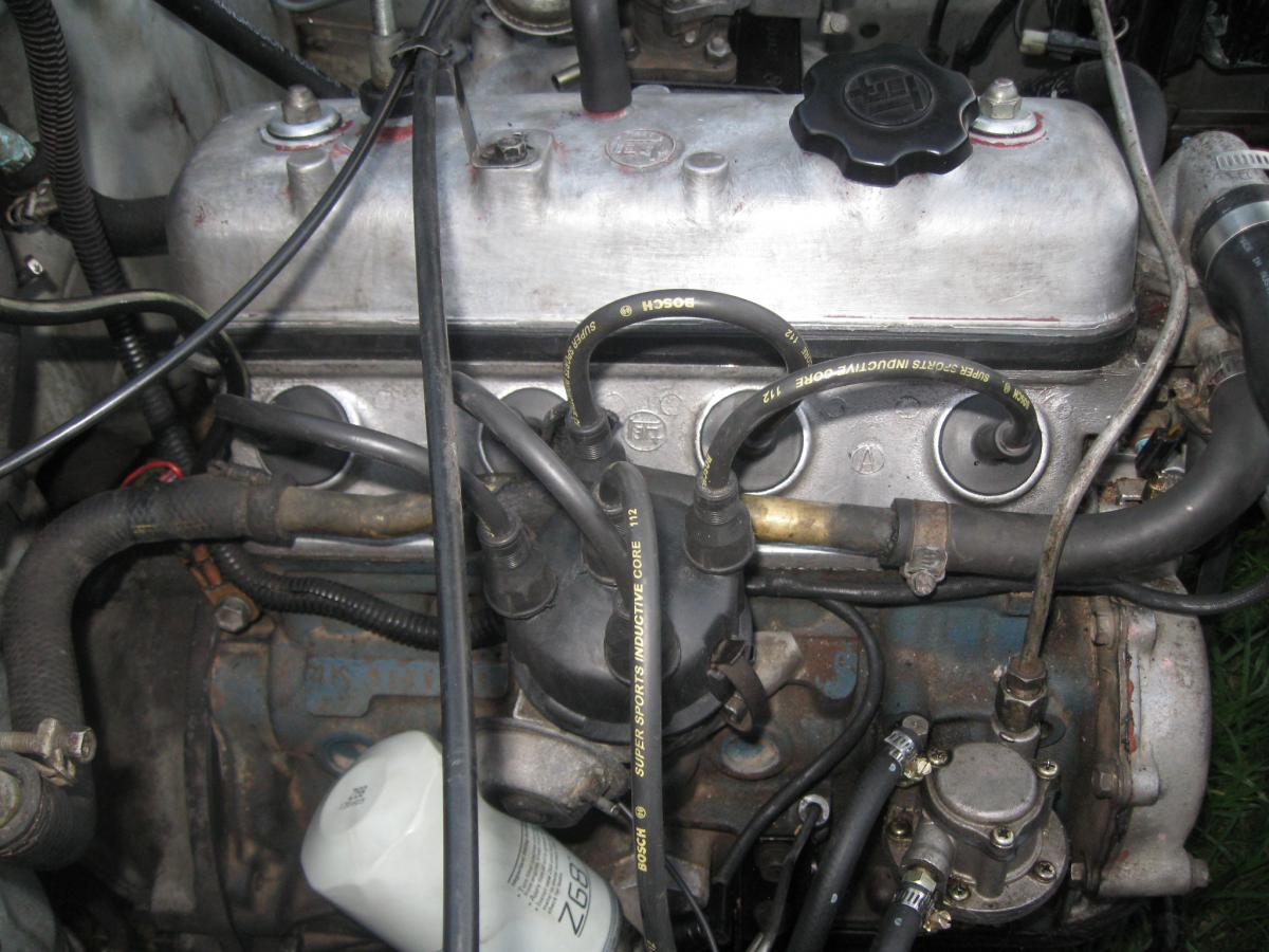

  4. 3 months later update: Starter motor went kaput and I had to replace it. Took a bus/train to u-pull-it out of desperation to get another. Had to grease the lobes in the distributor after cleaning it a while back due to screeching, awful noise. Didn't even know they needed grease (apparently, the Internet thinks so). Otherwise, pretty sweet. Roof racks have come in handy numerous times, especially after buying this: Turns out a slant front fits into an empty KE, minus the bumper. Bought all this just in case, the seller was like "you've already got the good front!" Indeed. Here's some photos comparing the RA40 lights I have versus the slanty front ones. I've included a square in case anyone wants to extrapolate dimensions: Also fitted RA40 suspension arms as they are exactly the same as the XT130 arms. Really improved steering and feel, totally recommended (although I'm probably preaching to the converted here...) Did some reorganising of the shed(s) as well, these $15 shelves are nastier than cheap PC cases but surprisingly strong if assembled correctly: Otherwise, nothing. Planning on getting camber tops and 15x8 steelies as I'm sick of takumi tax on wheels and the lack of traction I get with the stock skinny tyres in the wet. Also so I can use the grimy crusty 15" bald-as-ʞ©$ɟ tyres sitting outside for drift/whatever. Yay for daily:

  19. Bought a 12" thermo fan kit and stuff for h4 relay conversion: Both of my engine fans had the clutches welded shut so I decided I'd swap for this. Bought new plugs, fixed up the vacuum leaks and did the lean drop method of getting the idle right. Used to only run on 3 cylinders on idle, now runs real smooth. Thermo fan is keeping things very cool (at least for now). Clutch still doesn't disengage which is a PITA. I've seen people use a spacer where the cable goes through the bellhousing so I might try that. Pretty happy with the compression too (this is on all cylinders): Not really sure if this gauge is accurate, but it read 90psi on one of my g11 charades cylinders so I dunno. Seems a bit high for a 4K!

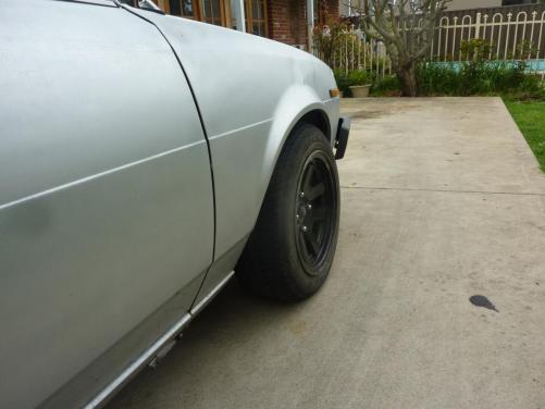

  24. Well, things have been progressing slowly. I got a full set of king lowered springs (30mm) and cleaned and refilled the front shocks. Front suspension has been tidied up a bit too and i finally got those darn front LCA bushes in, as well as the strut bars and the swaybar. Now that I've gotten most of the back suspension out, I've gotten stuck with this charming fellow: Yeah, yeah, oh the horror! I've thrown pretty much everything at it - impact on a swivel, breaker bar, heat, grinder etc. I even went out and bought an air saw to try and get in there and cut the bolt inside the mount - nope. I have a feeling the crush tube has rusted to the screw and is making things difficult (on both sides too!). I sprayed some Inox into the mount and around the screw for now (seems like multispray did nothing). Everything else came off fine with the rattle gun! :( Also stuck with a rack bushing (the D one) that doesn't quite fit around the aluminium mount on the rack itself. Seems too wide or something as it doesn't quite wrap around all the way.
