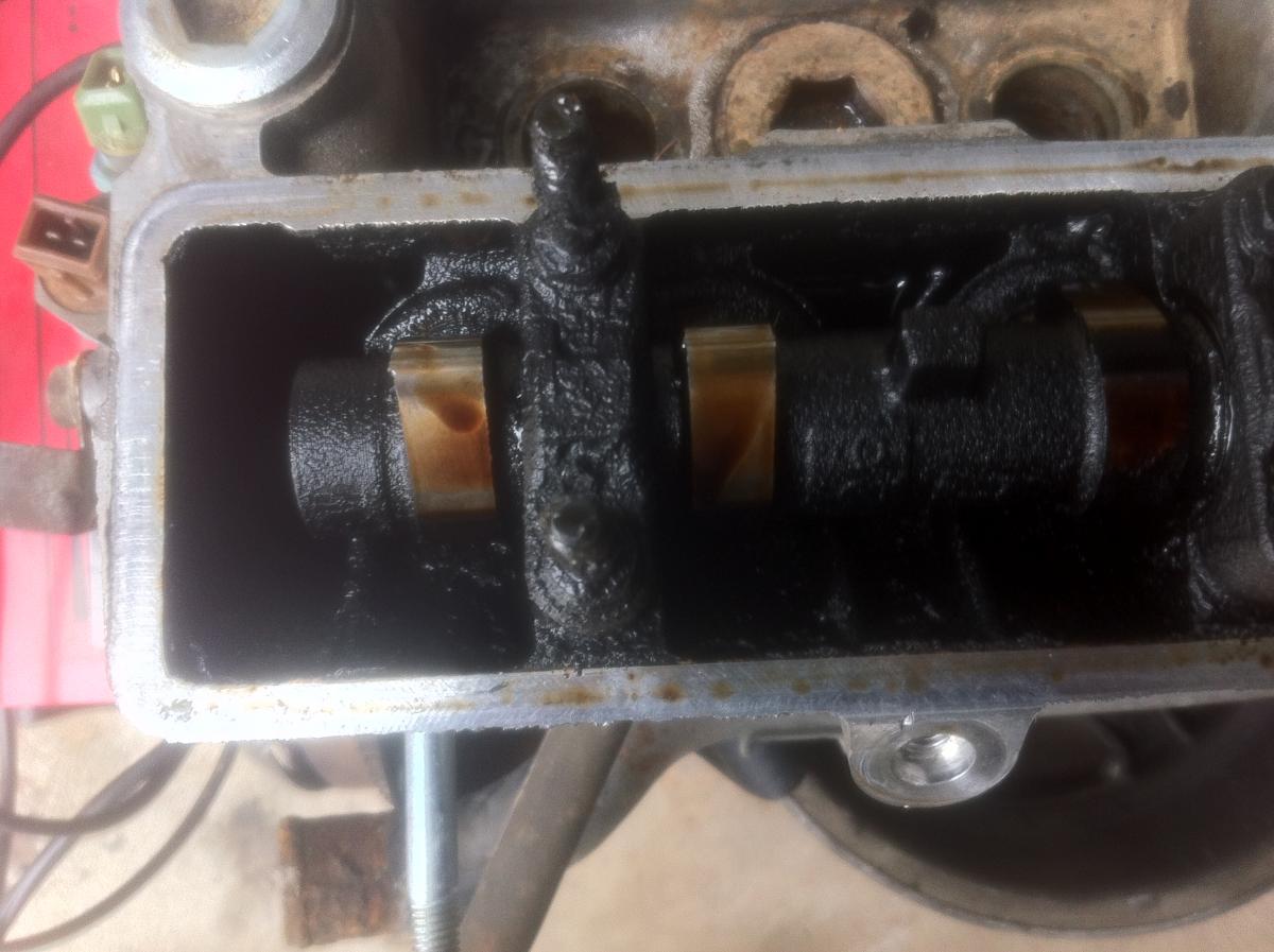

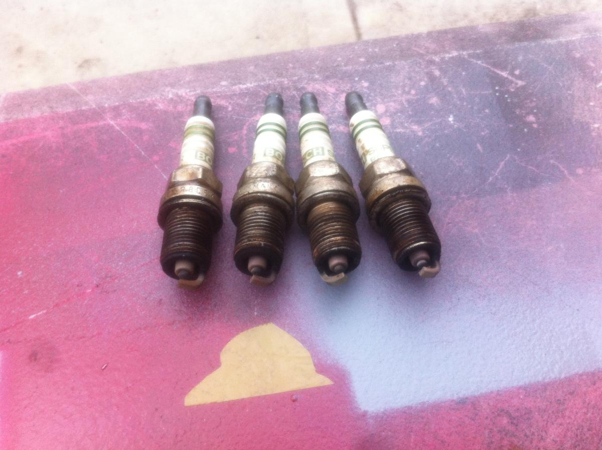

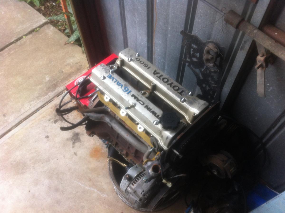

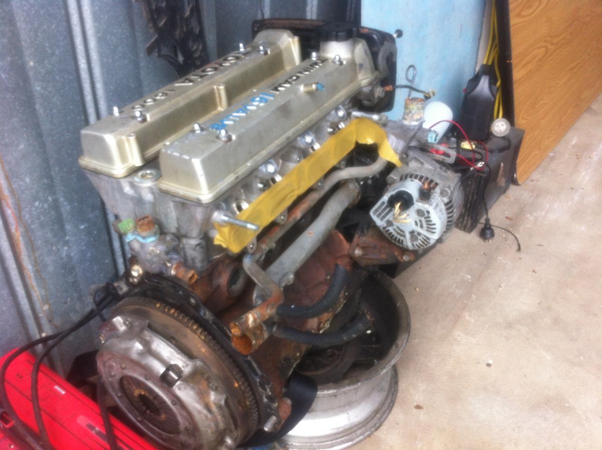

  1. Picked up this wheel the other day for $28. Feels much more solid than the crusty sports wheel I had. Also picked up a bigport 4age out of an AE82 (late to the 4age game much?) Spent two(!) days with a mate taking it out and getting it home. Took the inlet manifold, ECU, igniter/coil, and any sensor I could see. Going back on Wednesday to get the loom. How it got home: How it came out: Took two cans of degreaser and two goes with the pressure washer to get to this: Inlet manifold is saturated with oil but spark plugs look OK: Inside the cam covers look yucky: This will be a back burner project as I get the rest of the parts and do my research on how it all should go together. Got a lot of reading up to do...
