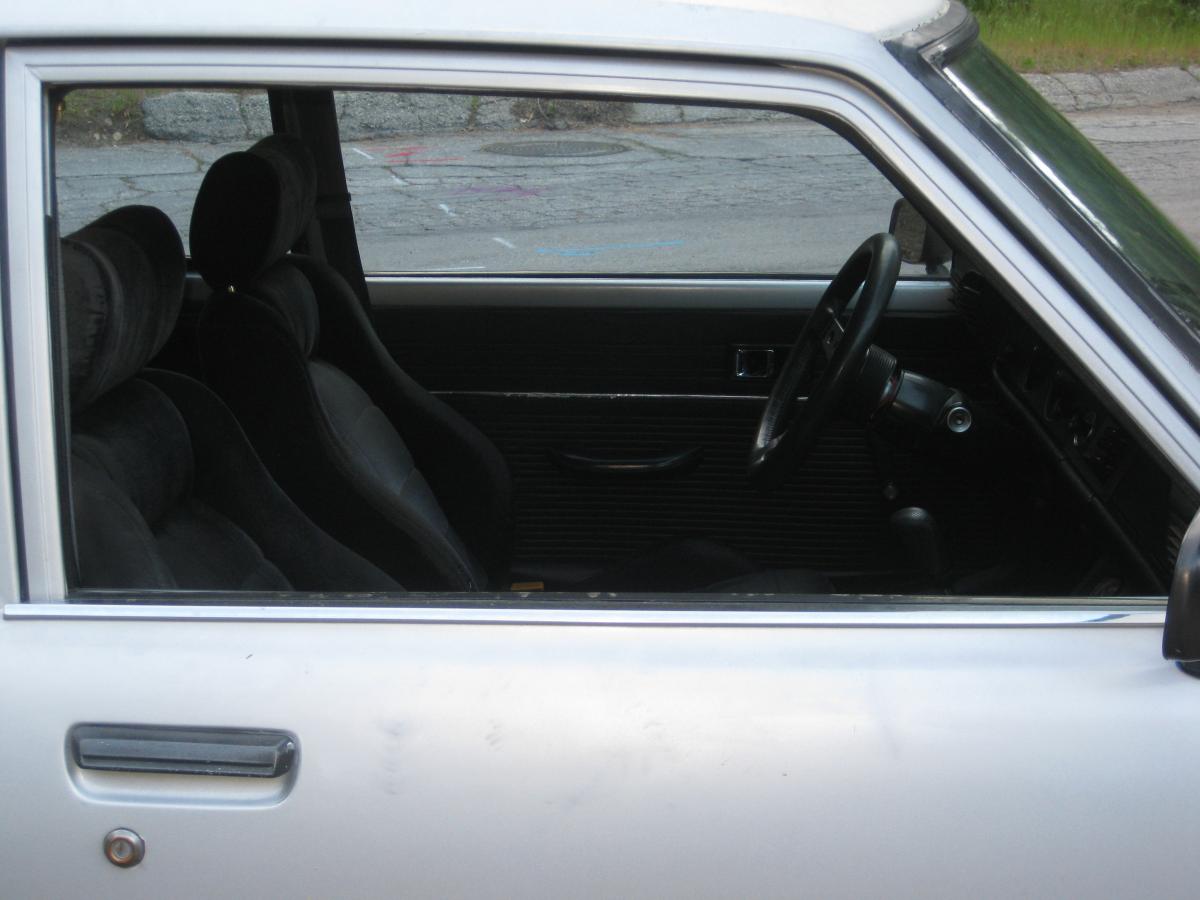

Hello all. I recently bought a 1971 KE20 Corolla 2-door sedan and need help on a few items. I am a novice at this so I would appreciate detailed responses with possibly photos if available. First, I want to lower my car and need to know what size lowering block you guys use, dimensions of the block, what is the size of the pin but also the length and width of the U-bolts. I want to lower the car between 30mm to 40mm. The front springs I want to cut as I am in Los Angeles and there are no part suppliers for these cars and to order from overseas will be very expensive. How much does cutting one coil lower the car? My second issue is it is very difficult to find 4x110pcd wheels. Are there any axles or front hubs that have a 4x114.3 bolt pattern that are a direct replacement? I think 1972 and later used the 4x114,3 but I may be wrong. I would appreciate solid advice from people who have experience rather than people just stating their opinion without knowing for sure. Thank you in advance.

Welcome aboard ! A lovely little KE20 you've scored yourself there ! Looks like it is in remarkable condition, and a good starting point for a refurb.
Has it got much rust in it ? I would love to have started with one of these, but many Ke20/25s in Australia are riddled with "the cancer", and the cost & effort to bring the body back to roadworthy, is prohibitive, unless you are a panel beater by trade, (which I'm not).

Thank you for the kind words. The car is a Southern California car so it is basically rust free. Only minimal surface rust in the spare tire area but I sanded that off and painted it. I look forward to learning from the forum members here as there are only a few of these Ke20 Corollas here in the US and not much interest in them in the local forums.

anyway, nice car! any more photos? do you have a k engine or a T engine?
We at rollaclub love photos, especailly of cars that are a little different to ours.
