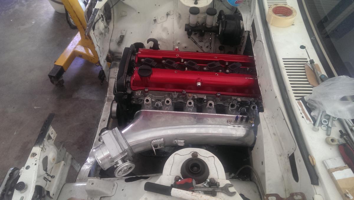

51RJZ Posted November 19, 2013 Author Report Posted November 19, 2013 got abit more done in the last week. bought and fitted a shortened 9'' diff and have made a start on the engine mounts :) Quote

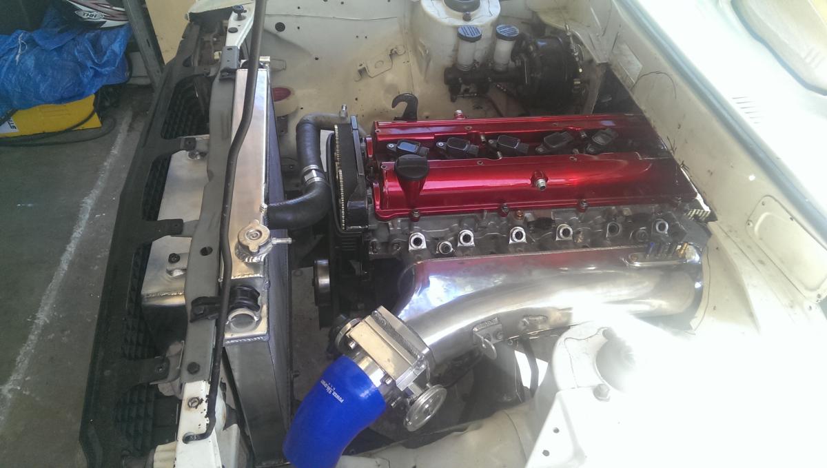

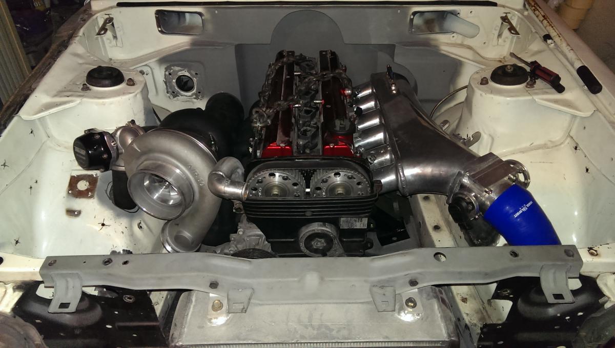

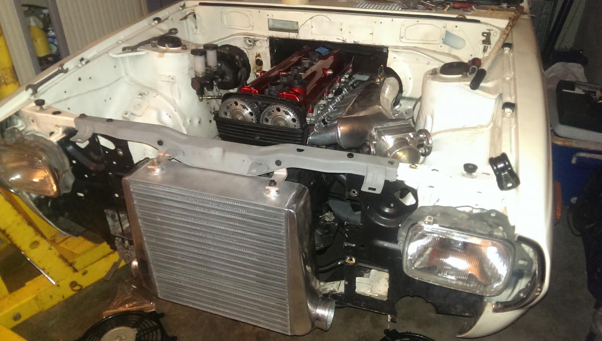

51RJZ Posted December 23, 2013 Author Report Posted December 23, 2013 small update, engine and box is all mounted. and started to fit intercooler. having trouble trying to find a radiator that will sit on top of crossmember but still clear the bonnet. trail fitted the alloy Cressida radiator I had here but not sure if its the best option yet. Quote

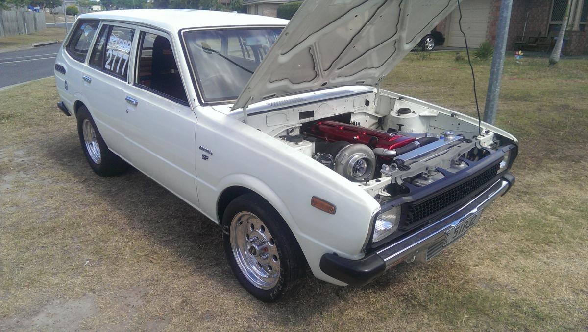

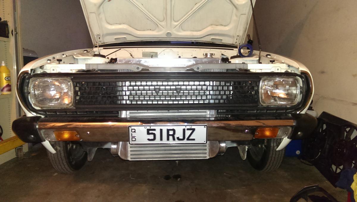

51RJZ Posted January 20, 2014 Author Report Posted January 20, 2014 I've been playing with another toy of late but found some time for the wagon :) been fitting up all the front end to see how it all looks and fits. next week it will be getting my new custom exhaust manifold made, gate mounted and 4" dump pipe. can't wait to have my first drive. Quote

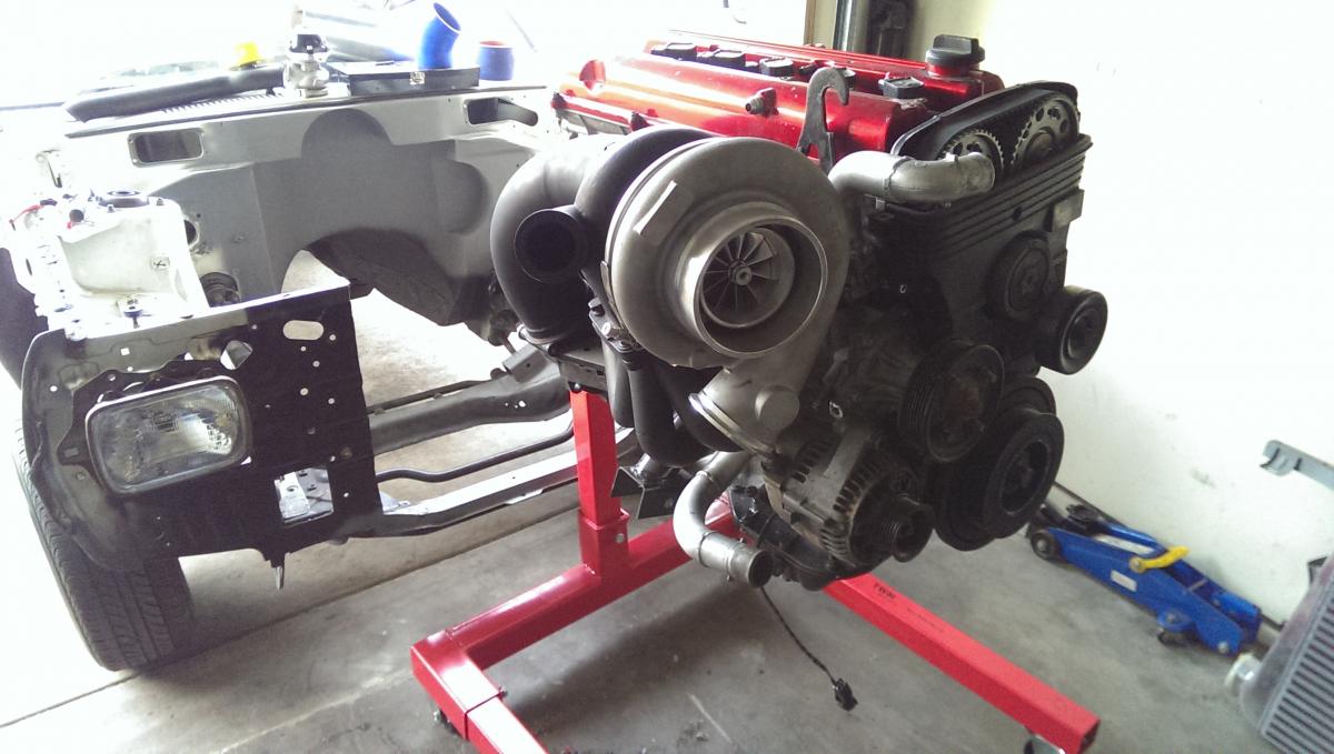

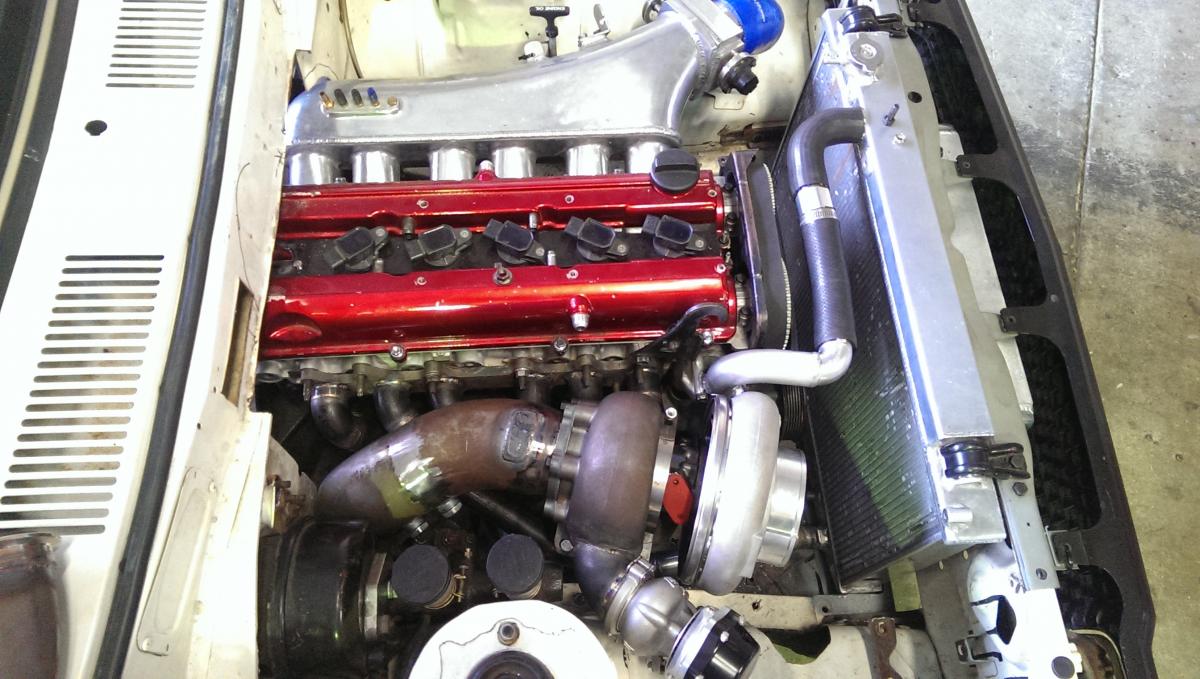

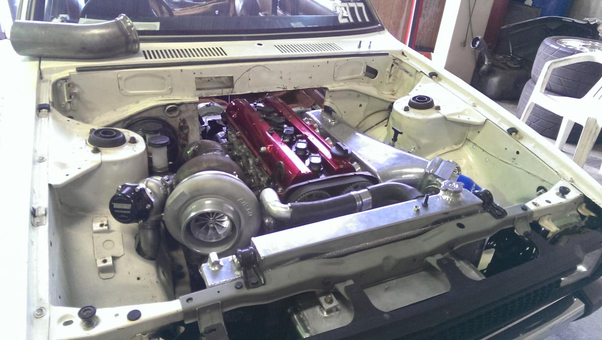

51RJZ Posted February 13, 2014 Author Report Posted February 13, 2014 A little bit more progress with the wagon. steam pipe manifold, 4" dump pipe made. mounted my new external gate off the rear housing off the turbo and screamer pipe done. To make it fit better we modified the top and bottom water hoses to bring the turbo forward enough to fit a 4" dump pipe in. Quote

NZ_Ke30_V8 Posted March 11, 2014 Report Posted March 11, 2014 Hey what radiator did you end up using? Looks like it fits nicely. Nice build. Quote
51RJZ Posted March 12, 2014 Author Report Posted March 12, 2014 Its a mx83 Cressida radiator. I had to modify the bottom radiator surrport to make it fit but yes it fits in quite nicely :) Quote

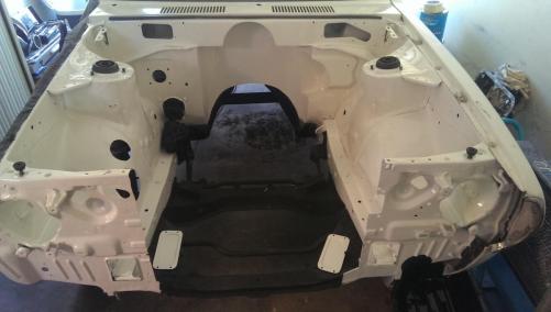

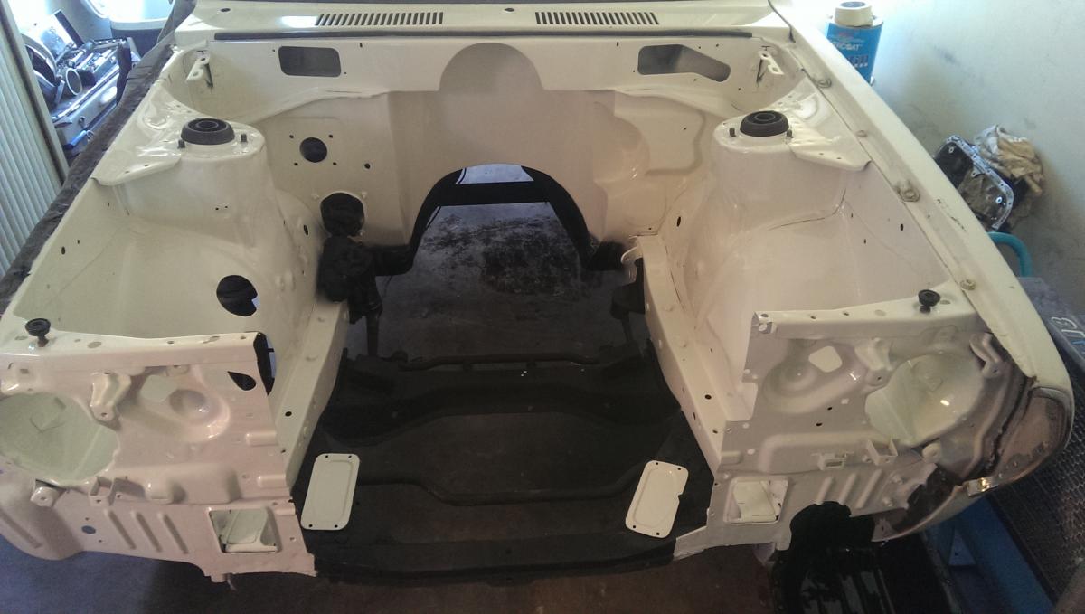

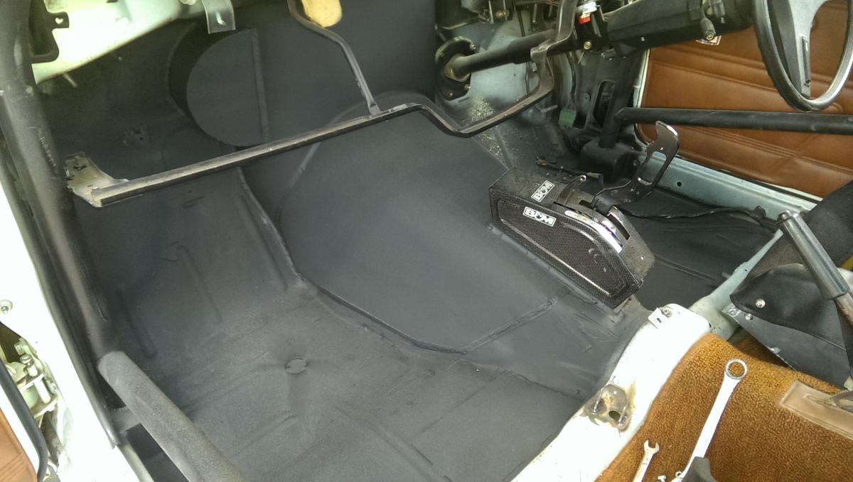

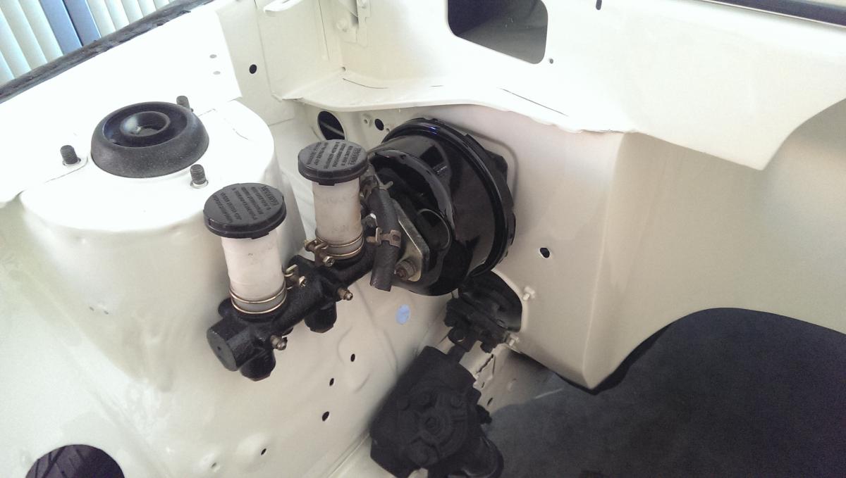

51RJZ Posted April 22, 2014 Author Report Posted April 22, 2014 Ive gotten abit more done on it lately. fabbed up a new tunnel and firewall. also ordered the bends to make the intercooler piping then its time to lick some paint in the engine bay :) 1 Quote
Doogs Posted April 23, 2014 Report Posted April 23, 2014 Awesome, that firewall work is pretty full on! Quote
51RJZ Posted April 27, 2014 Author Report Posted April 27, 2014 yeah took abit of work but got there in the end. I'm hoping you mean full on in a good way lol. Quote
Doogs Posted April 28, 2014 Report Posted April 28, 2014 yeah took abit of work but got there in the end. I'm hoping you mean full on in a good way lol. Yeah mate, I'm in awe :y: ETA on turning the key? Quote
