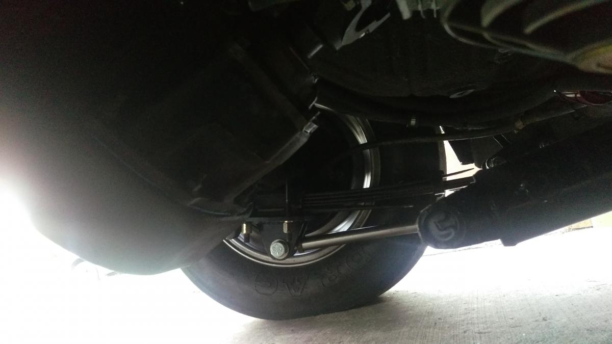

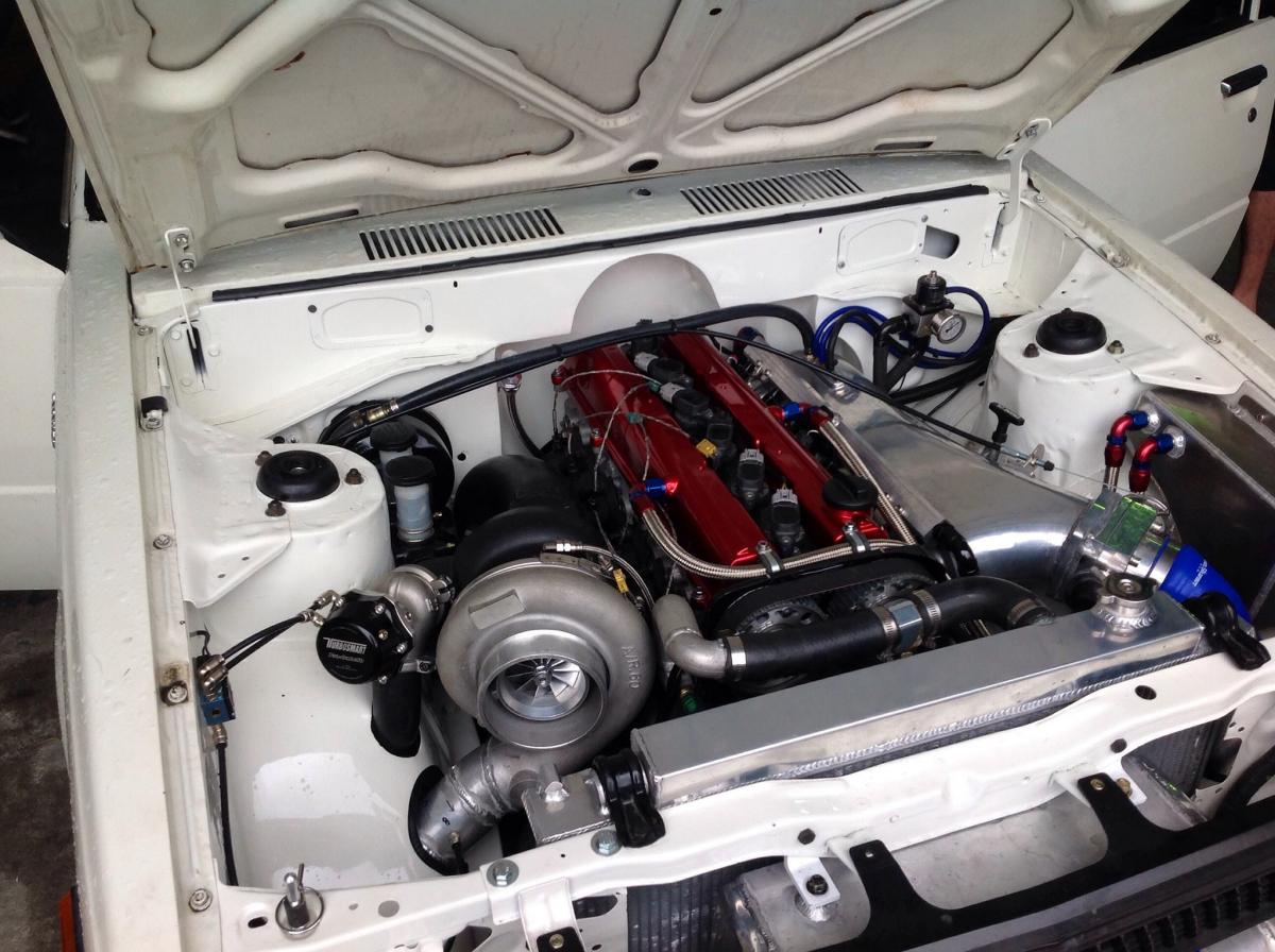

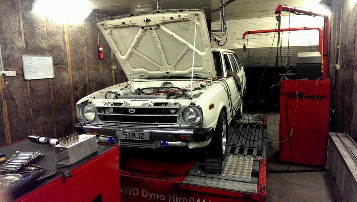

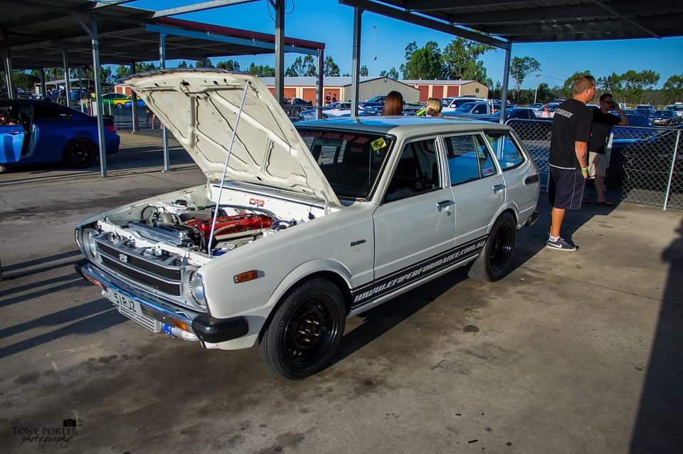

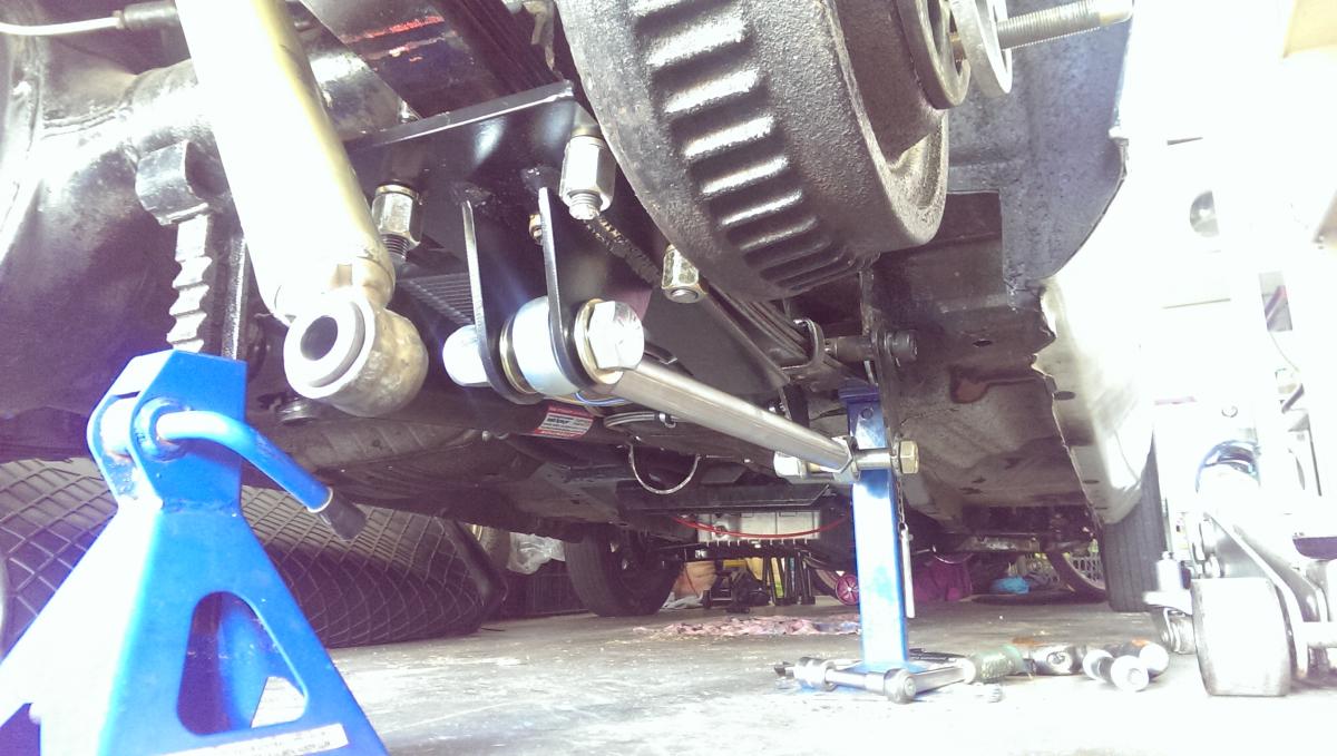

Been a while since i last updated. I managed to get the car to jamboree last year for its first outting and in the end it did abit of damage to the rear end. bent the leaf springs, put the yoke/tailsharft into the floor etc. so ive been busy replacing a few things under the rear and made up my own caltrac's to help with pinion angle etc. also had the car on the dyno thursday to sort out a couple off issues that i had. managed to come home with 702rwhp so this should make for an interesting ride next time i head out. anyway here is a couple of pics anyway.

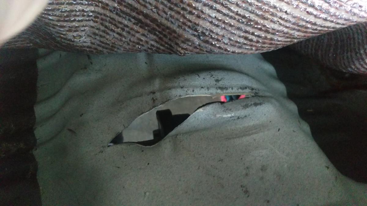

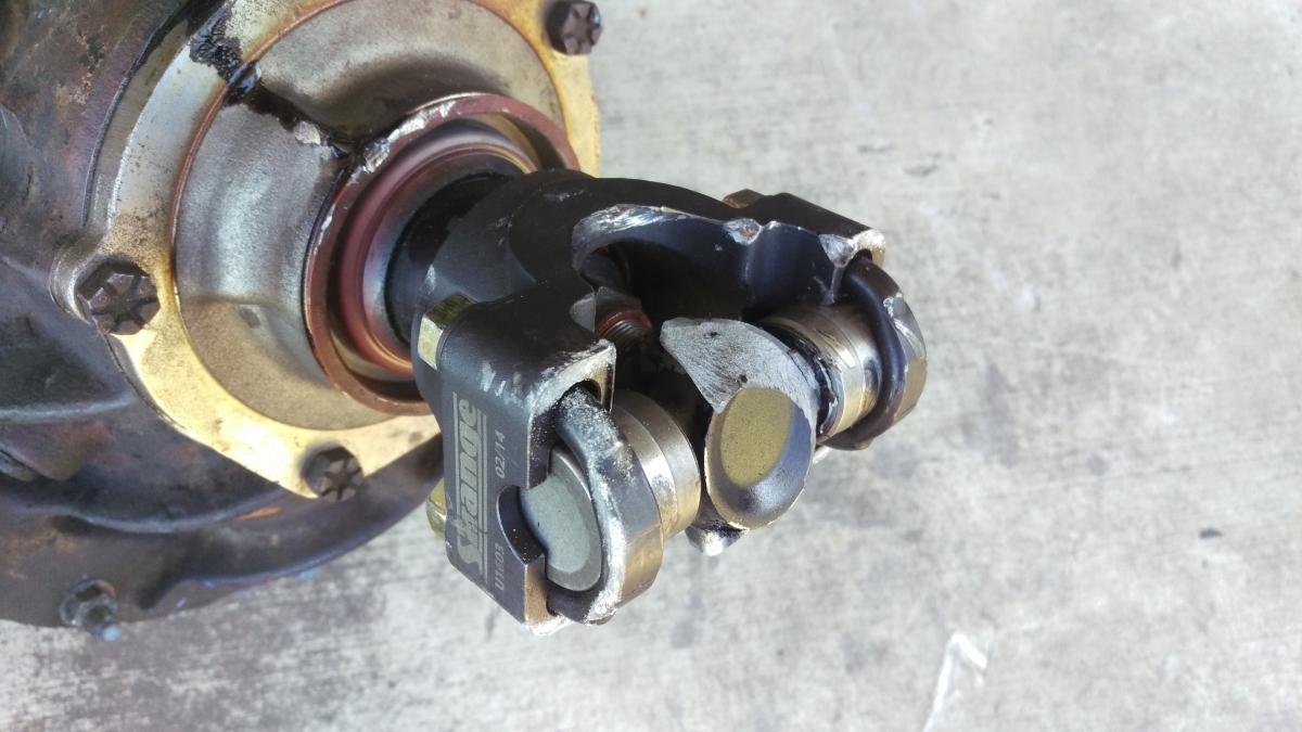

So I wasn't so lucky at the track wednesday night. I twisted the diff mounts, broke tailshaft and cracked the back of my box. Oh well ill just have to fix it and try again.
Nope, caltrac's actually did what it was ment to but coming off the transbrake with such force it made the saddles on the diff collapse so it rolled the diff which then did all the other damage. Oh well time to make it stronger :)
I've only done one pass in it and it wasn't making full power on that run. Went 10.3@130. I'm expecting at least a low 9 at around 150mph once I get this power down without breaking anything. Hopefully won't be out of action for to long.

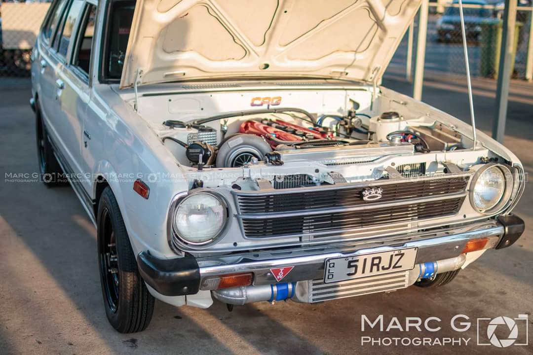

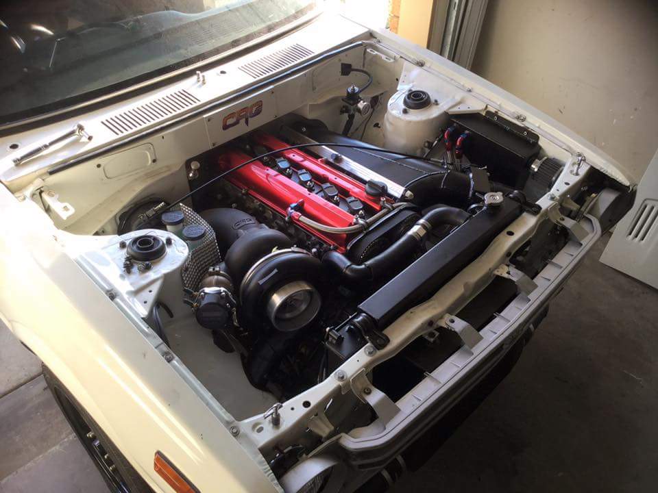

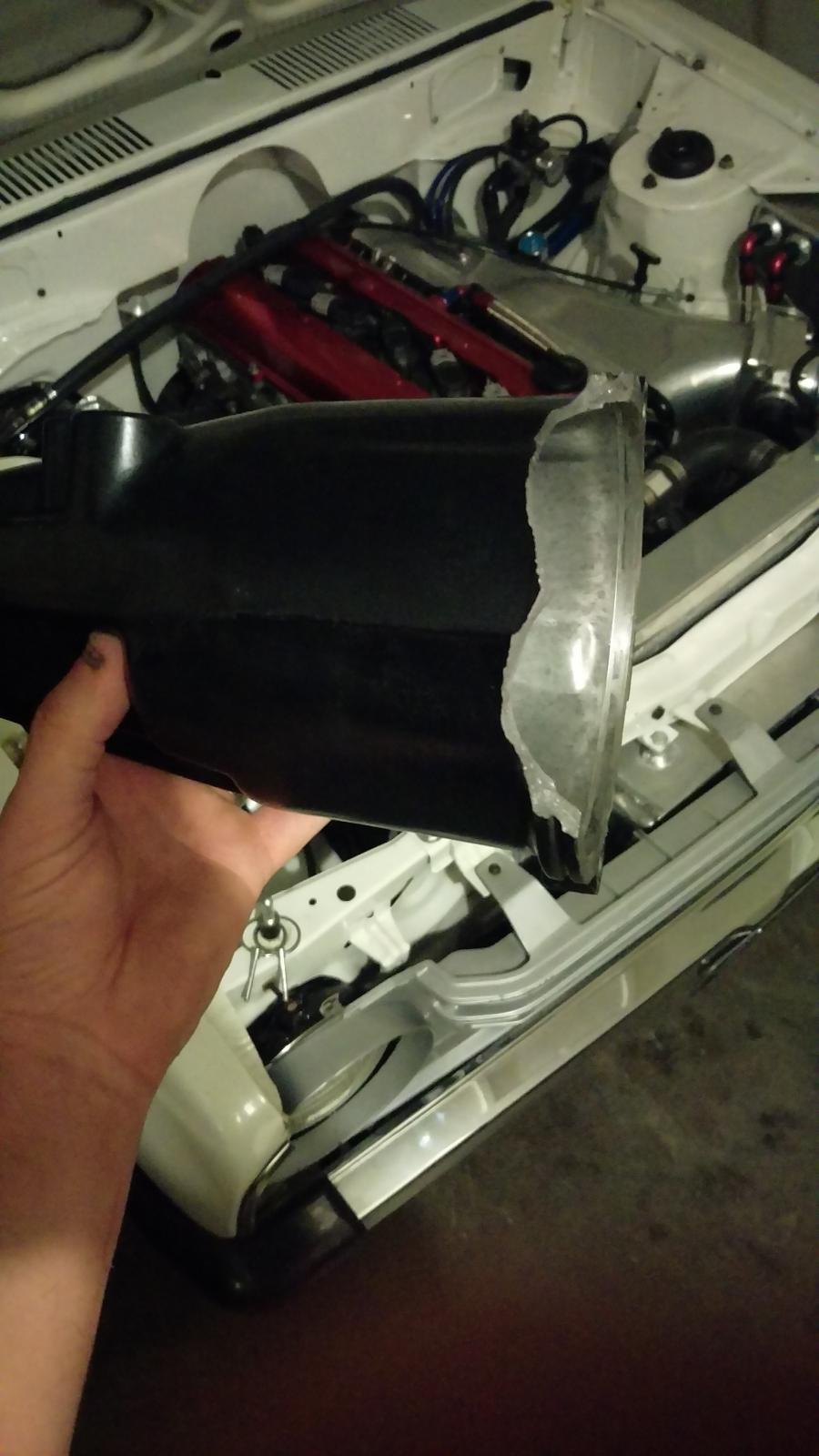

Been a while since I've been on here. Had abit of a ruff 12-18months with this thing so it's kinda been on the back burner. Few things have changed, new ecu going in, custom intake manifold has been made, replaced all the rear I broken from its last attempt at a pass etc. Looking for reliability more so now then out right power. Here is a few more recent pics for those who don't follow my facebook page
