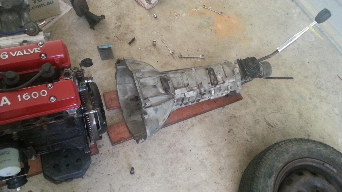

I just tried to mount the 4AGE to a T50 box. Only the two top bolt holes line up with those on the engine. Also there is a pin that lines up the engine, but the hole for that pin on the gearbox is on the opposite side.
Is this a JDM/ADM issue? I know they differ by having the clutch fork on the other side, but I was told that any T50 box will fit as long as the splines are the same.
Will a different bell housing fix this problem?
Any advice is greatly appreciated!
Thanks!
That seems right... If only it wasn't so hard to find A-series bell housings :bash:
