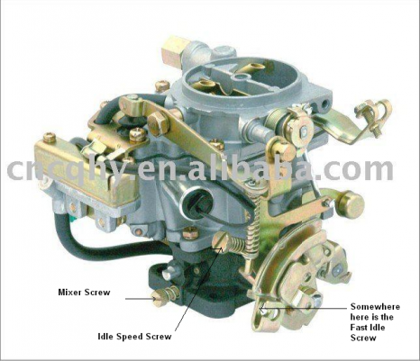

I've started another topic because I've created another issue. Though someone may know how to do this properly. I was playing around with my idle and mixer screw on my carby today as I've messed things up in the past. I'm not 100% sure what I'm doing. I have a small bump at low RPMs, and I think I created it by messing with these screws. I realize this could be a myriad of things but I'd like to focus on this for now.
On my 4KC carburetor there are three screws. A Fast Idle Screw andIdle Speed Screw and a Mixer Screw. (Photo below, couldn't find a better diagram).
How do I coordinate the adjustment of these three screws to set these correctly. Where should the idle be when setting the mixer screw for example? What do I do with the Fast Idle Screw? etc. etc.
Edited by abatom
I think one will be idle when the choke is on, but I gave my stock carb away years ago....
So one idle speed screw should screw onto a choke quadrant, and gives you idle when the choke is on.
The other idle screw will push on the body and give you idle when warm.
With the car warmed up, set the idle when you want it, say 700rpm. Screw the mixture in and out in half-turn lots until you get the fastest idle speed. Then re-adjust the idle with the idle speed screw. Then you can play with the mixture in 1/4 turns to get it how you want it.
If you screw the mixture right in then take it out one & 1/2 turns that will be a good starting point.
