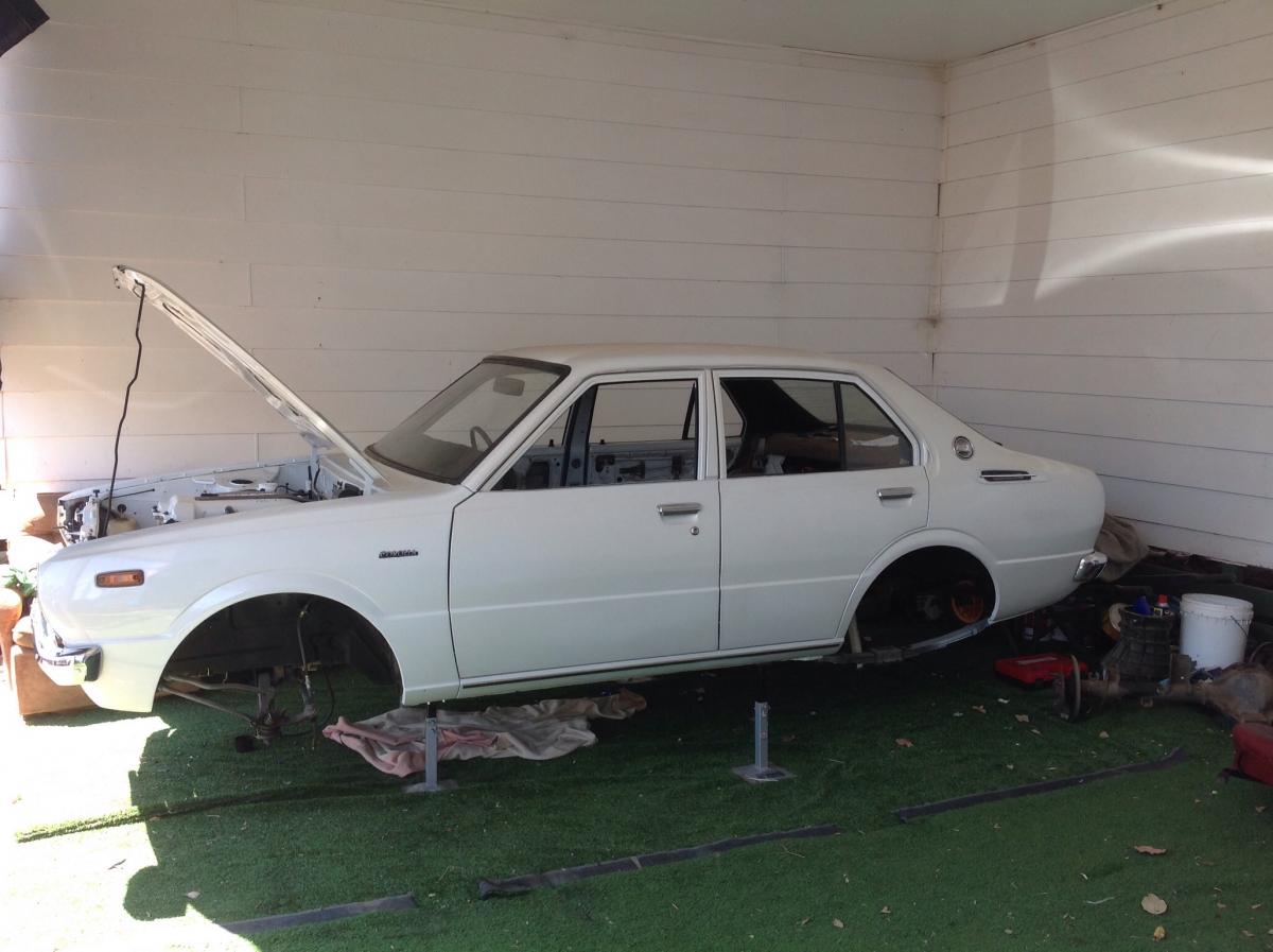

I'm new to the forum. Thought I would post up how I'm tracking with my wee project and hopefully get a few tips along the way!!
Current stage:
Engines/gearbox in, diffs in, wirings complete, yeah engine runs!! Suspensions in, fuel systems in and she's all painted.
Currently working on brakes and wheels then finally exhaust to finish up.
The engines out of a S15 silvia with the R32 turbo box with sr20 bellhousing.
Diffs out of the nissan pintara, shortened and bolted in (only brake lines and handbrake to mount up).
Front brakes I have gone with the U13 bluebird front rotors and rx7 s4 callipers. Having trouble finding wheels that will fit with enough clearance between the mounting face and calliper (35-40mm). Am now looking at sourcing a rotor that bolts behind the hub face, similar to factory, thus pushing the calliper away from the mounting face so my wheels will fit :)
Heaps of other bits and pieces in and around the car.
Few photos below..

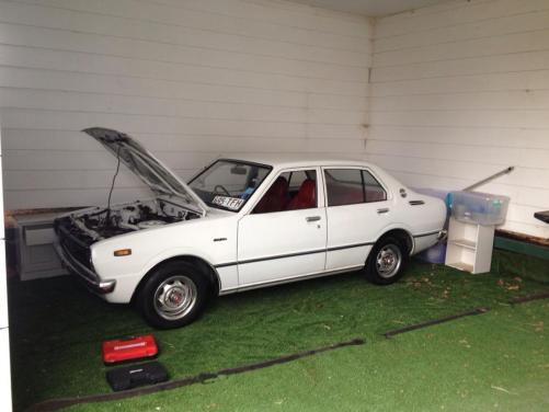

Can I say 2-3 months?? I've made a few phone calls about wheels hence why my front brakes are now up in the air.. Once that's sorted it's off for the exhaust then down on the Dyno for a tune.
Does anyone know the legality of machining the brake rotors I currently have (slip over hub) so that they bolt to the back of the hub ( similar to factory)?? This should push the rotor and calliper an inch or so further back from the wheel mounting face :)
Edited by SR30
You can have rotors machined but only within reason. Not too much can be removed from them. Hub mounting face can be cut down, diameter can be reduced, disc face can be done slightly and hub bore can be taken out a few mm. Just contact a machine shop and see what they are happy to do for you.
