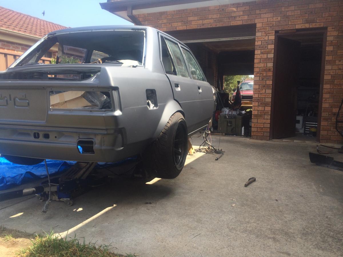

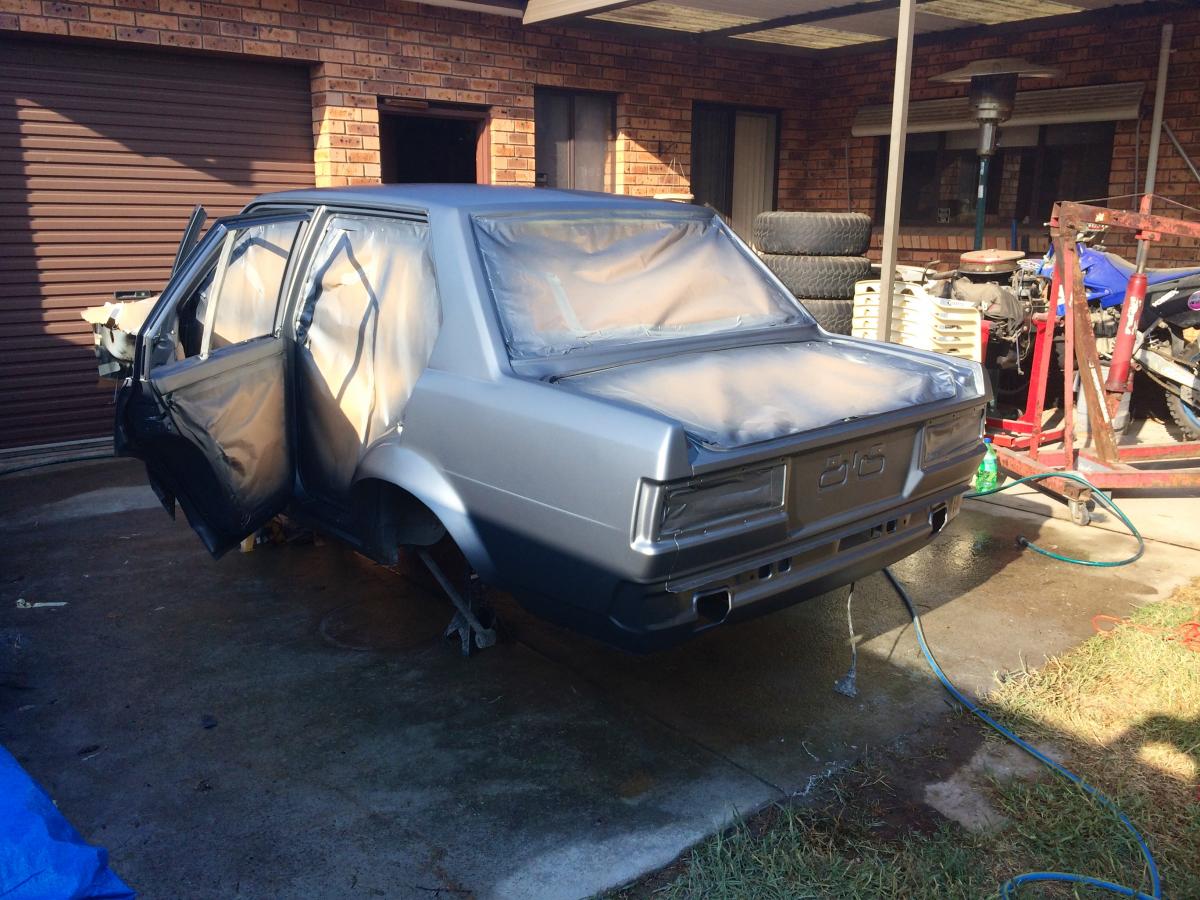

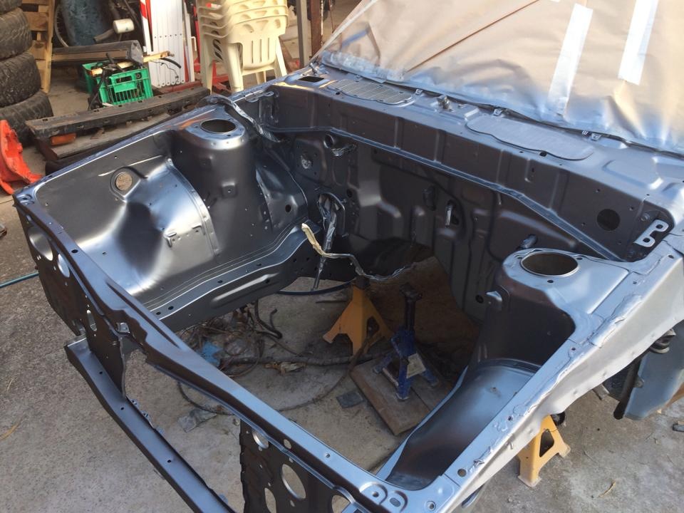

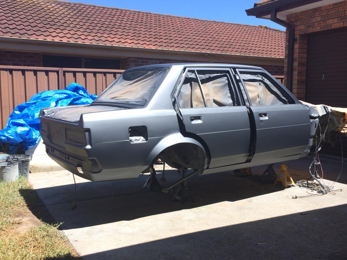

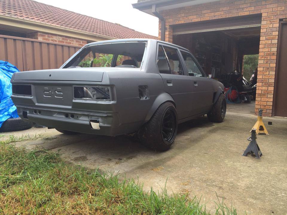

    then it was time to cut all tha rust out & i do mean all of it & there was & there was a HEAP more then i thought there was but its all gone now & it isnt coming back anytime soon
  • fatroll 20
    fatroll 20

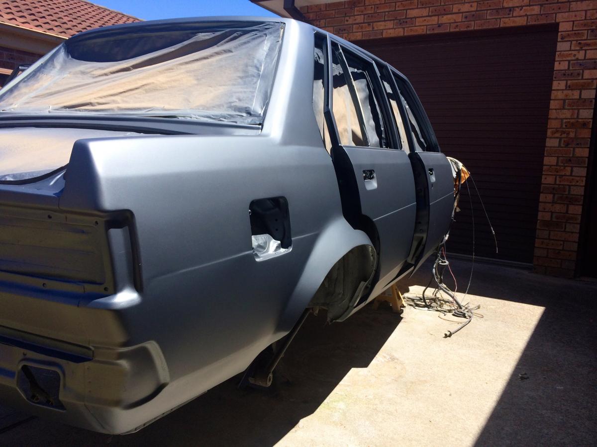

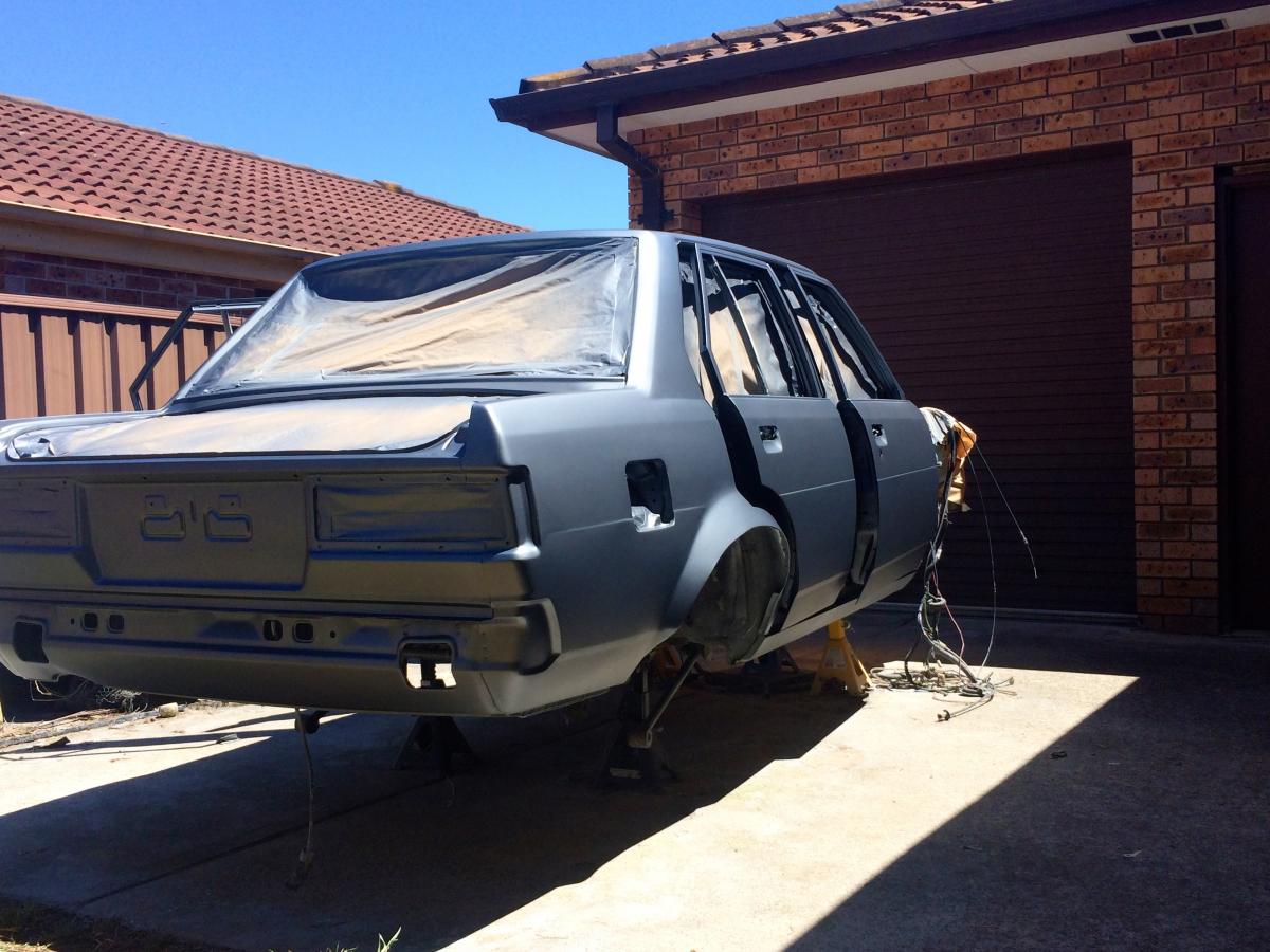

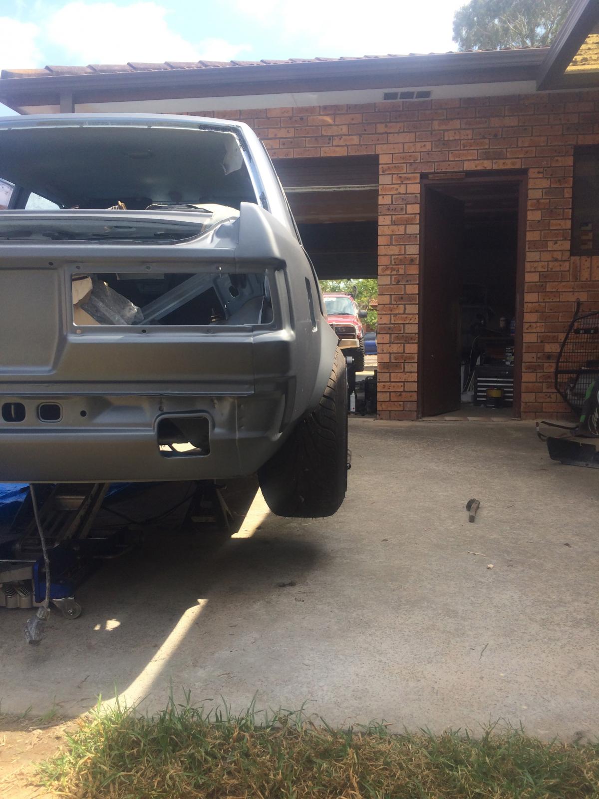

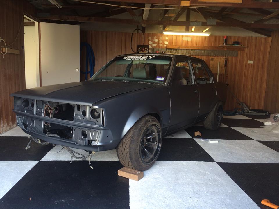

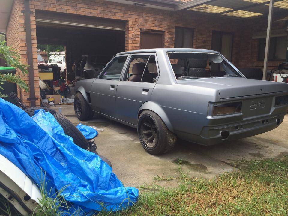

    then was time to make tha beast smooth so i welded tha front guard blinkers & quarter mould vents which makes tha car a lot cleaner i think

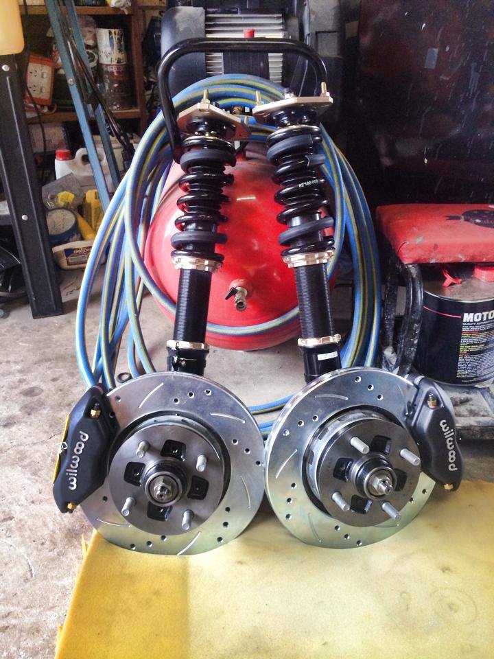

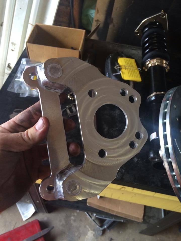

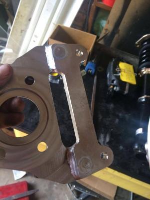

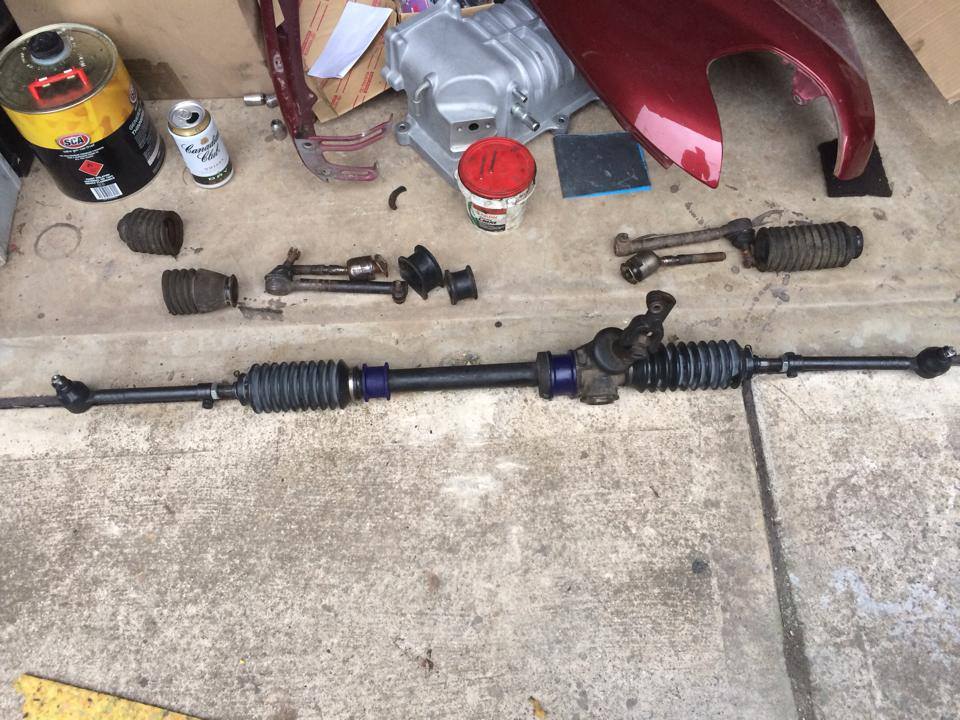

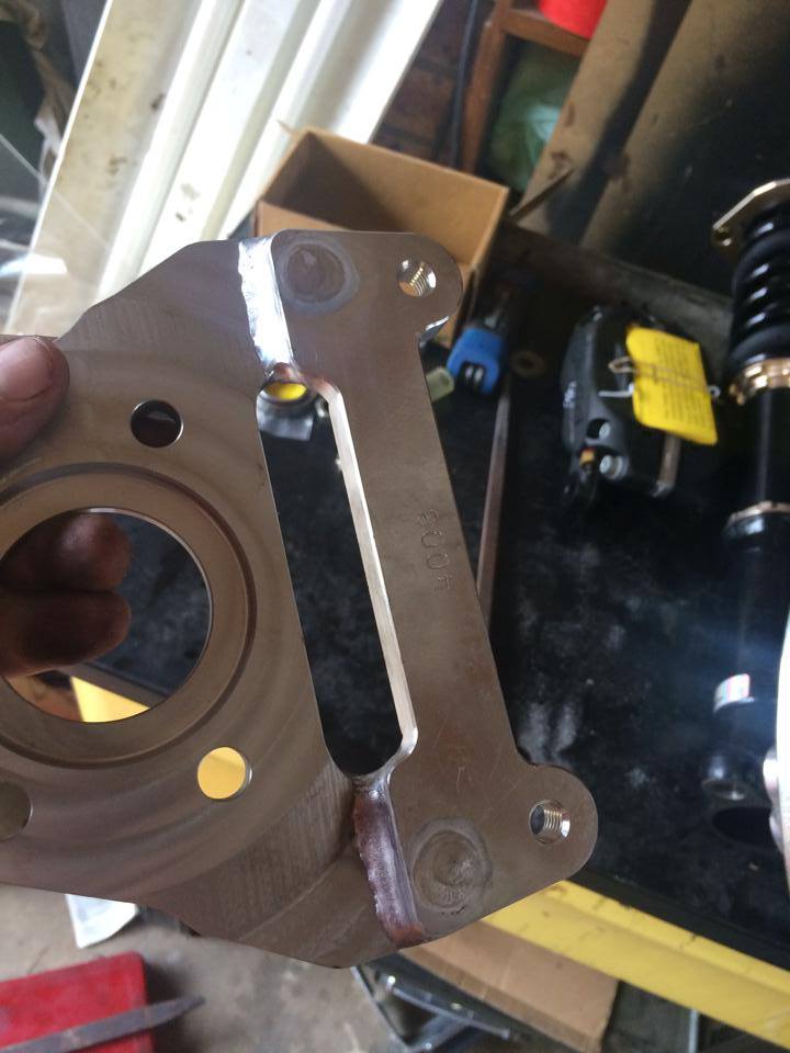

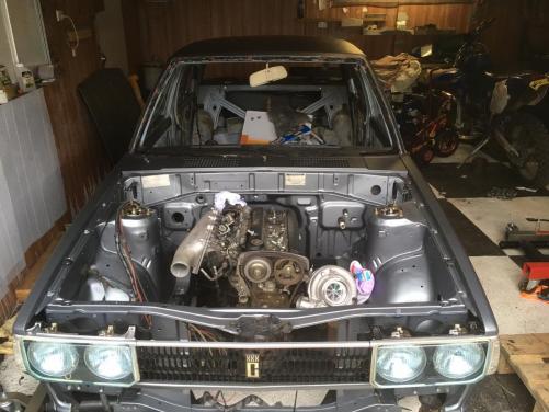

    steering rack rebuilt, brake bracket & backing plate all tig welded & BC Sports coilovers built with tha HUGE wilwood 280mm brakes which will help this thing stop on a dime.

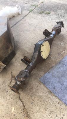

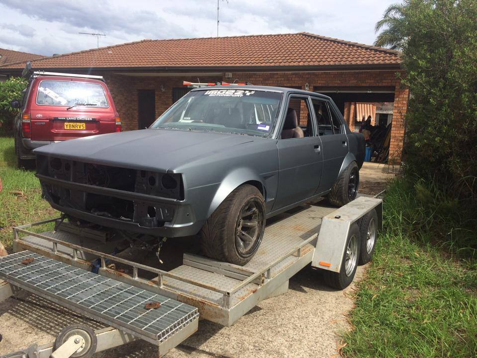

just put tha old stock rolla diff in cause i need to move it to my new house so gotta get him rollN

I'd be interested to know how the brakes end up performing as I'm hoping to have the same setup on my BC's in the future. A car that can nearly pull your eyes out of their sockets under heavy braking is far more satisfying than having them pushed back in under acceleration IMO. Having said that, a 20V with a blower the size of the damn engine block is something the gods themselves will fear!
lol well thats what I'm hoping for mate I'm even a bit fearful of tha power & torque its going to make BUT so excited at tha same time as for tha brakes I've got another set tha same size coming for tha ass end so braking power will hopefully match a vayron lmfao.
So update with tha build is i think I've been shafted on my bell housing that was coming from tha Philippines which i payed for back in december & still hasn't arrived but tha guy keeps telling me its on tha way alls i can say is he is lucky his in another country so when i can get another one then we can begin making up brackets to hold that MOFO of a blower up & full steam ahead.
My flat front also has had the side indicators deleted :( I'll have to punch out the bog and reinstate them.
Cool looking 4 door you are building. I did a quick skim. ill come back to read the details. Keep at it.
Thanks guys. We'll my idea to fix Tha issue with deleting Tha guard blinker is I'm going to but Tha blinker in Tha parking light so you can still see it from Tha side & yes it will have street rego because any body can build a fast car that's hasn't got rego.
