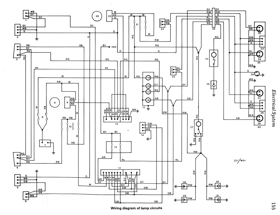

Banjo Posted June 18, 2014 Report Share Posted June 18, 2014 Hi Josh, More than likely to be the combo switch on the steering column. Well known weak point. I presume you have high beam, but no low beam ? Give me a yell, and I'll look up the KE70 wiring diagram & see if I can work out exactly where the problem could be. Cheers Banjo Quote Link to comment Share on other sites More sharing options...
baileyz Posted September 16, 2014 Report Share Posted September 16, 2014 I have a similar issue with my ke70 was wondering the best method to finding a broken earth as I have changed my combo switch to a new one? Quote Link to comment Share on other sites More sharing options...
altezzaclub Posted September 16, 2014 Report Share Posted September 16, 2014 In here is a diagram of how the dipswitch stalk works, and a wiring diagram of the lights circuit. http://www.rollaclub...mal-headlights. Here is the lighting diagram again- and the key to it- Quote Link to comment Share on other sites More sharing options...
