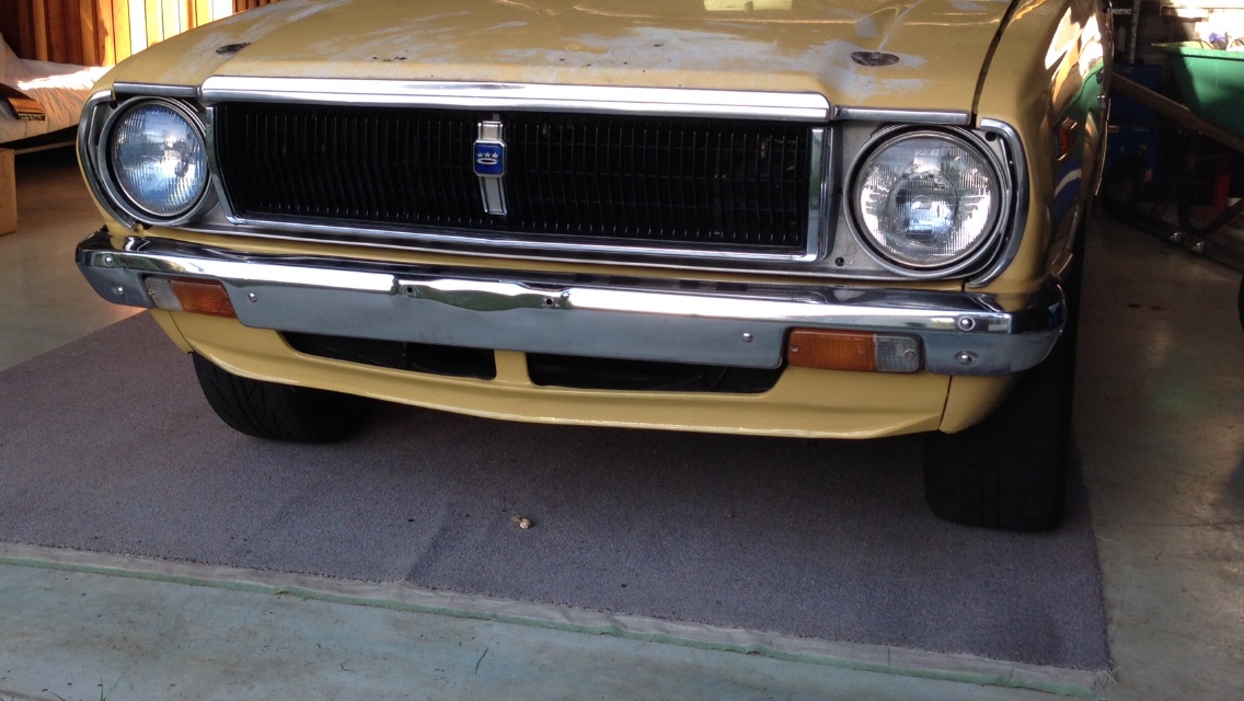

If you still have all the pieces a cracked grille can be easily glued and look like new with some black and/or silver paint.
Mine was busted in a few spots.
Wow. That came up great. I'll have a crack at it myself. Thanks.
