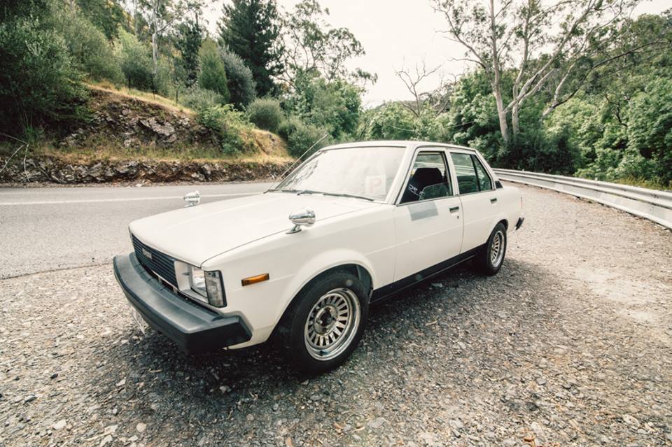

I have ST Celica front ultra low king springs in the rear of mine. Rated at 4.6kg and sit it at this height on 15" rims.
1450908_1499052697010993_8348696452903911277_n.jpg?oh=716eef125b72961d62bb3dcd1eb43ee5&oe=54EF48B9
You'll need shorter shock all round whatever you do so upgrading the entire front struts would be your best option. Rears are easy.
