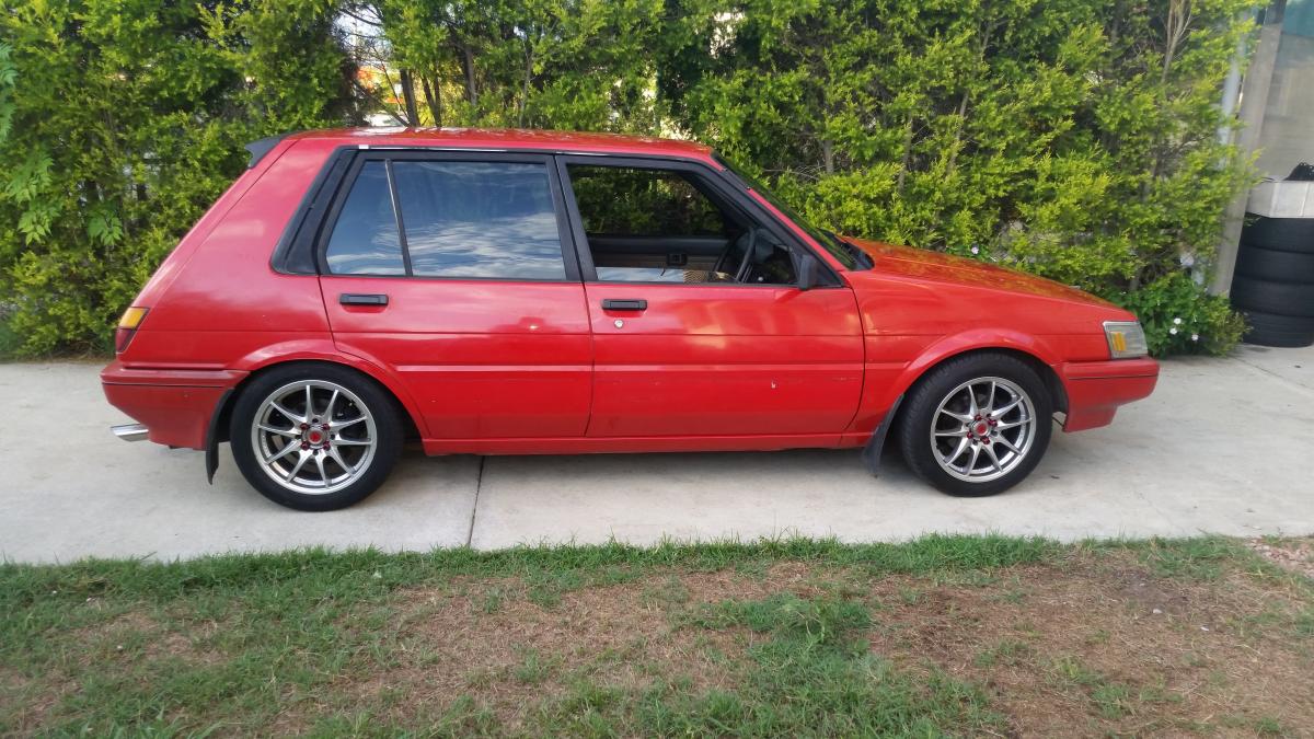

Did this car have smoked tail lights? Your right about them being scarse, Ive been looking for one for a while now. Anywhos Ill be following to see how she progesses.
That wheel /tyre profile should be much better. Judging by the dizzy cap and the plugs, if you give the engine and radiator a good reverse flush with a hose and replace the thermostat, your cooling function may return.
I would seriously consider replacing the hoses too. They are likely to be pretty marginal. The stocko cooling fan should be perfectly adequate. If it isn't, the issue is elsewhere in the cooling system.
The faded red paint is standard from that era, may well come up with a good cut and polish.
Hey yeah the car did have black lights and a big dirty cannon. Got rid of that quick smart. Actually drives pretty good with the 15's. Needs some decent grippy tyres and suspension sorted soon. Yeah parrot ill give the whole system a flush. Has a near new radiator and green coolant but that doesnt mean anything. Ill spend sometime on her tomorrow and get the cooling system sorted. I started with a cut and polish but gave up when it looked the same. Awesome runabout but. 400km downcwith over a quarter of a tank to go
spent a bit of time on her last week,flushed radiator, ran mukowt thru the motor for 20mins, dropped mix and replaced thermostat. the gauge gets to about half way before the thermo fan kicks on but the car runs just under a quarter while on cruise. I'm going to look at the thermo fan switch but I'm happy with how the cooling systems going.
checked the resistance on the trd spark plug leads, all for show, ill be replacing them as some where pretty bad and must have some age about them.
i picked up some monroe gt and lowered springs a few days ago so ill be chasing up some superpro bushes and change it all out at once. ive been reading about castor in the front struts, so i just turn the top 90 degrees and it will give me more castor is that right...??
got round to giving it a really deep cut and the paint lost alot of its chalkyness. its got some nice wax on it now and looks much better.
sorted out some tint also so I'm pretty happy with how its all looking and going.

I gave it the TL;DR took my a few seconds to see that was the dizzy.
Love me a Twinky, gotta get me another one! 15's will look awesome when a little lower.

So I picked up some second hand lowered struts and went to out them in. Didnt look when I bought them but was told will fit twinky. Put rear bushes in and rear struts and the car was cutting my tyres. Way too low. Looks fat. can't have anyone in the car but me, scrubs everywhere. This is after I rolled every guard. Put new rear wheel bearings in while I was at it so rear is sussed bar struts. I have to get new rear struts sooner than later. Front I picked up some kyb excel gs as I was needing to drive the car and couldnt have it not being my daily. Perfect with kingys for drivi g. Still waiting for adjustable/fatter rear swaybar so let me know if anhone has one!!! Getting wheel alignment tomorrow so hopefully sort the scrubbing out a bit. Handles well so be interested to see with the alignment. Picked up e58 lsd today and it was bombed on its nuts. Had a heap of parts and was a steady scrubby drive home. Ill put a few posts up down the track but just enjoying it as a daily. Got some front bigger brakes off ae93 s2 so ill get them on with new pads. Using no oil since I fixed the dizzy seal! Go the 4a. Cheers

So shes still goin strong. Done a heap of work and enjoying it. 3 window channels had rusted out and stopped the windows winding up/down so i found some new ones and put them in, tps and tune all sorted and still cheap as shit on fuel. Best i have returned is about 7.6lts and thats driving fairly spirited. Car is sitting with brand new kyb struts all round and sl king springs. Not cheap but worth it. Nice and tight with superpro bushes also. No other real plans for it hust yet other than tidying it up and trying to keep it original. Still yet to see another red one on my travels but sure theres heaps around. have to sus out a cruise
All sounds good. There was a red one for sale out Ipswich way a couple of weeks ago, think he wanted 3k for it. Looked to be in the same condition as yours but thats just going from pics. I got a white one but its rough. Pretty much needs rebuilding. Keep the pics coming.
