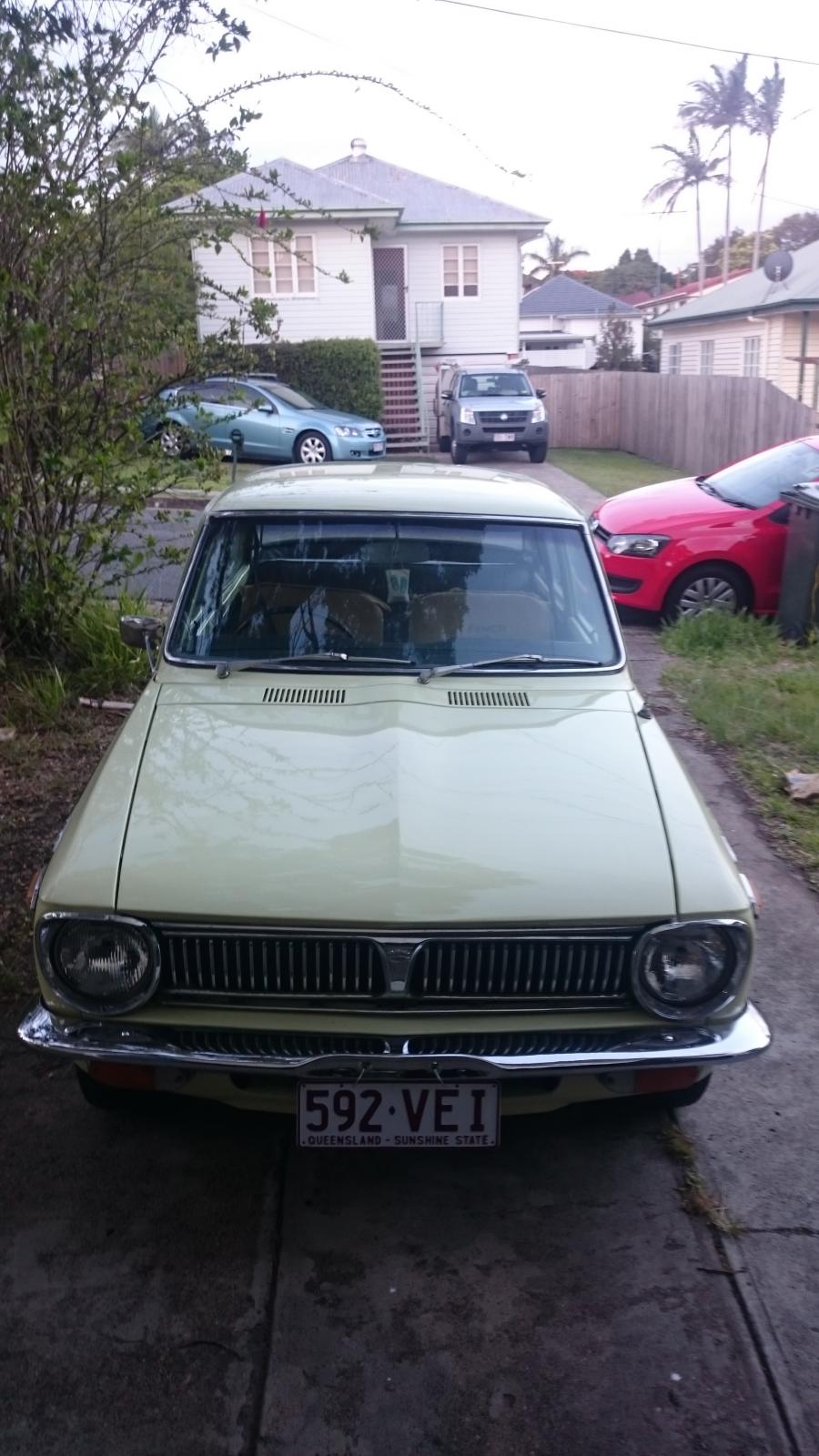

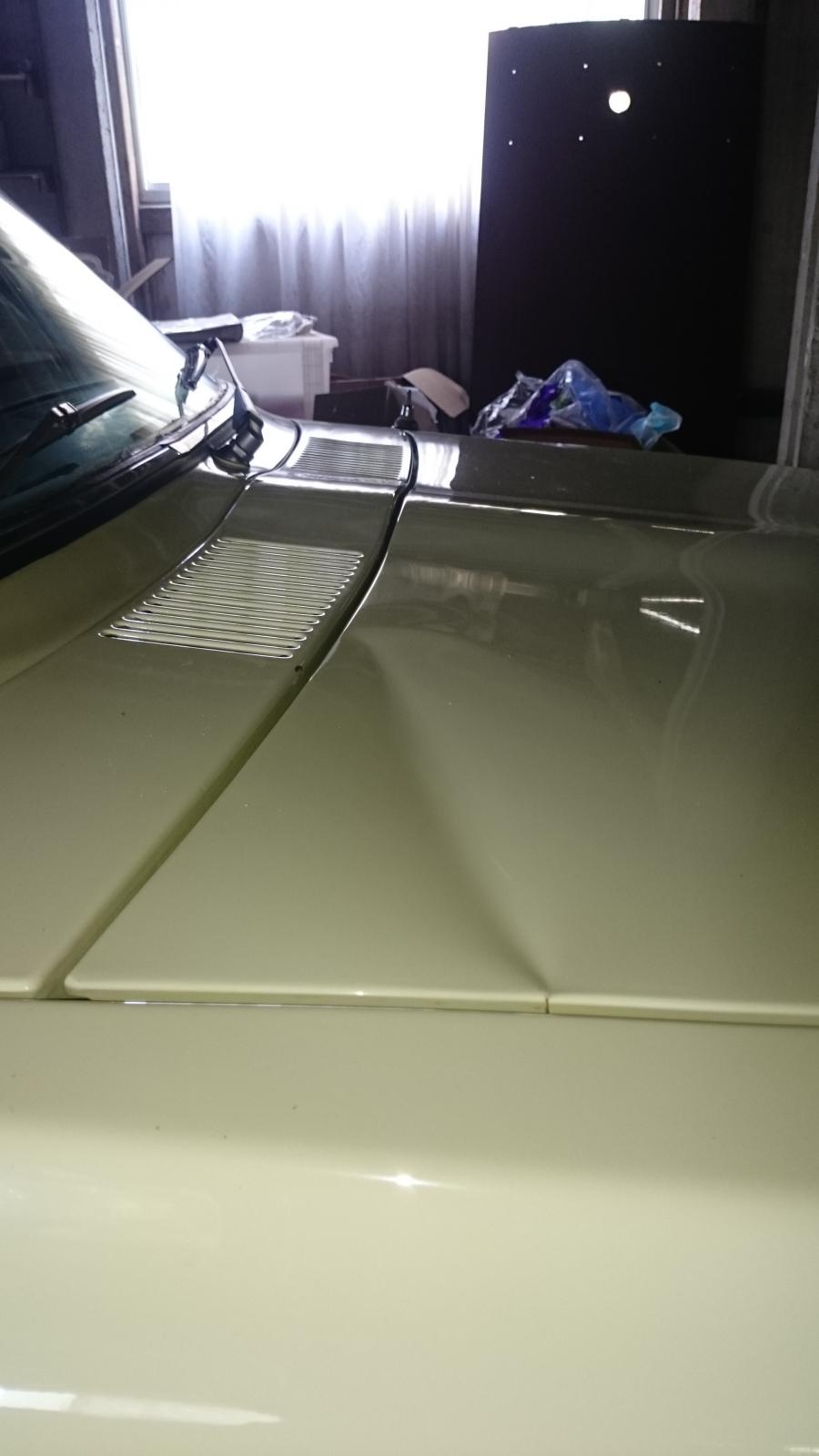

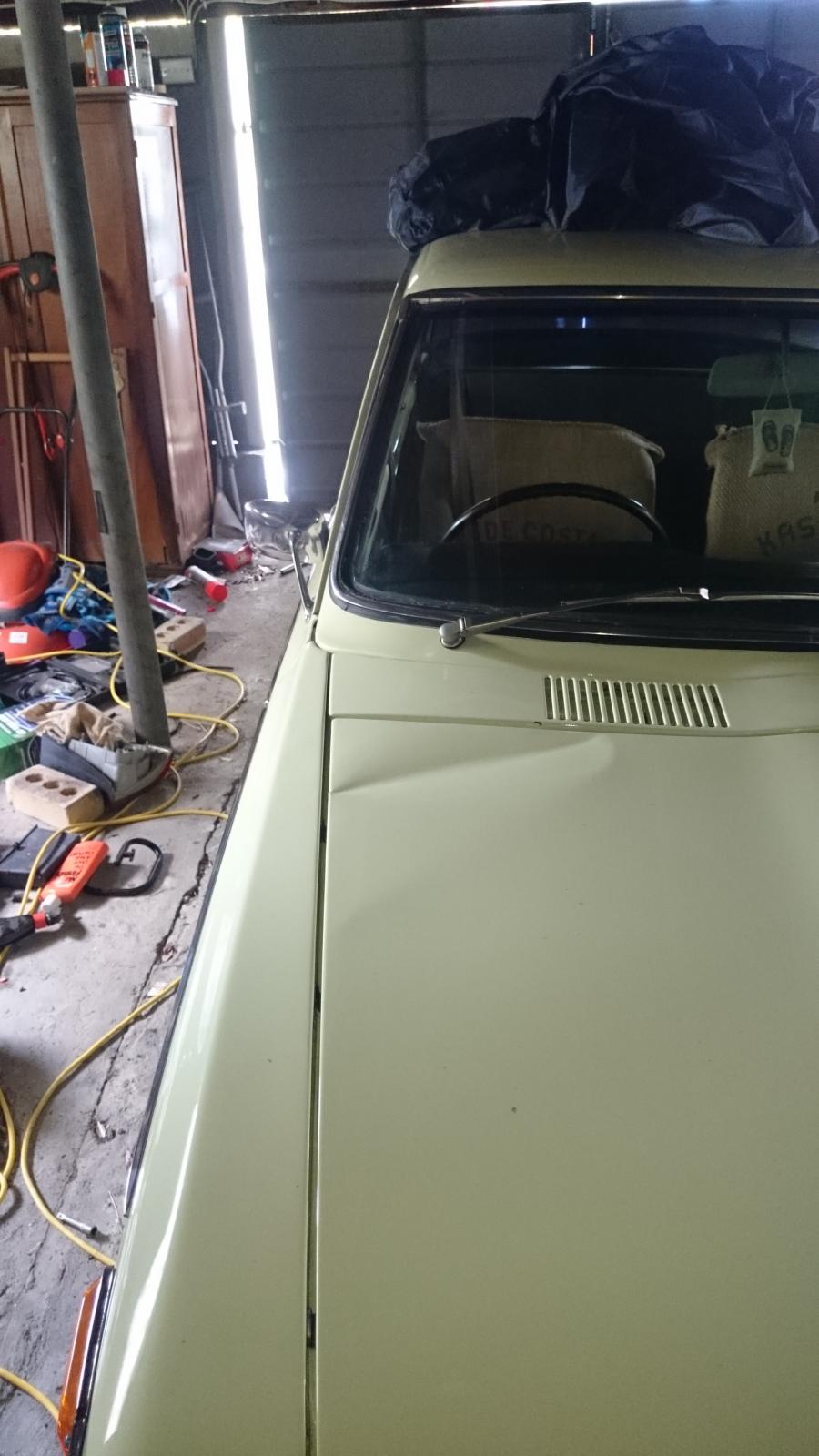

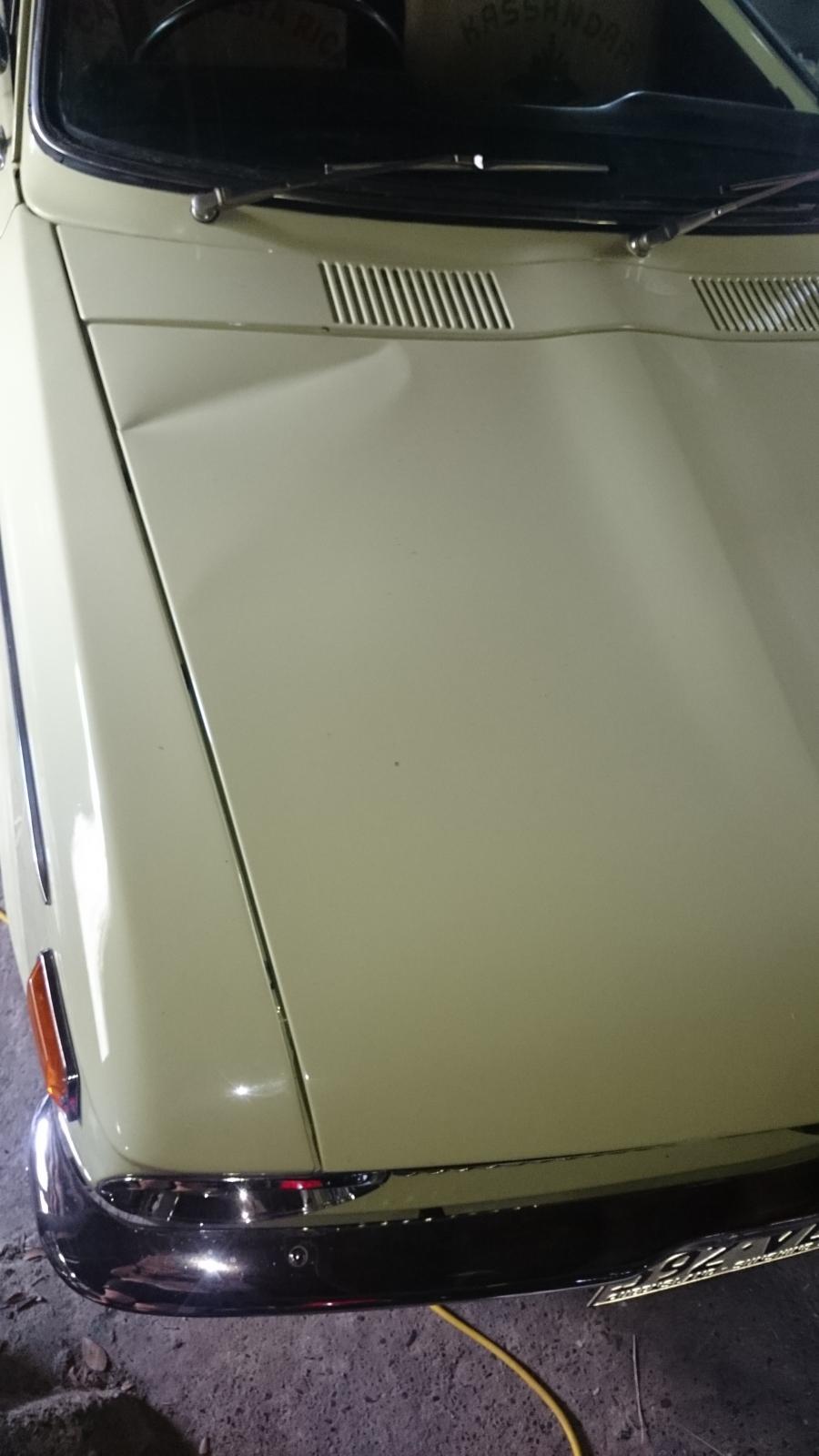

jimsKE10 Posted December 13, 2014 Report Posted December 13, 2014 Hey all, so recently I was driving my corolla and had just pulled off the highway (thank ʞ©$ɟ) and my bonnet latch failed and it flipped up and there is a crease / bend in the top left of the bonnet. First of all does anyone know what the going rate is for something like this? and secondly does anyone know a reliable and good panel beater that would do the job well for me? I live in Brisbane so anywhere around that area would be nice. Before :thumbsup: After :down: Cheers. Quote

Jono.C Posted December 14, 2014 Report Posted December 14, 2014 That's a very easy fix. You got lucky You can get butane bottle torches for like $30 at k&d, use that to heat the crease and put water on it to keep shrinking the metal, hammer it flat with a dolly and a tiny skim of filler Most shops would do it in half an afternoon, but labour is generally $100 p/h Quote

Jono.C Posted December 15, 2014 Report Posted December 15, 2014 (edited) Yeah it would, But you wont get that crease out without ruining the paint, It'll crack as soon as the metal bends back the other way again Also just do what i do and loop a belt through under the bonnet to somewhere on the rad support. I do it on my cars for drift days etc to pass tech inspection Edited December 15, 2014 by Jono.C Quote
