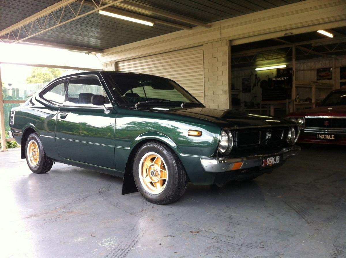

This is how I bought it, As some of you had seen the ads you will recognize these photos.

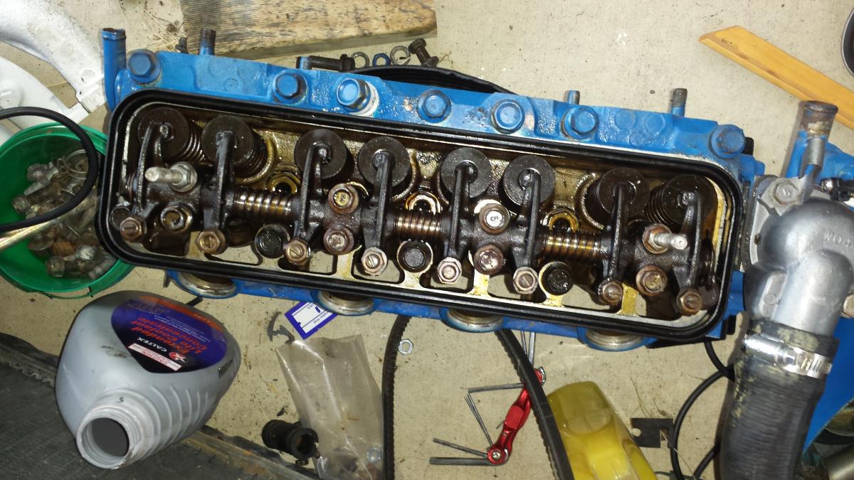

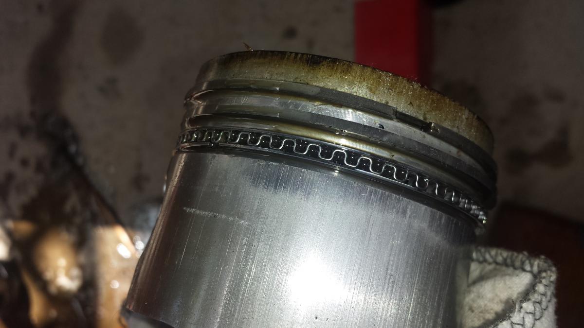

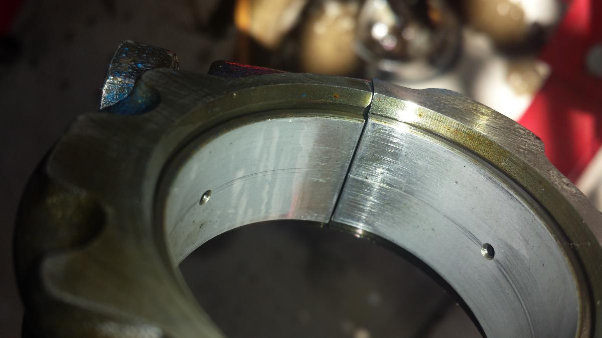

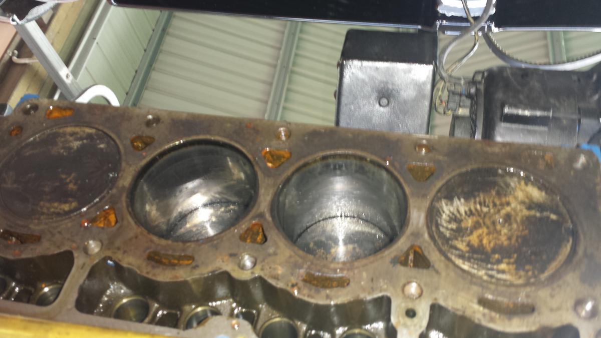

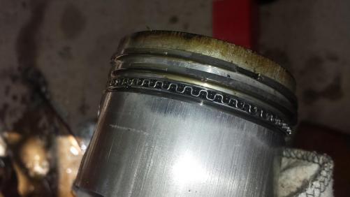

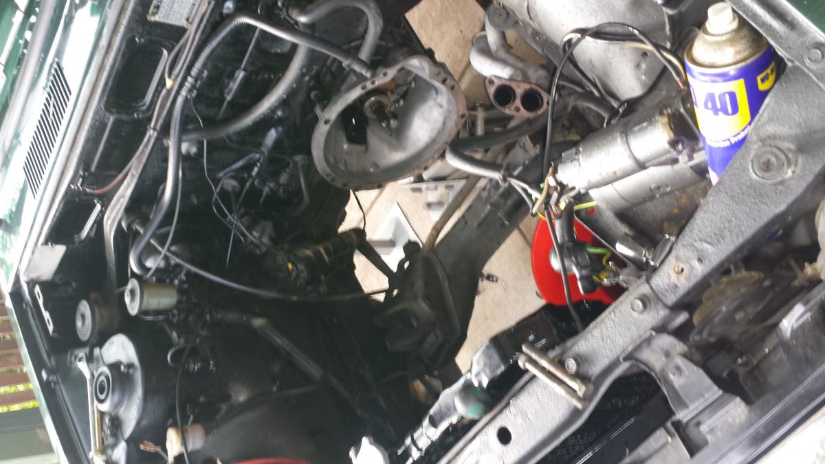

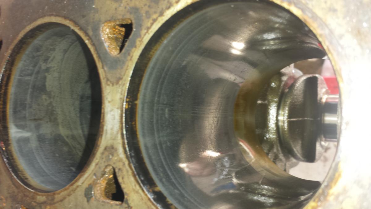

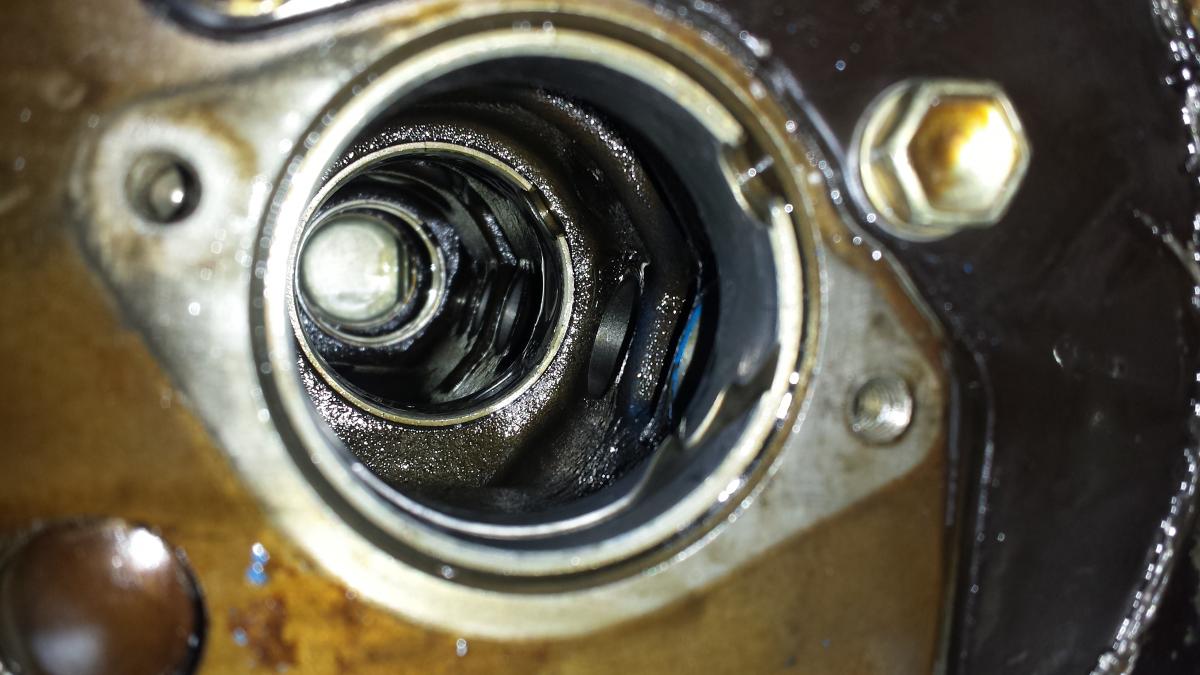

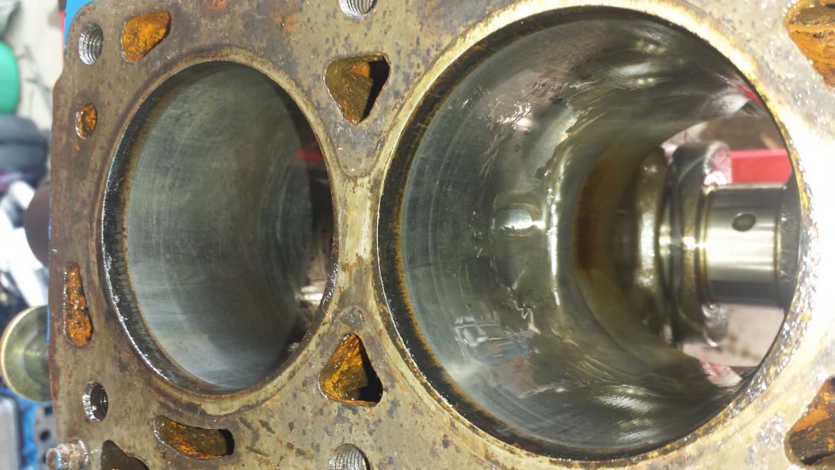

After a bit more advice I pulled the motor out,
and started to tear it down to see why it was binding up and so hard to turn over.
post-12384-0-11909800-1423123353_thumb.jpgpost-12384-0-66402700-1423123393_thumb.jpgpost-12384-0-24833300-1423123453_thumb.jpgpost-12384-0-43411400-1423123485_thumb.jpgpost-12384-0-89955700-1423123521_thumb.jpgpost-12384-0-73774100-1423123560_thumb.jpgpost-12384-0-88063300-1423123599_thumb.jpgpost-12384-0-92017600-1423123643_thumb.jpgpost-12384-0-26576100-1423123691_thumb.jpg

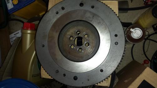

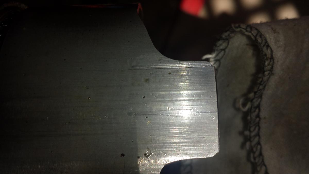

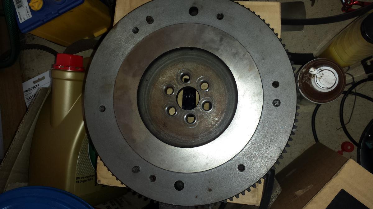

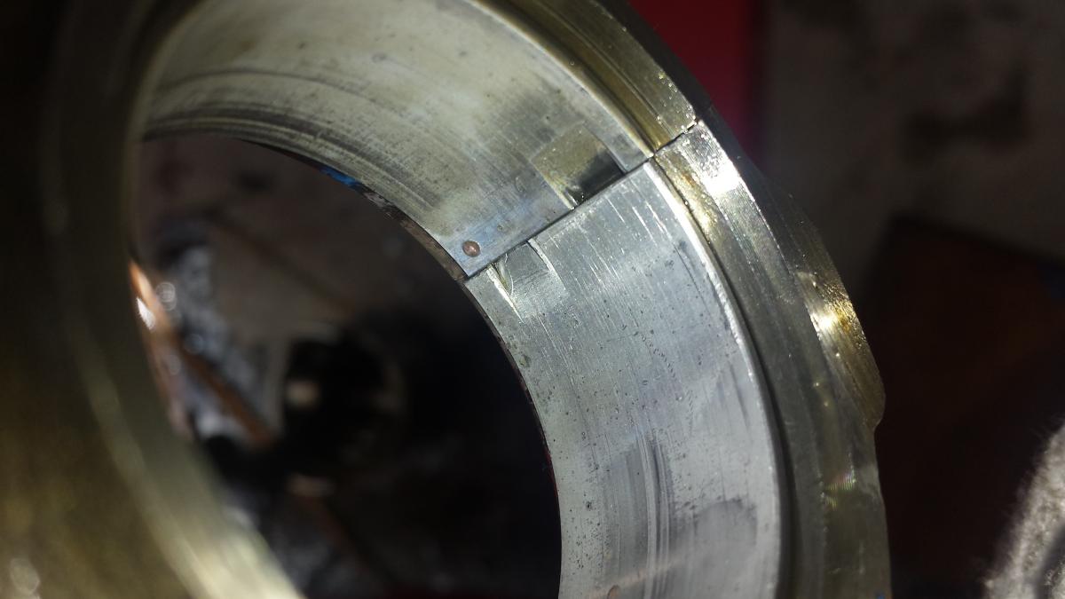

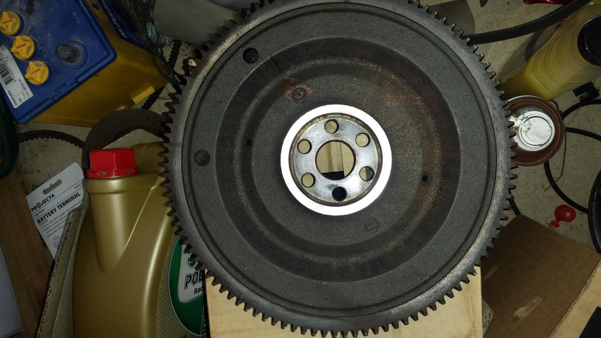

As soon as I pulled the flywheel and put the motor on the stand it loosened up a lot, could even turn it by hand, but would still bind up a tiny amount.
Flywheel
Couldn't really see any marks on the wheel itself, very small amount of the rear main seal was scored but nothing major.

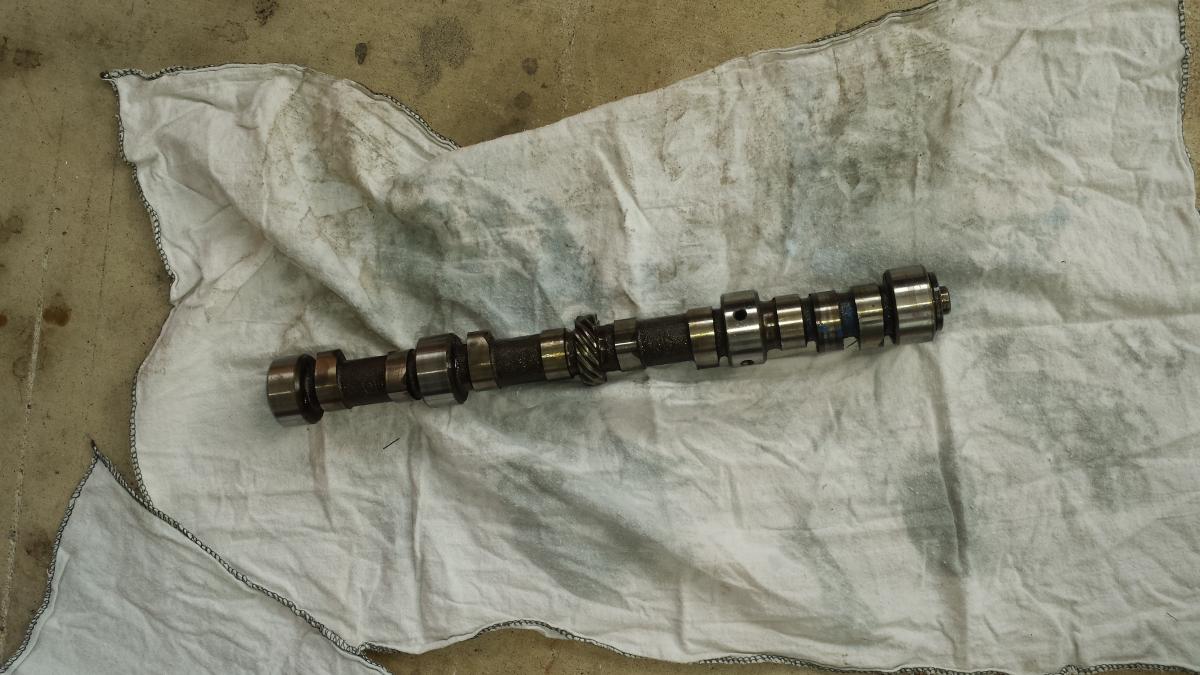

Whilst I've got the motor out and pulled down, i figured I'd get the cam done, decided to get a tighe 154 grind and the lifters refaced
Also getting new big end and main bearings, thrust washers etc.

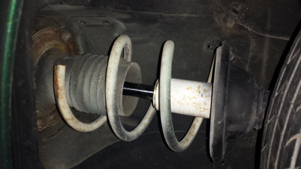

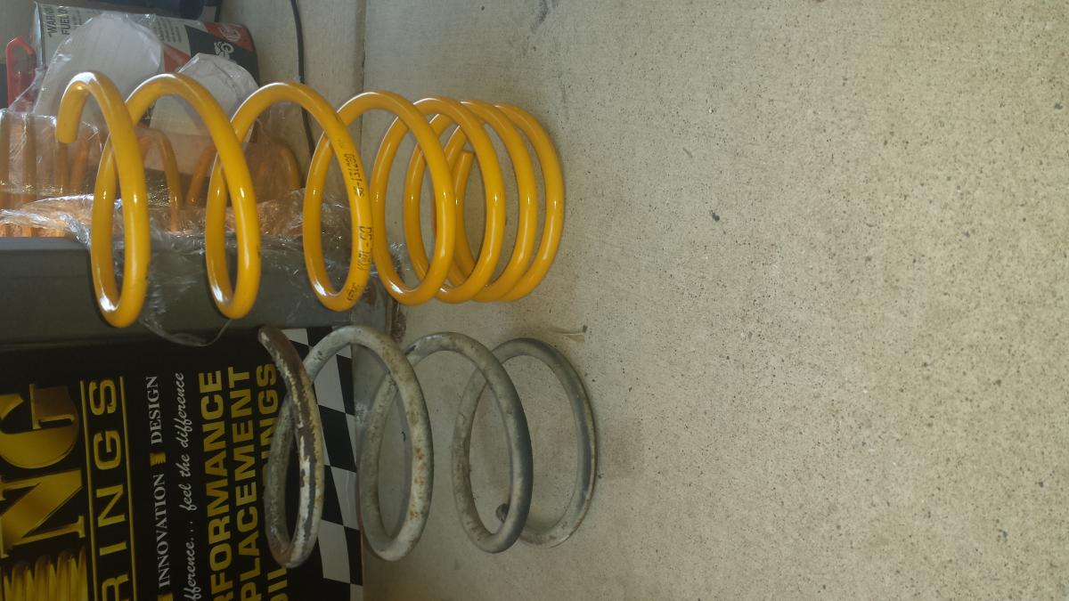

Today I pulled the struts out to change the springs over.
Old vs New

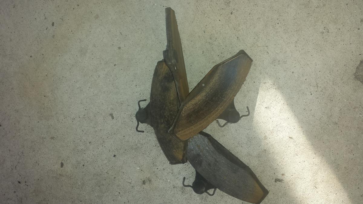

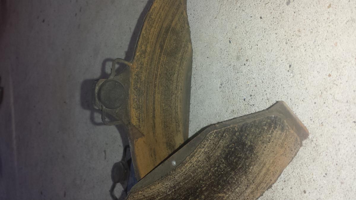

While I had the wheels off, checked the brake pads and got another lovely surprise...
Thankfully I happen to have Girlocks on the front, So VN rear disk pads work in these?

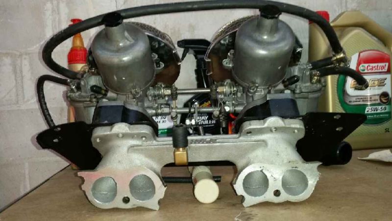

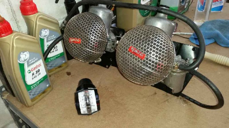

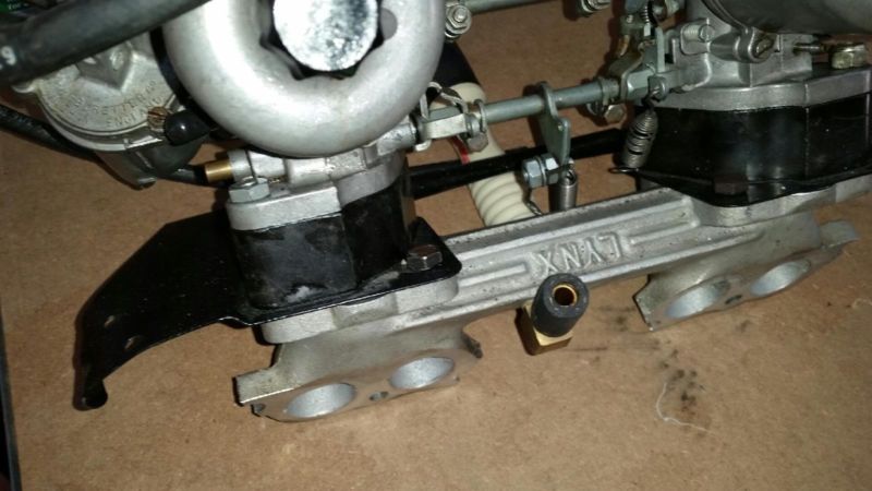

I've also got twin SU's on the way

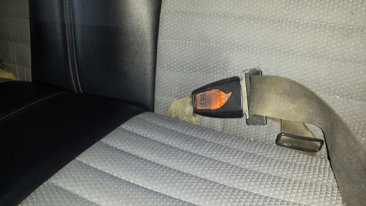

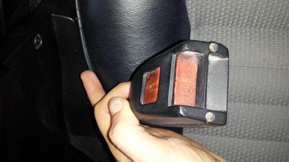

I need a passenger side front seat belt stalk looks like this
and also a rear drivers side.

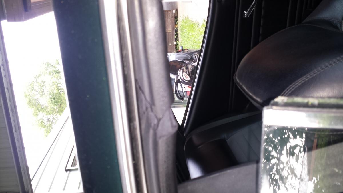

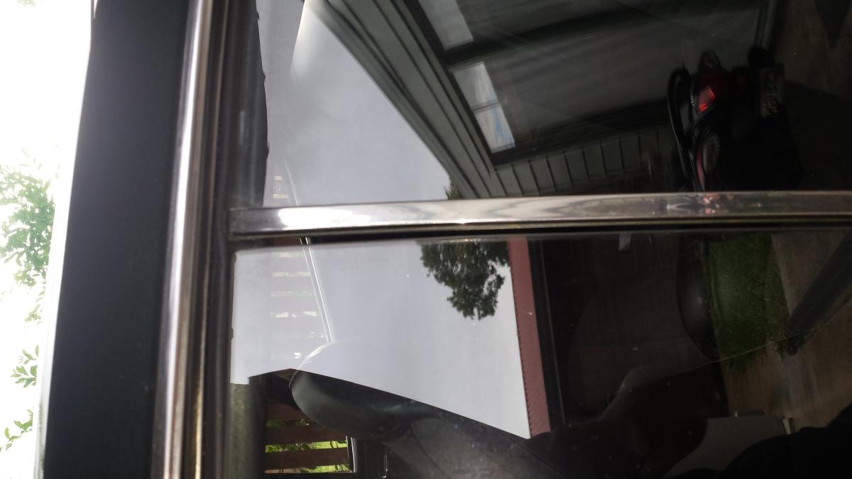

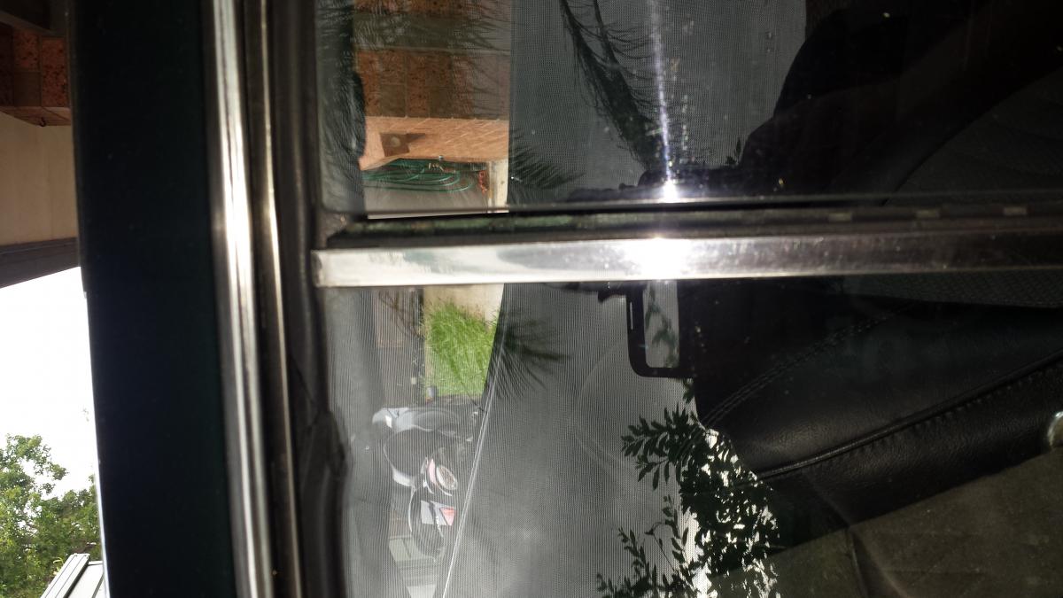

Also if anyone knows where to get the coupe weatherstrip and the strip between the windows?

Great first post! And yeah your car is familiar. Your engine certainly needed a freshen up anyways, pistons hitting bores isn't a good thing.

ordered the window dividers and a bailey channel seal through rare spares so with any luck that should arrive sometime next week or so.

  • Seat belt stalk to suit ke35 for passenger front possibly rear also

My twin SU's arrived today need to take a look at them and organize to pick up some extractors then get the rest of the exhaust made to suit, but this can wait until after she is running and registered.
