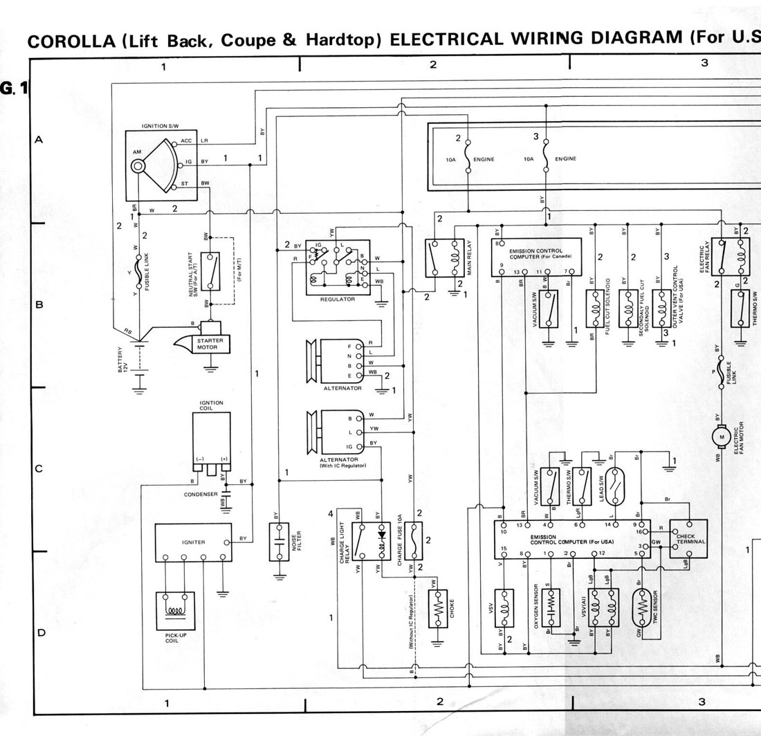

If I wanted to bypass the ignition switch what wires do I need to wire upto a toggle switch for on and then a push button for start
Look in a wiring diargram!
This one will do- White supplies the power for everything from the fusible link, and it goes out via the accessories blue/red, the ignition black/yellow, and the start black/white to starter solenoid.
So the white gets switched to blue/red and black/yellow, and it gets buttoned to the black/white.
Ledgend :) appricate it
