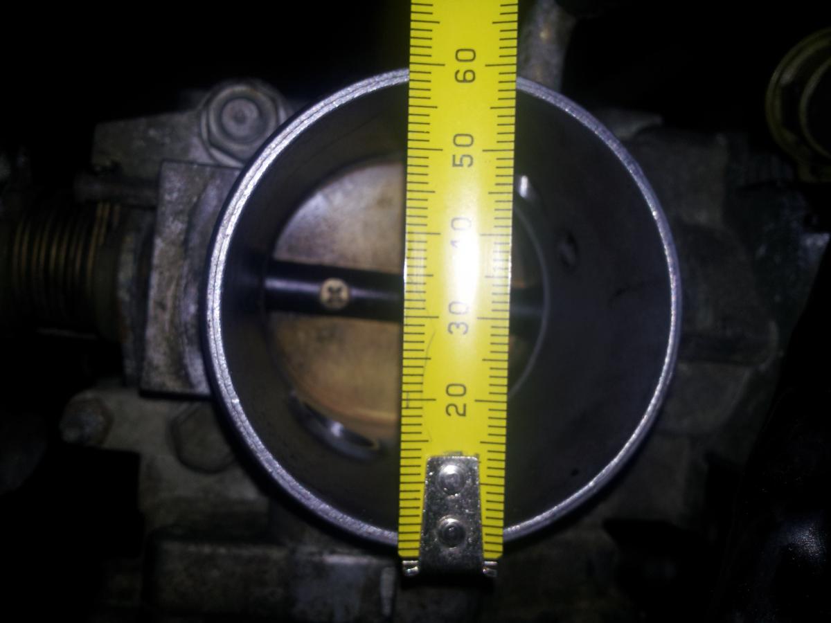

I cleaned all the sensors and re-wired them, car nearly started straight away, so I thought I was right track, I pulled the complete thermo housing off and checked the coolant line that runs to the throttle body (auto-choke) and it was completely clogged up - I couldn't push out the crap in there, so currently it's sitting in a bucket with CLR.
Anyone known a good way to descale / rust an engine from the inside?
Here is a pic of the clean throttle intake.
You just keep finding nasty surprises!
