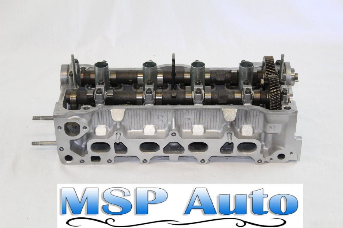

New user from Australia, having recently acquired a 1994 Corolla CSi Limited hatchback. I'm on a bit of a rampage trying to figure out what era 4A-FE I'm working with, and hence what can be done to spruce it up. I've found two holes on the intake side of the cylinder head: one for the EGR system (apparently never fitted to mine...), and another for some unknown purpose.
I've attached a picture of a cylinder head the same as mine (lifted from here). Bottom left is the EGR port integrated into the intake manifold (which my intake doesn't have), top left is the mechanical fuel pump (which I don't have, obviously), but the bottom right hole is a mystery to me. :S
Any ideas??

That picture shows a Gen2 4AFE as the injectors are not in the head, which is the same as a 7AFE. A '94 would most likely indicate that you have an AE101, none of the Aus-made AE10x had EGR.
EDIT: Actually I change my mind, you can still see the bosses for the injectors and the fuel rail bolts plus the ports sit higher on the later heads, this looks like a 4AFC head (which obviously wouldn't need injector holes) or maybe an interim head from when both the 4AFC and 4AFE were sold
The hole on the right doesn't look the right shape or bolt-pattern to what I'm used to but the location indicates it's the inlet for the water pump (well, the outlet from the head that goes to the inlet of the water pump)

Confirmed it looks like some sort of heater/coolant inlet/outlet, but I can't figure out what it is... :S
Here is another cylinder head that actually has the fitting, and this article shows a heater return pipe for a RWD 4A-C that looks like it would fit there... So maybe it is a crossover head? A deprecated heater fitting?

Ahh, if you've got an AE9x then you'll have a Gen1 4AFE. The FWD engines also have different water circuits to the RWD ones so the Rollaclub guide isn't that relevant, also 4AGEs have different circuits to the FEs.
OP's photo shows intake side... also the hole appears to be in the oiling area of the head....???
my USA head does not have it.    From where that hole/port is, I wonder if it is a secondary breather for blowby????
