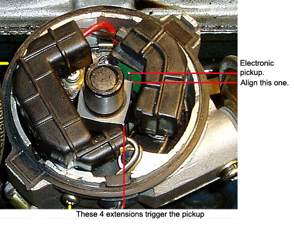

No, once you're sure its #1 cyl coming up to firing on TDC, just put the crank on 8deg BTDC and work with that. I think you can see the inlet valve through the oil filler hole, the exhaust rocker is too far forward.  So as the crank timing mark comes through the last 90deg before TDC the inlet rocker should be stationary.  If the inlet rocker is coming up (closing the valve) then its #4 that is firing at that TDC & you have to turn the motor over one more turn.
With the crank pulley on 8deg BTDC, you now want to fire the spark plug. If its like my 5K dizzy, there are 4 little extensions on the dizzy shaft that replace the 4 corners on the old system. One of these extensions will wipe past the electronic pickup to fire the coil. The easiest, now I think of it, is to turn the dizzy so that extension aims straight at the metal bar in the electronic pickup.  If the vac advance unit hits the head then you'll have to take the dizzy out and move it a tooth.
While that's not quite as accurate as having it fire the spark plug, the amount it is out is not worth worrying about. After that you just tighten the dizzy and make sure the rotor points to #1 plug lead. Clockwise they will be #3, #4, and #2 from there.

Ok so I double checked everything, watched the inlet rocker for cyl one and it sat stationary for the last 90deg or rotation before it hit TDC on the timing mark at 8deg BTDC
That was dead on so I knew TDC was right, took the dizzy cap off and  looked for the point under the rotor, that was dead in line with the metal bar on the pickup.
