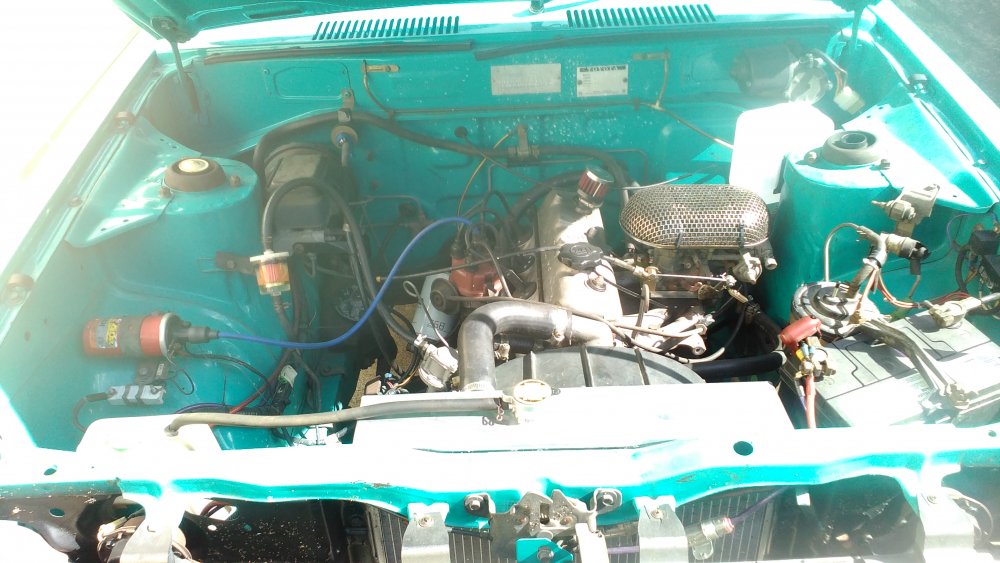

Here are some photos of the engine bay as is, and the 5k parts:
