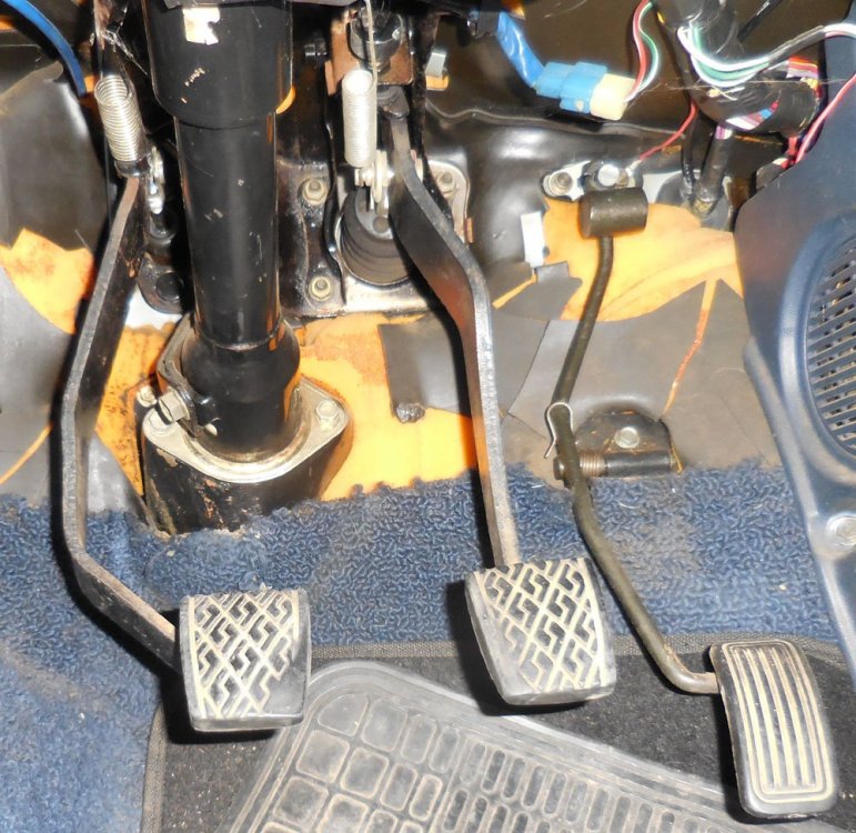

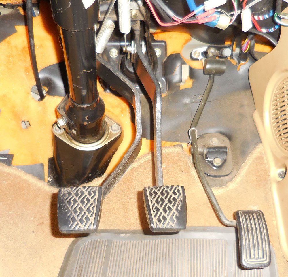

altezzaclub Posted June 23, 2018 Report Share Posted June 23, 2018 I posted these somewhere for you I thought.. Both these cars are 1983, but the Hoonicorn is a flat-front with a 4K & K50 on a cable, & The Girls beast is a slanty with a 4AGE on a T50 hydraulic. So that pedalbox is from an AE71 that had a 4A-C motor. I hadn't noticed the pedals were so different, even though I converted them both from autos! Quote Link to comment Share on other sites More sharing options...
