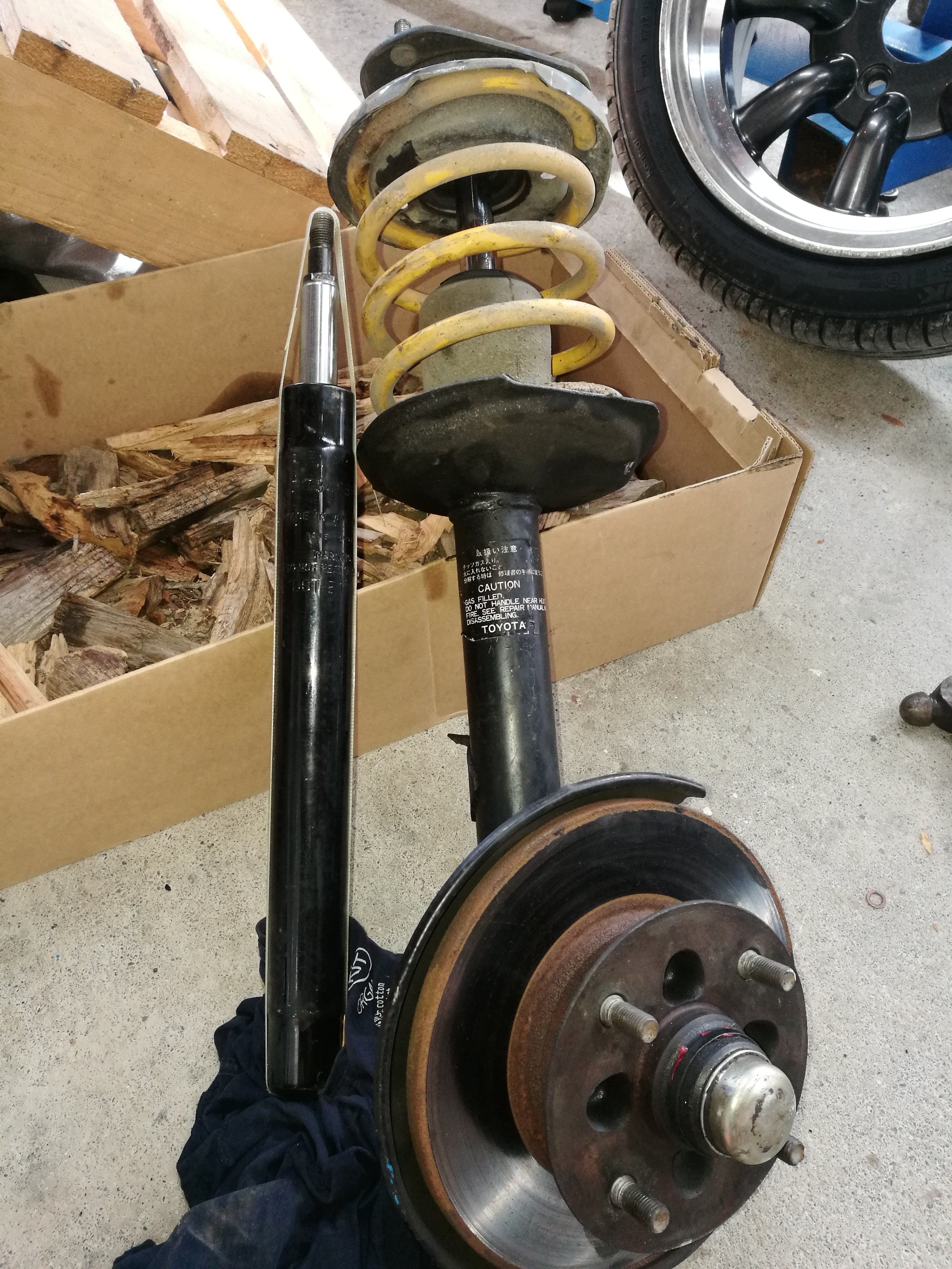

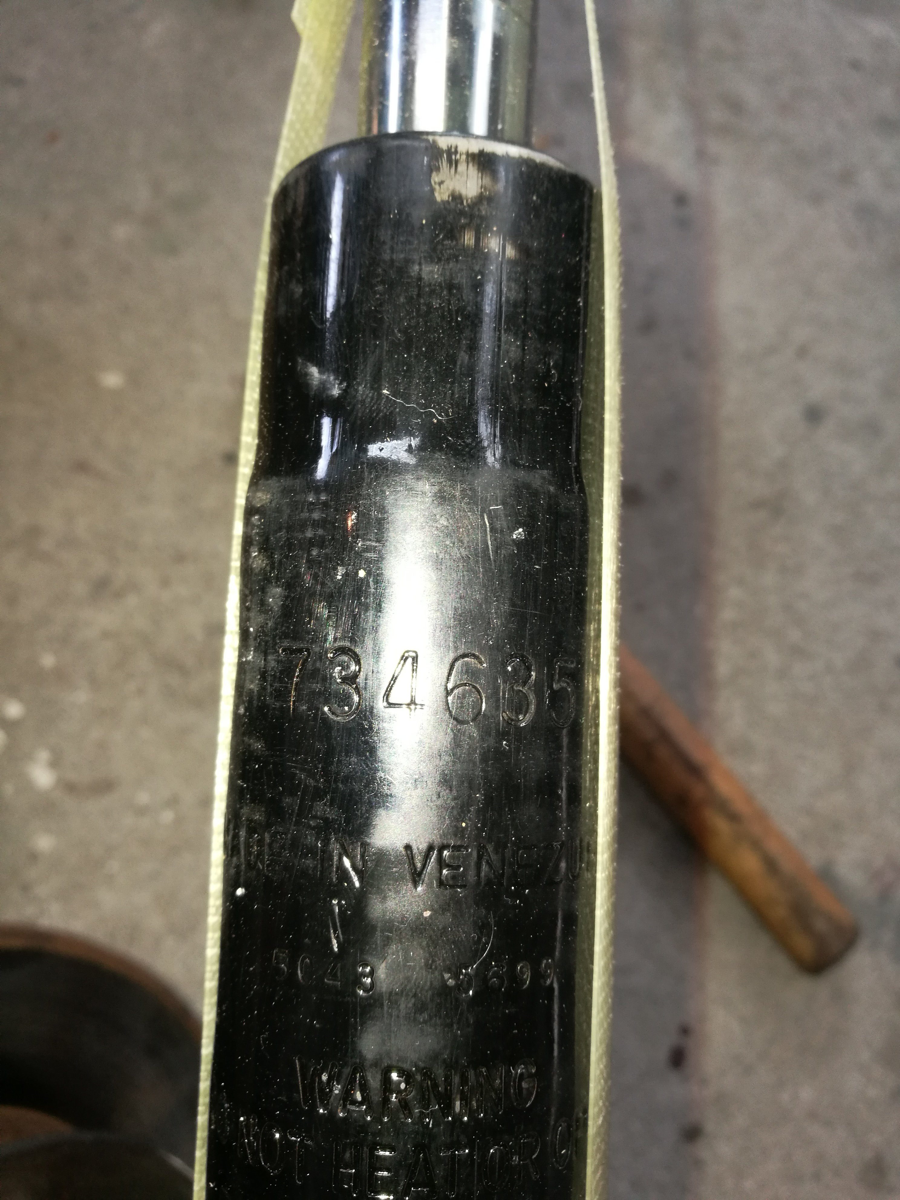

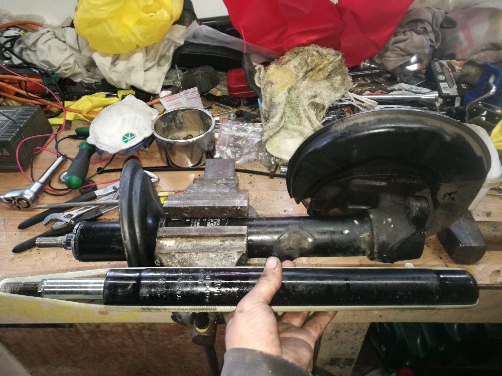

  1. It was really loose last time i put it in. I reckon the spacer just needs to be at leasg 3-4mm longer. The tape around the body defiantly helped
  2. Sounds like a loose top nut clunk, but the top nut is defo tight!
  3. Alright so idk what ive done wrong with the installation, but the strut now clunks slightly. Got it rechecked and failed again on the "shock not being installed properly" for god sakes. It wasn't even that bad. Really minor play. But anyways i ripped it apart again and ended up insulator taping the shock body and spacer so it is now one whole unit and sat inside the strut body bloody snug. Thought I had it sussed then i rattled the top hat down till it was freakin tight and it improved but the clunking sound is still present. Had a look at the top hat and the bearing looked a bit shagged?
  4. Update! Hey sorry for all my confusion, this insert game has been all new to me! I appreciate everyone who has added their 2 cents. Wether it be roasting me or not, i thank you. Lmao I've found working on these old skool cars to be quite challenging at times due to my lack of knowledge, but saying that I've learnt quite a fair bit during the process! Its been an awesome yet frustrating experience so far lol But Nothing beats working on your own sack of junk and turning it into something sick(; But in saying that..... The ae92 struts are in... the super lows slapped shut with thy top hat.... and the mighty blue turd will be off for its recheck tomorrow!

  6. Here is another piccy of the strut / rotor

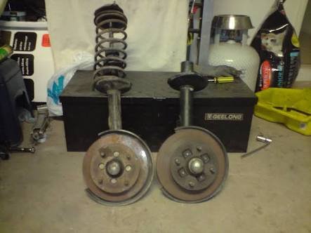

  14. Surely somebody must know what they're out of, if not I'll give toyota a ring tomorrow and quiz something up

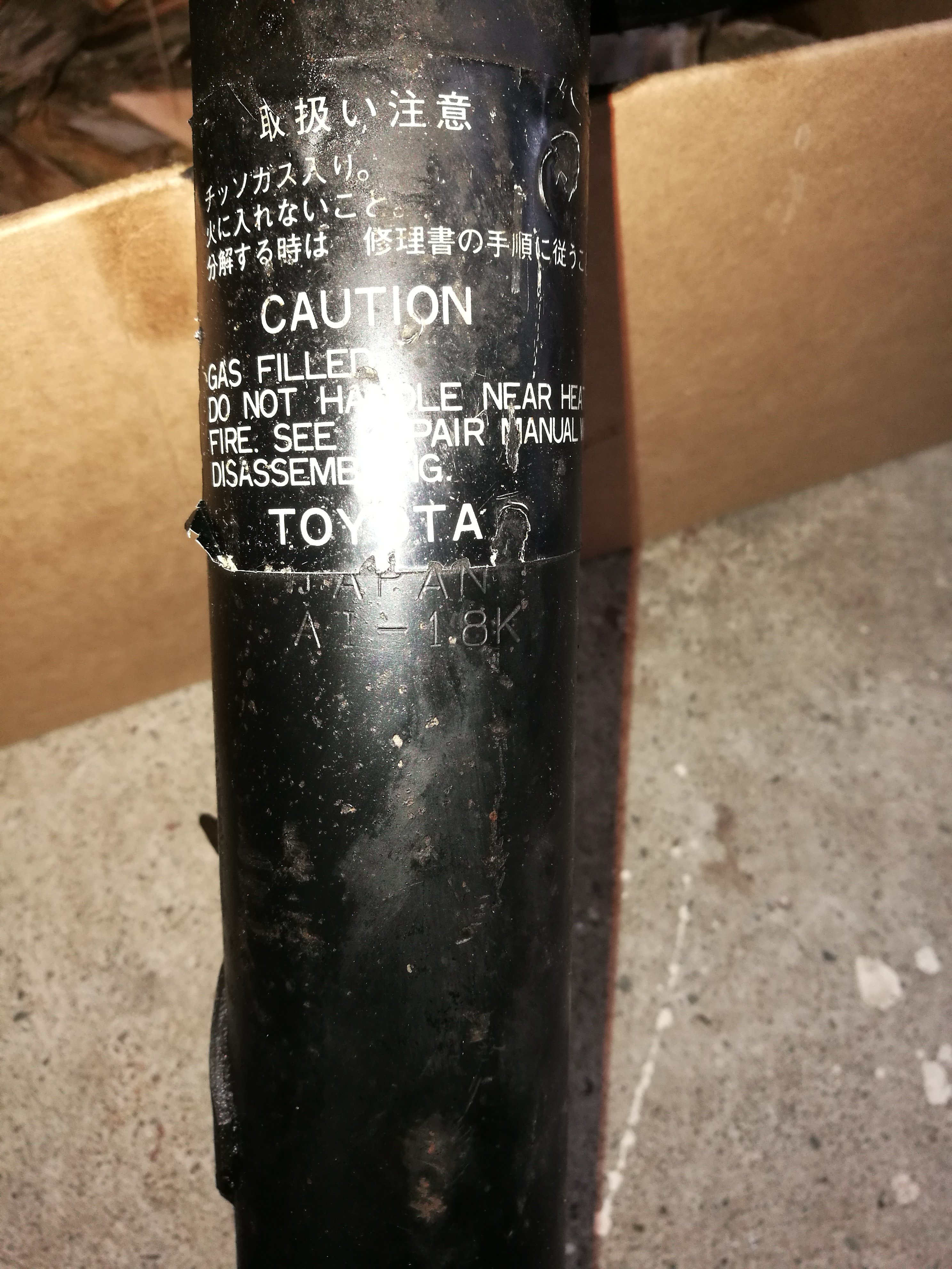

  15. Here is the original shock part #AI 18k Guessing its a factory toyota part from the label.
