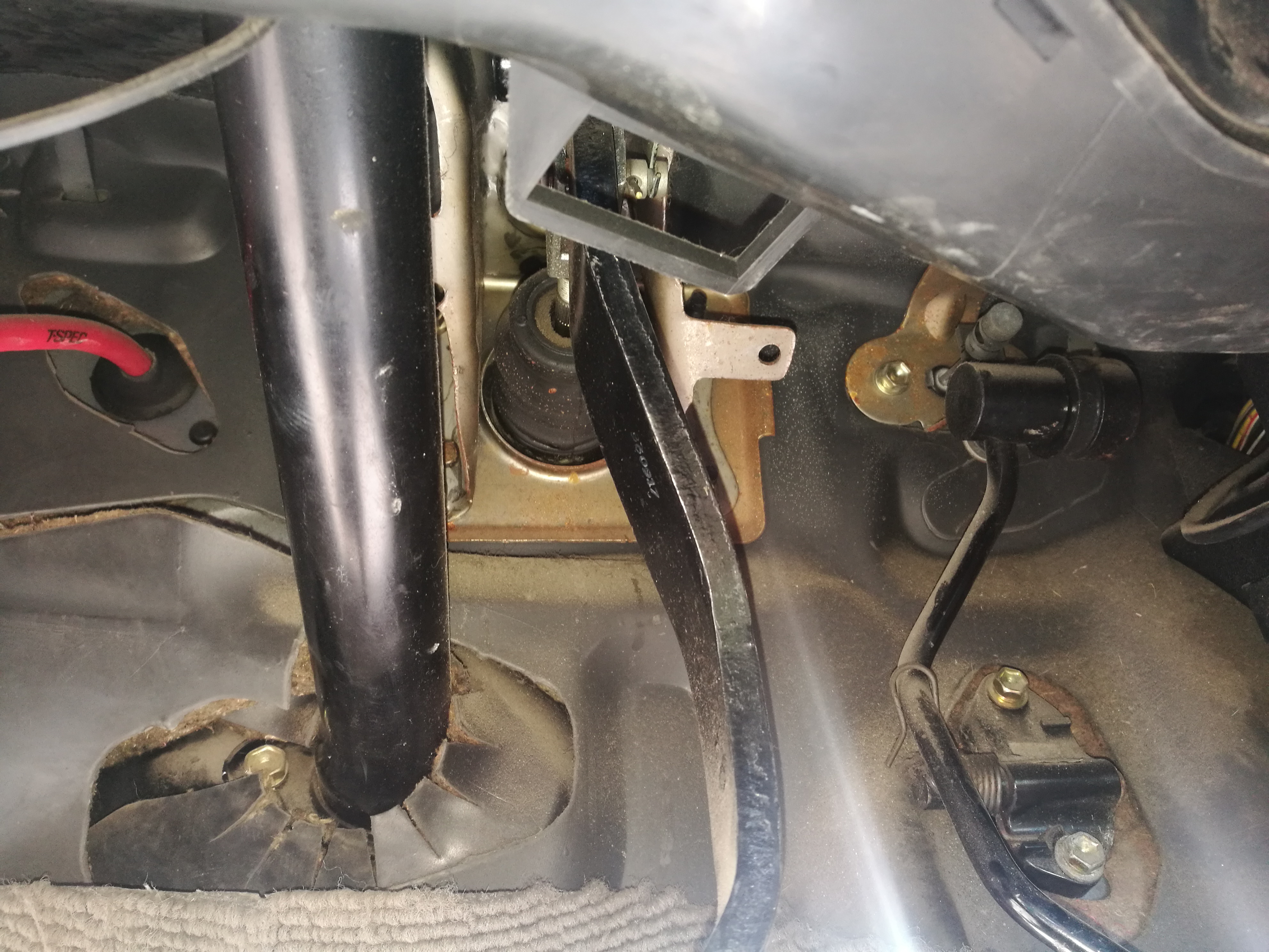

  1. I've read somewhere that the ka67 factory manual came out with the t40 sitting behind the mighty 5k, if this is correct would i have to go hydraulic clutch set up? Really want to swap this to manual as cheap as possible.
  2. Here's a picture of the current two pedal box, sorry its a bit dark. I was hoping a ke70 or even a Corona Pedal box would mount up with little modification. Kp60 definitely wouldn't work as the pedal arm for the clutch wouldn't clear the steering shaft from the wheel to the rack(unsure of what term to use here lol having a blank)
  3. Hey guys just recently brought my 1987 Ka67 AUTOMATIC Toyota Carina for a steal. Its running a 5k 3 speed automatic box and was curious to see if a k50 manual would bolt up to it? If so, what pedal box can i use to operate the clutch which was never there? I know its not a corolla, but i thought I'd give it a shot, sick of the crummy auto box already! Cheers!
  4. Has anyone got any pictures of ke70 pedal box? Heres my ka67, just trying to get a rough idea as the Starlet pedal set up sale fell through

  7. Any have any insight? Surely it would be the same as a ke70?!
  8. Could i possibly use a pedal/box out of a Starlet to match up with the cable operated k50?
  9. Hey guys just recently brought my 1987 Ka67 AUTOMATIC Toyota Carina for a steal. Its running a 5k 3 speed automatic box and was curious to see if a k50 manual would bolt up to it? If so, what pedal box can i use to operate the clutch which was never there? I know its not a corolla, but i thought I'd give it a shot, sick of the crummy auto box already! Cheers!
