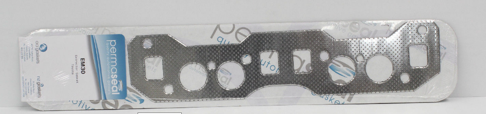

P.S.    ebay link for 1 piece composite K series manifold gaskets.
https://www.ebay.com.au/itm/1974-1978-For-Toyota-Corolla-KE30-3K-3K-H-Extractor-Manifold-Gasket-/201510257673?hash=item2eeaf28409

PERASEAL do a one piece gasket, which has the P/N EM30, available through Bursons here in Australia.
I've used them on all my Rollas, & have never had a manifold issue since.
