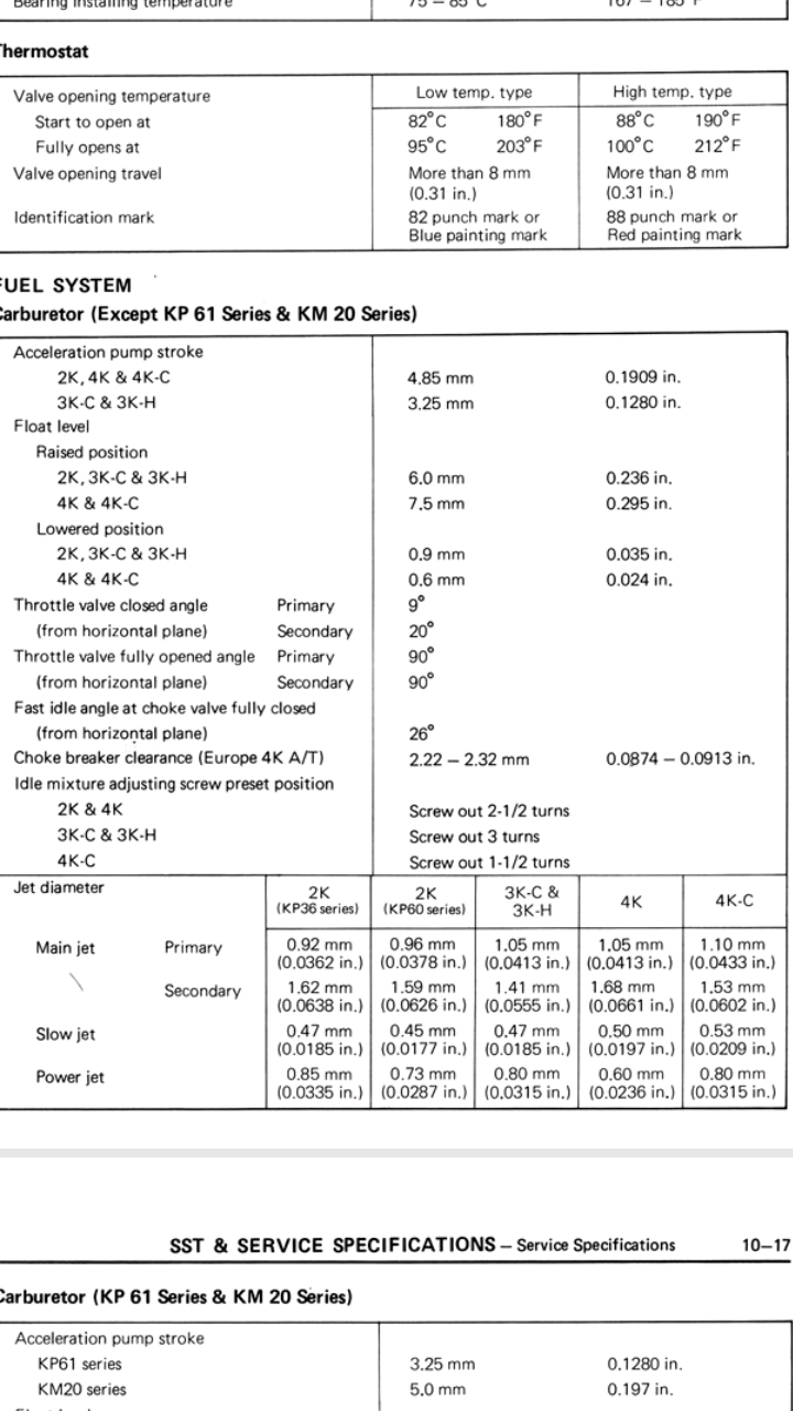

MrTougéTka Posted November 29, 2017 Author Report Share Posted November 29, 2017 On 26/11/2017 at 3:42 PM, rebuilder86 said: which carb have u got? ig its the one with a vacuum diaphragm controlled secondary throat, and the external hot idle compensator with hoses running to it, then the stock mixture setting is actually 2.25 turns. if u have this one (its most popular) and u are getting a better idle leaning it in to 1.5 turns then id say u have a spark leakage problem. I've got just the standard twin choke aisan single down draught mate, I'm a bit of a noob when it comes to all this. But I'm learning quickly. Hey is there any tips on refitting a new mechanical fuel pump? I've got the spacer , but I feel it Doesn't want to line up/slot in right when I go to install it. Quote Link to comment Share on other sites More sharing options...

MrTougéTka Posted November 29, 2017 Author Report Share Posted November 29, 2017 13 minutes ago, rebuilder86 said: yeh mate look for thommo thompson in perth picture of me holding my baby boy. as for fuel pump. i don't know i havent mucked with them. I'm all for electric pumps! as for carby, there arr 2 variants of the twin choke standard. one vacuum diaphragm operated secondary, and one suction gravity operated. need to know which u have before suggesting a factory idle mixture setting. I'm pretty sure its the gravity suction version. Because there wasn't an external vaccum diaphragm? Quote Link to comment Share on other sites More sharing options...
rebuilder86 Posted November 29, 2017 Report Share Posted November 29, 2017 ah ok great so it looks like this... in that case its the same as mine and depending on ur engine its 2.5 turns for 4k or if u wanna be lame and run it like the californians with the 4k-C haha, its 1.5 turns. see screenshot below of the manual. Quote Link to comment Share on other sites More sharing options...
